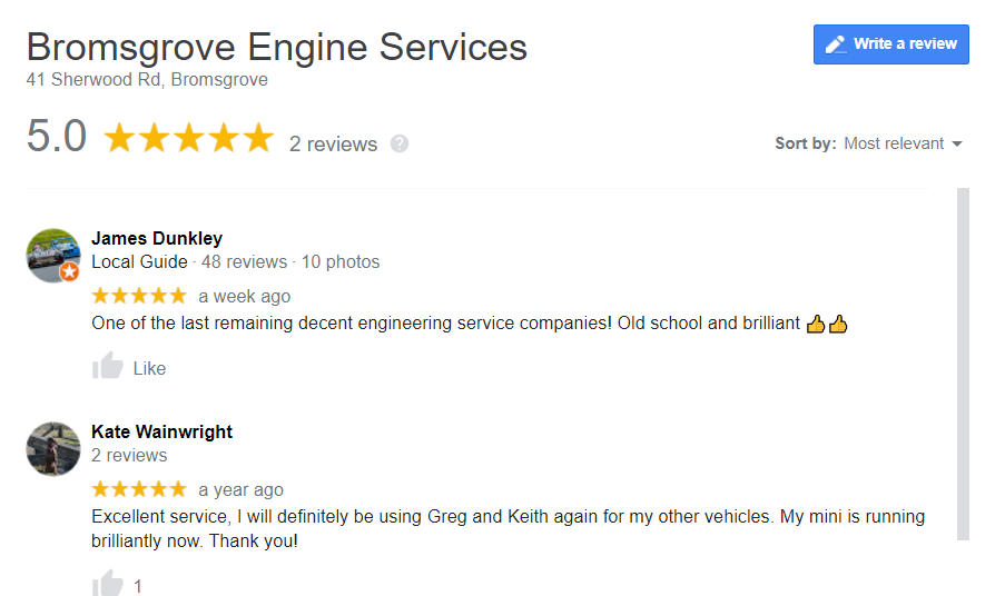

the nearest engine shop to me is Bromsgrove engine services, he reckons £70, and says he can get it back to me the next day if I drop it down in the morning. so.. going to go for it, they was on car S.O.S according to there website..
Car S.O.S. asked us to rebuild their engine for the restoration of a classic Mini Cooper.
Sounds promising... only issue is getting it there with no car.. but have to cross that bridge when I get to it

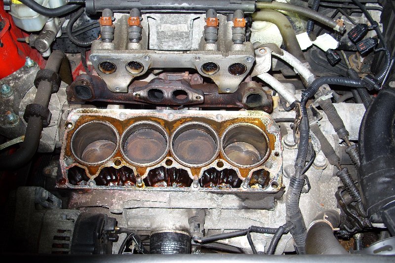

You don't need to disturb the injectors, you just remove their wiring harness. You just push the manifolds back with the injectors still fitted. You can see mine here....

I was reading through Haynes manual about the procedure and it suggests that the inlet and exhaust manifolds can be left on by disconnecting the exhaust but makes it a bit heavy and awkward to manhandle out the engine bay. Thinking about it though I think it would be easier and not much more time to just take them off.
Yeah be easier to just remove them I reckon.
