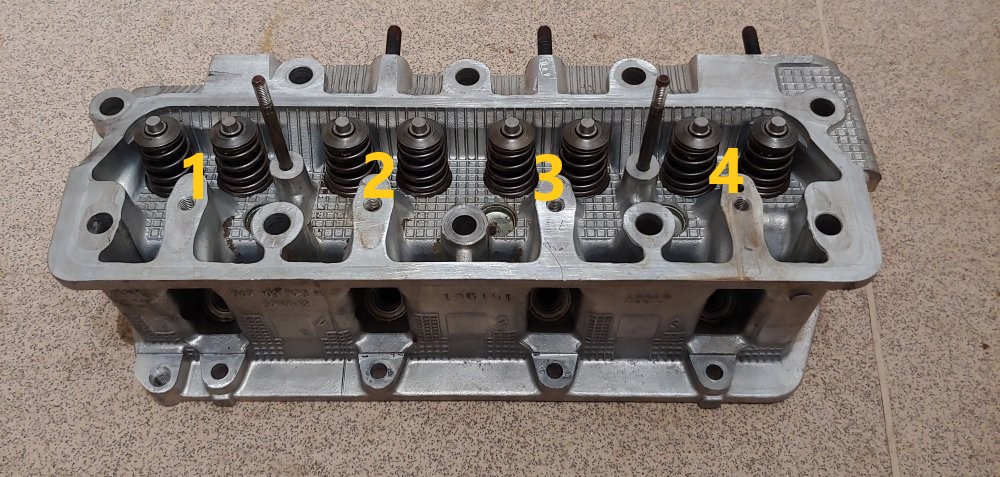

Wait 30 mins between doing each cylinder's valves and you should be good. I initially tried 90 mins but found that 30 was enough. What I did was briefly start the engine after adjusting the two valves on each cylinder to check it started OK. You can run it briefly with the rocker cover off without any problem. Oil doesn't spray everywhere.
Make sure you're doing them in the right sequence. Number 4 cylinder is where you start for the overlap and is obvioulsy the cylinder closest to the gearbox.
Overlap 4 adjust 1
Overlap 2 adjust 3
Overlap 1 adjust 4
Overlap 3 adjust 2
20201210-164654-HDR-thumb-jpg-9037f1d586
