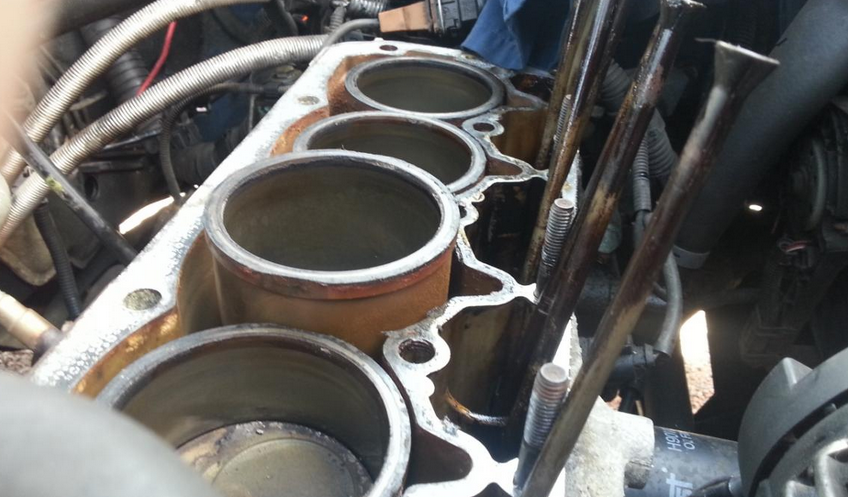

Once you have the head off be careful not to turn the engine as it can dislodge the cylinder liners. I didn't find the need to turn mine but if you do you are supposed to use bolts to clamp the liners down.
Nasty....
