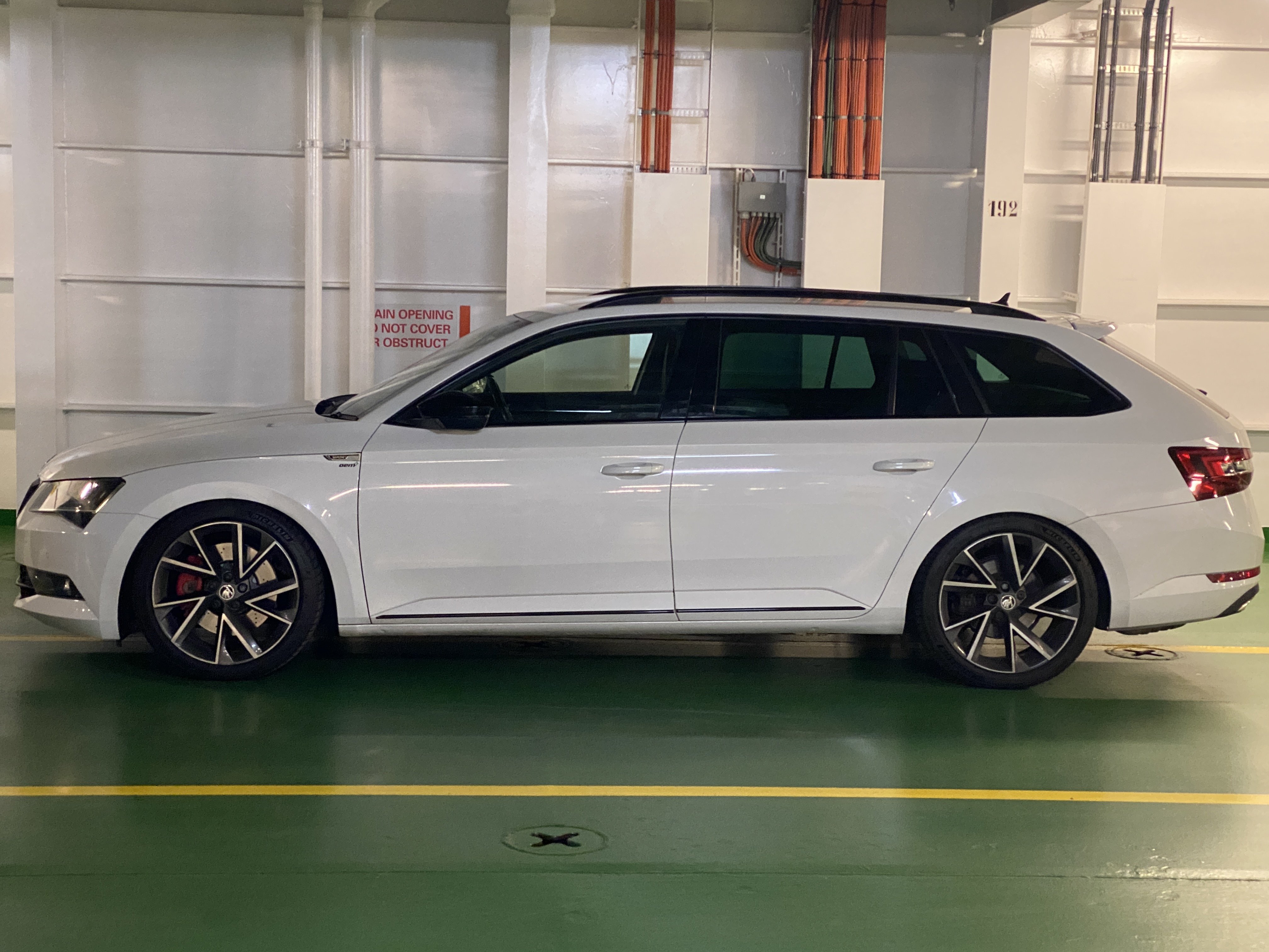

7 hours ago, Gabrielem said:
Can you post a photo of the result? Thanks.
Koni special actives with H&R on.. car sold now but have retained the koni is so will be fitting them to the new 272
I do however have a set of H&R springs for sale for a 4wd diesel estate if you want them
