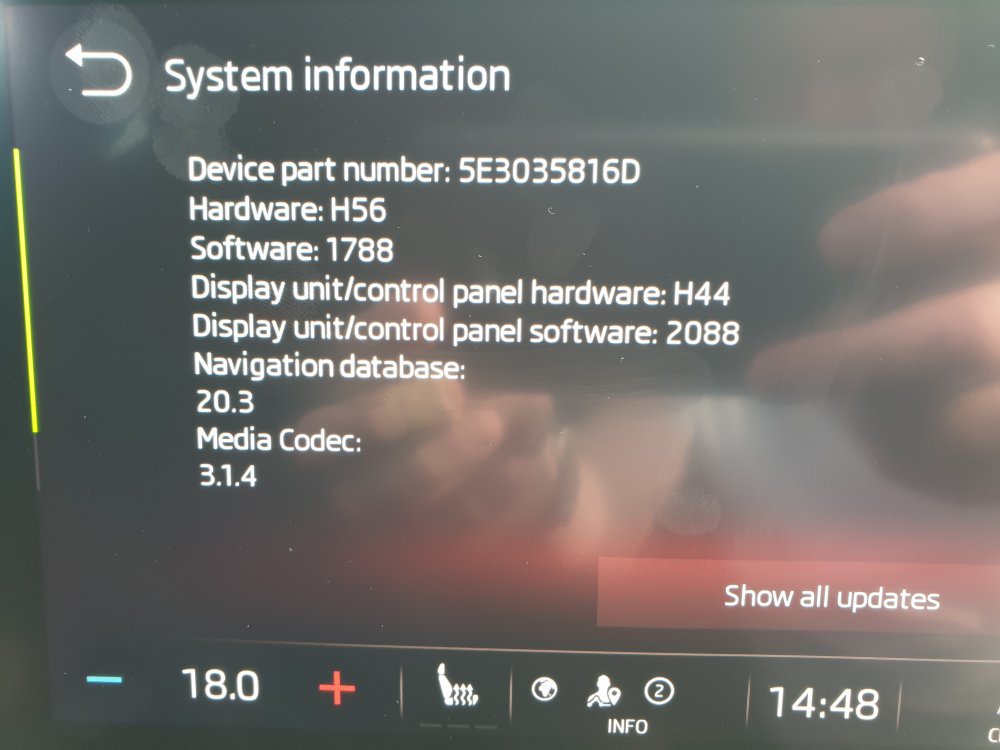

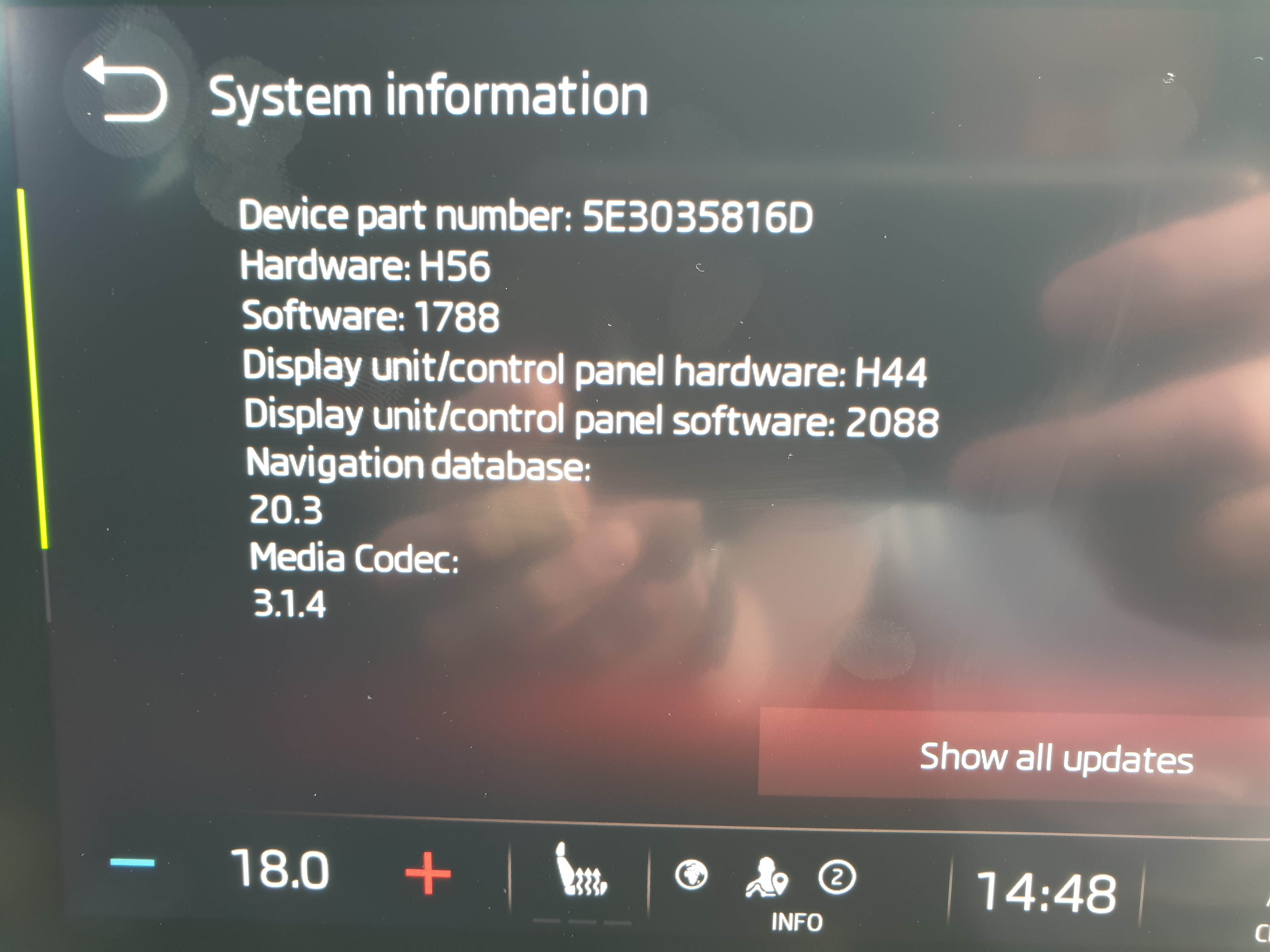

Just had my VRS delivered today, happy to say wireless android auto works fine so far. Build date is 3rd Dec, part number is 5e3035816d hardware h56 software 1788. Phone is Samsung galaxy s9 on android 10. I'll update if I get any issues with it

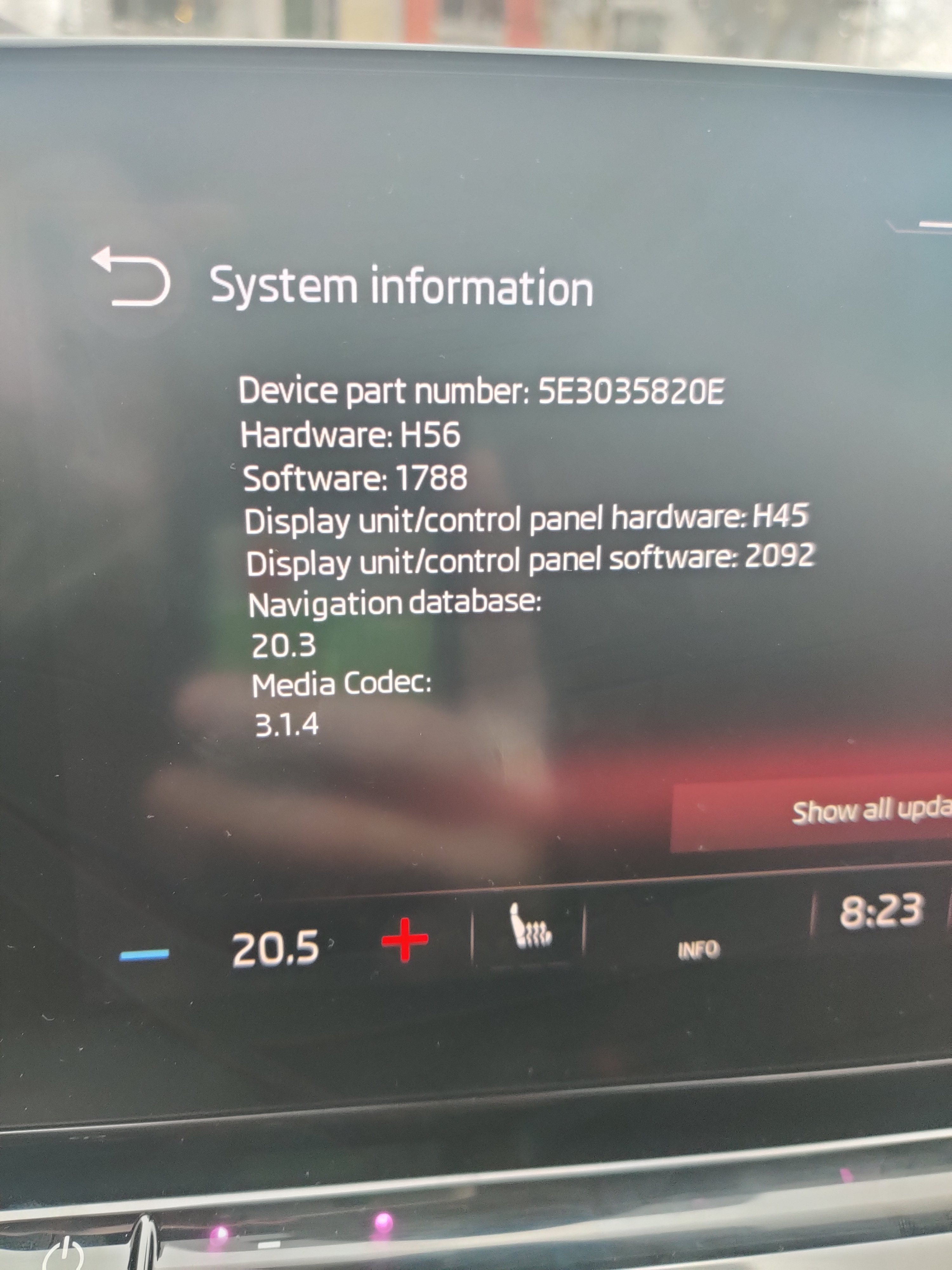

Sorry for not answering you right away. But if you are still willing to check your SW-version, you can do that in "Settings > System informations".
Mine looks like this (in Danish):
I think we already found out that on cars with device part numbers ending with A to C, wireless Android auto doesn't work. And from D onward it works. @janis can confirm. If he will be able to find the sys information. :D ;)
That is my understanding too - unfortunately......
i will check tomorrow, i saw this screen but cant remember details.

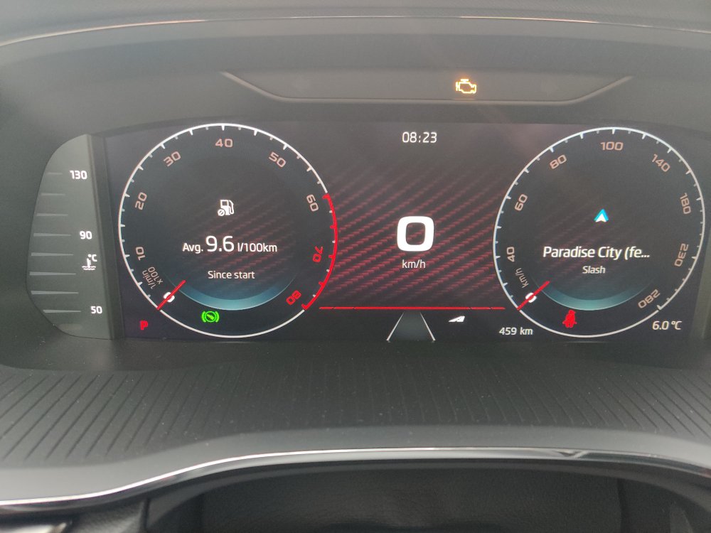

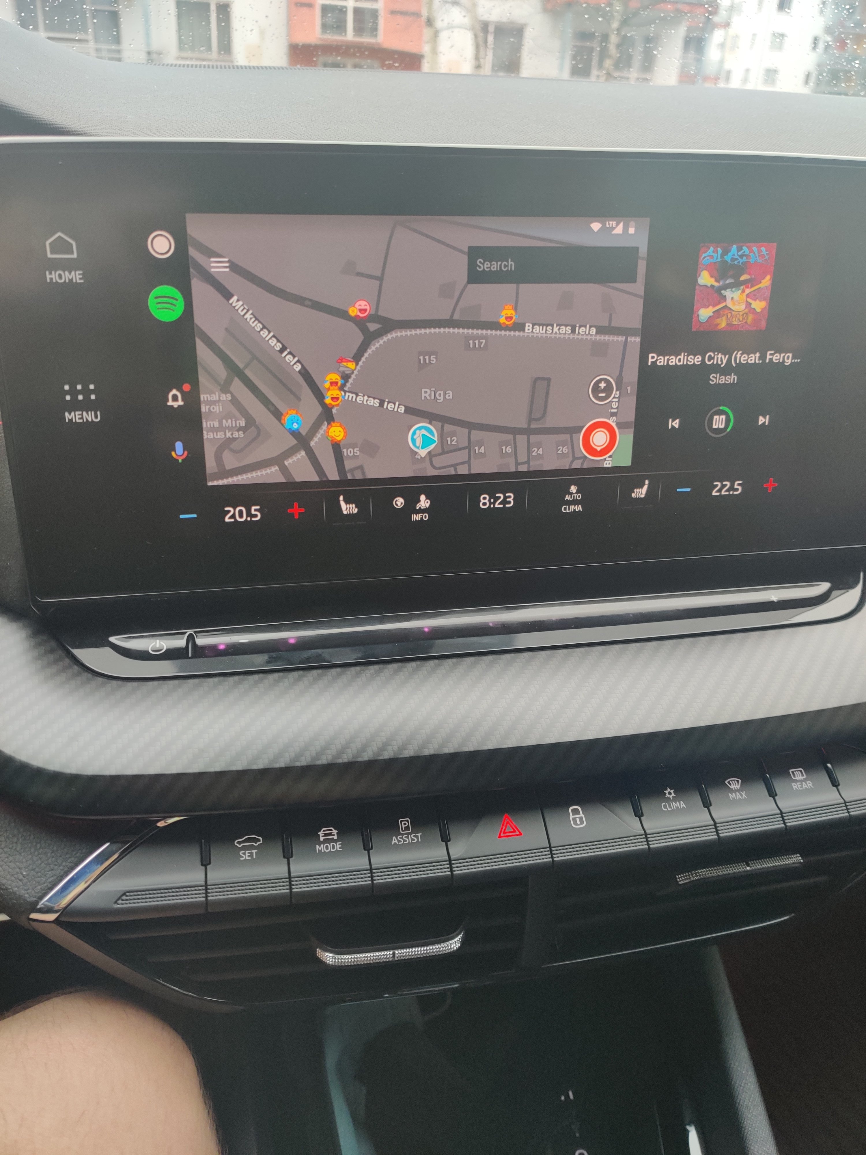

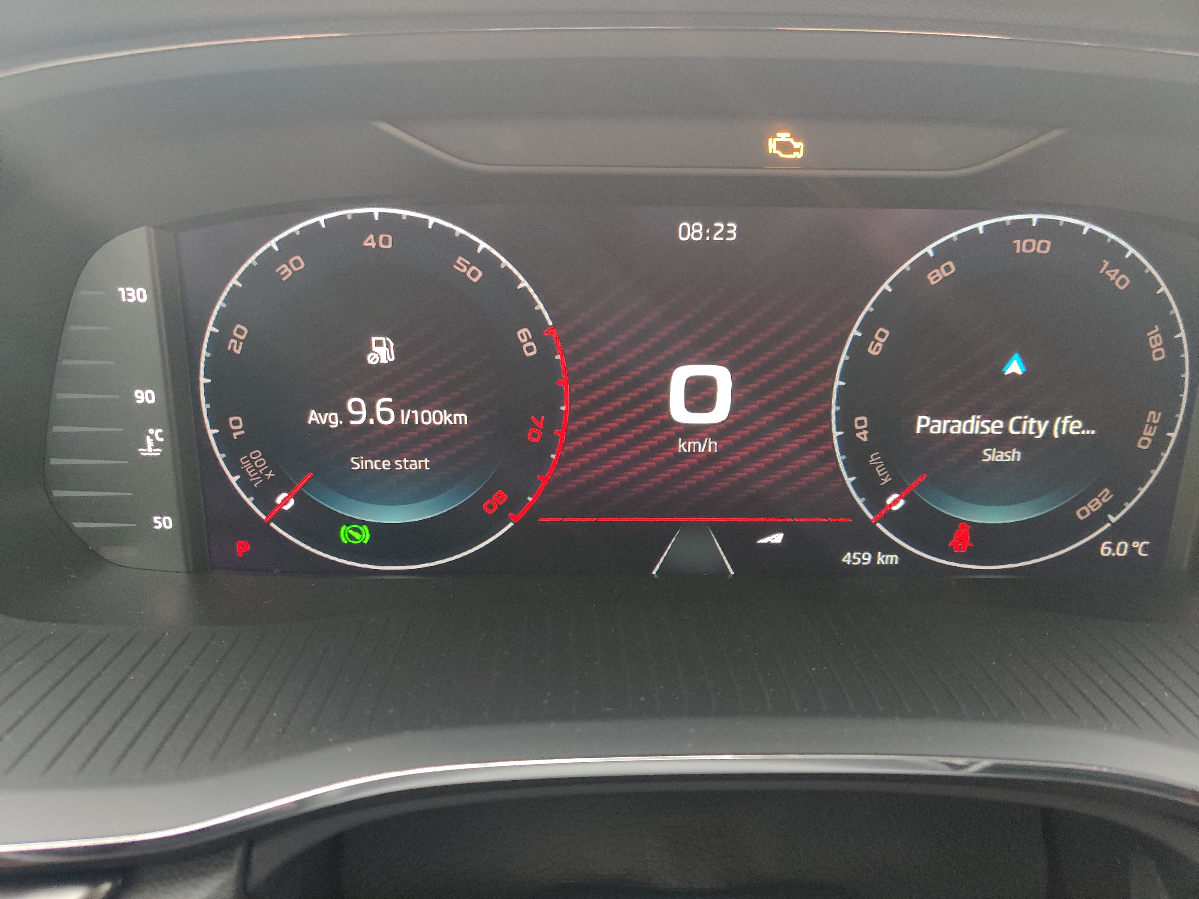

here my soft version and proof that it does work, takes like 20 sec or less to connect once i get in
@janis: Thank you for showing us. And congratulations - your unit has a device part number that ends on E. For those of us unfortunate enough to have an earlier version (C or below), it doesn't work.
