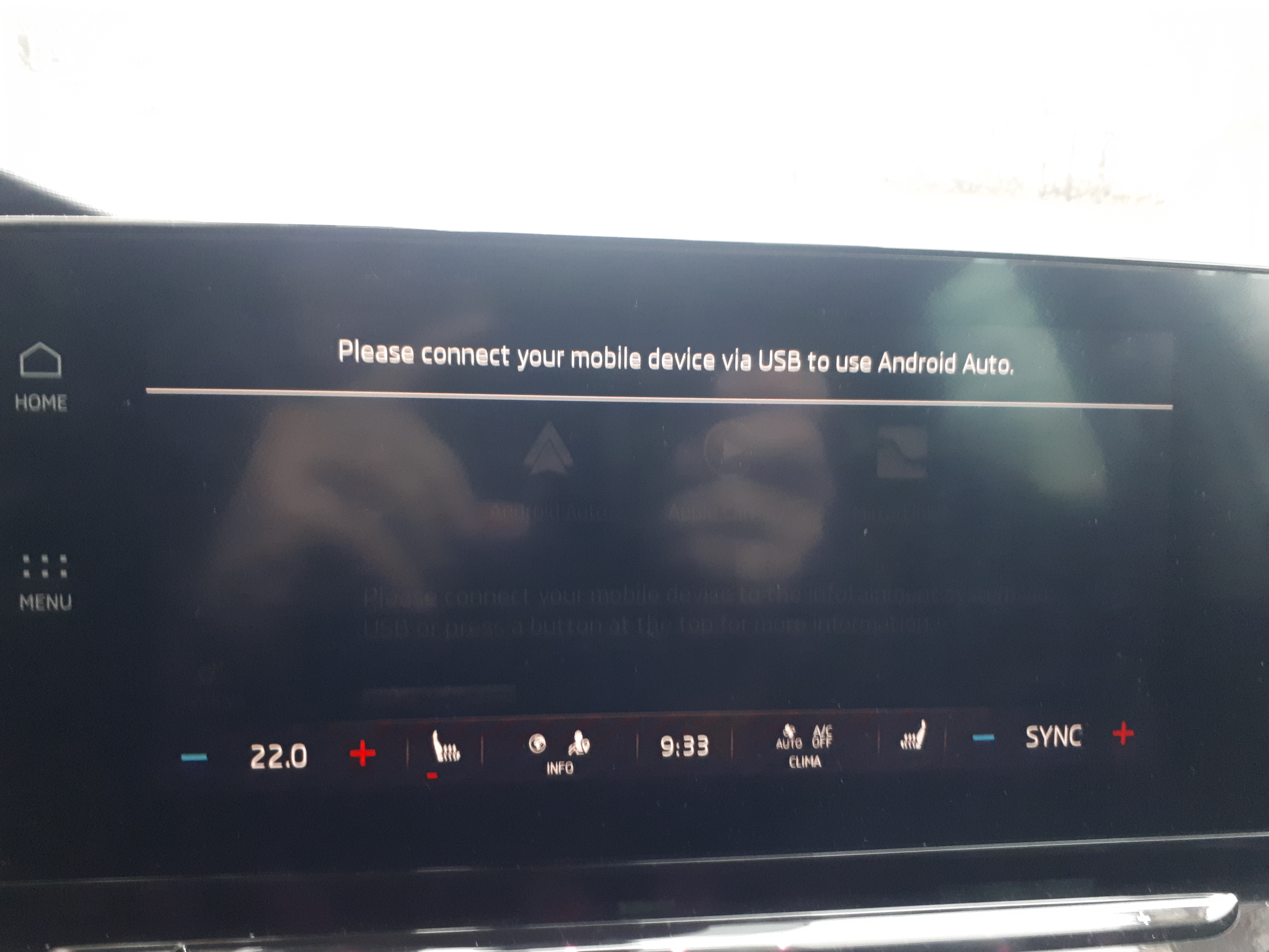

Is it possible for someone to take a photo of the screen that comes up when you choose Android auto for the connection? For me it says that a cable connection is required. Do you guys have such notification?

Here is what is showing on my Octavia's screen when I tap Android auto.

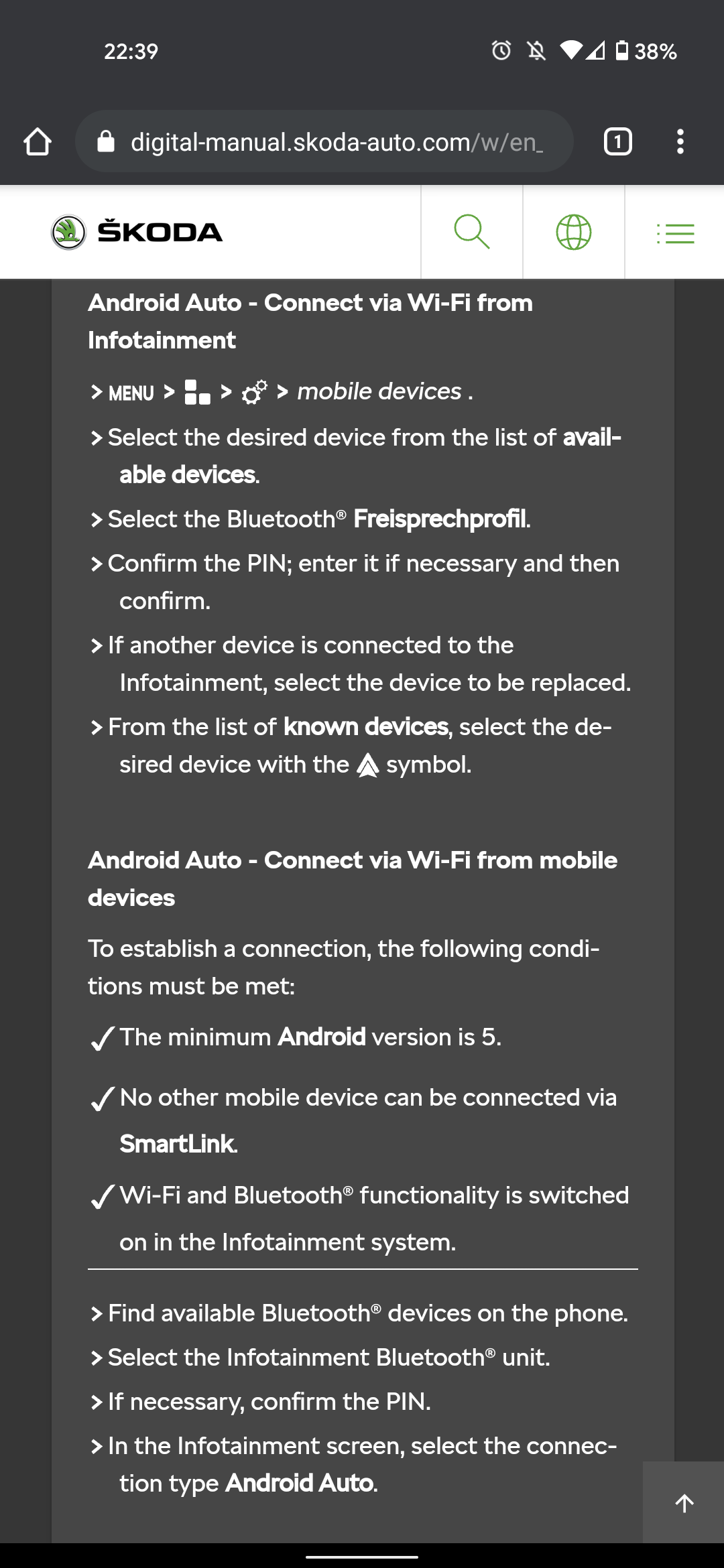

I read the manual and, to make things weirder, it says that connecting Android auto wirelessly works on Android version 5 and above.

I get exactly the same. Works fine when connected through the usb-c port but this is exactly what I get when trying to run wireless. Strange that it connects to the phone through Bluetooth okay but not android auto.
I'd find that very surprising indeed. On what page of the manual does it say this?
The requirements of wireless Android Auto have been pointed out several times on this forum, that statement in whatever manual you're referring to is completley inaccurate. Are you sure you've read it correctly?

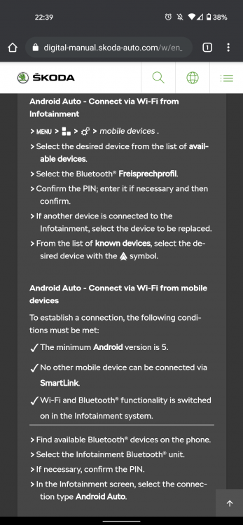

The only thing I've found in the manual is this:
So I'll just take a guess here and say that it likely doesn't work for anybody. Maybe some select phones, like some Samsung models, but definitely not for every other compatible android phone.

20 minutes ago, RRovan said:
Exact same on mine.  So I'll just take a guess here...
There's no need to guess. That copy of the manual you've posted says the minimum version for Android Auto is version 5.  It does NOT say the minimum version for Android Auto Wireless is 5.
