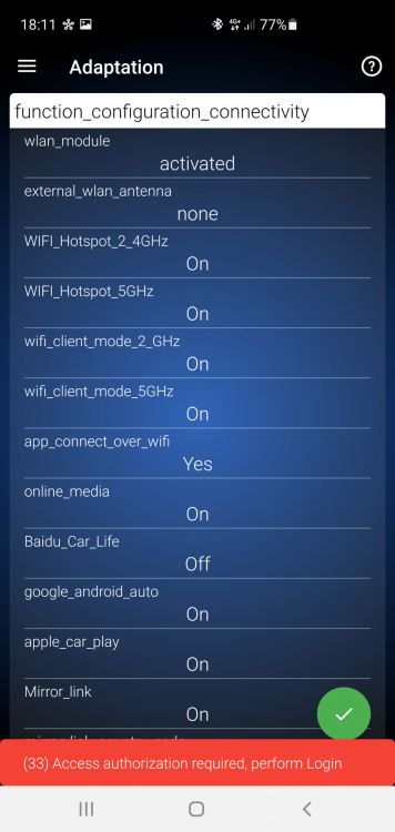

Hello guys! And girls of course :)
I found this forum when I was searching for a solution for the same indentical problem - make Android Auto wireless to work on my new Seat 2020.
Yes, you read it right, I have a Seat Ateca 2020, not a Škoda :)
We have a little differenet Infotaiment part/serial number, but I think that A, B, R or Z is not important. Also on Skoda.

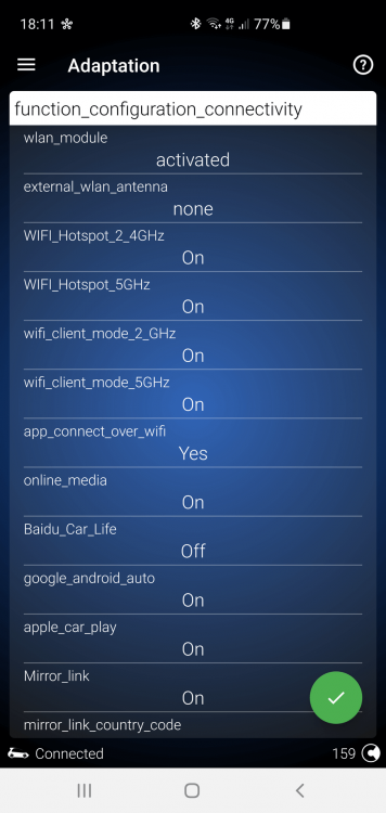

I found a solution for me and I'm sure that it will work on your Škodas too.
Our cars have some settings that prevent Anrdoid auto wireless to work. I don't know why exactly why they set it that way.
So... to the solution that worked for me.
A changed this four settings with ODBeleven and when I re-added my phote to the Infotaiment, Android Auto wireless magically started to work like it should work already from the beginning.
Please see the attached files - before and after.
This settings are located in: Control Units ---> Module 5F (Multimedia) --> Adaptation --> function_configuration_connectivity.
I hope that this will work also on your "old version" Škodas ;)

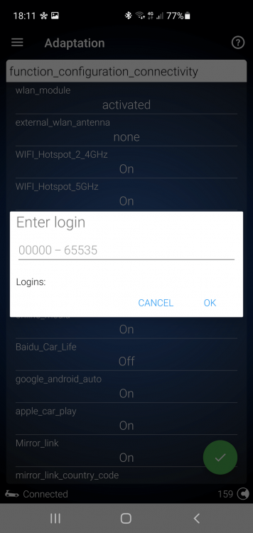

That's great, but when I tried this on my MK4 vRS (5 month old) it requested the login code...?
I forgot the pictures:
Interesting. There was no code for me.
Maybe someone on this forum knows these codes.
Allready tried it, doesn't work for our octavia's
And you'll need an online SFD login to write these changes

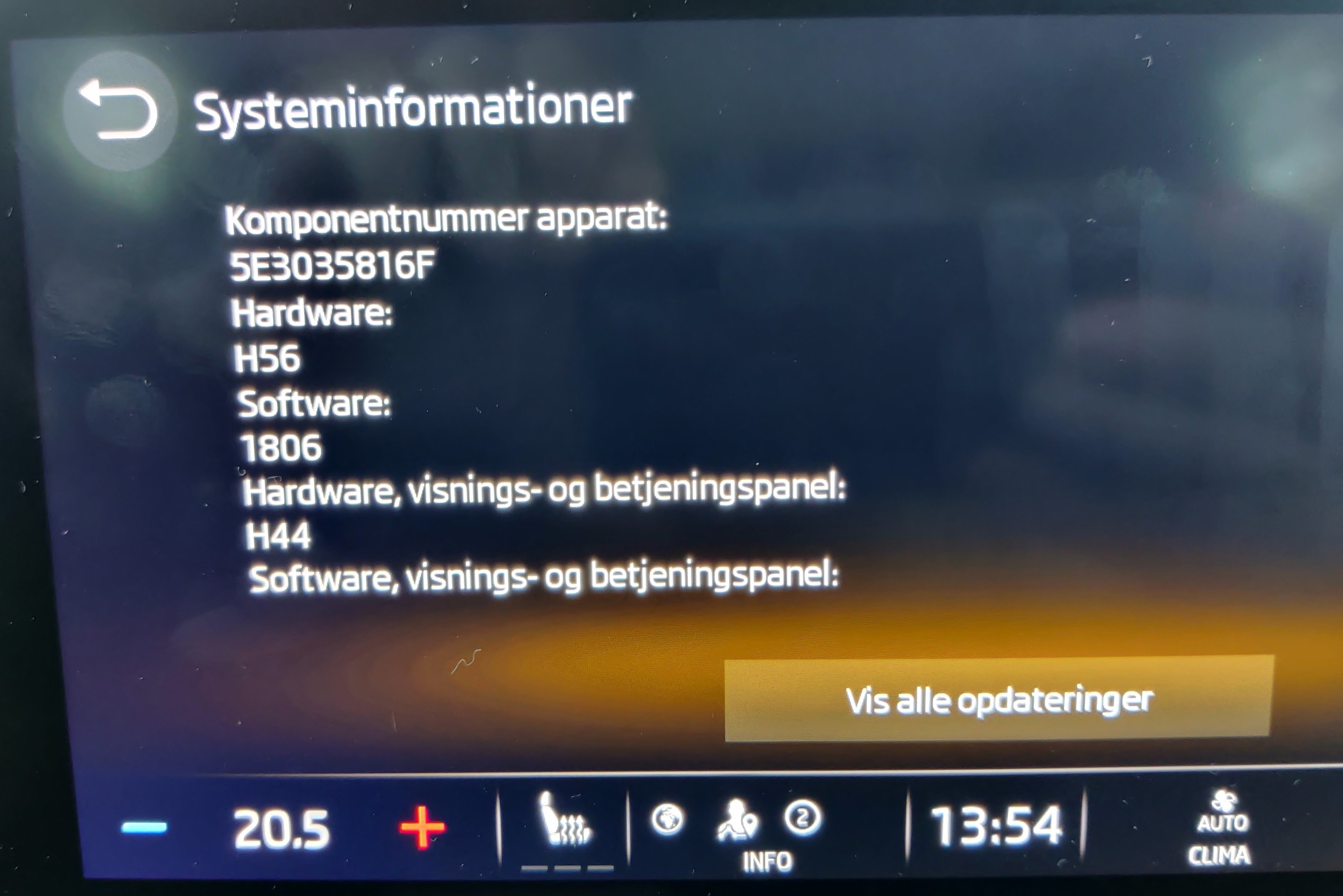

Good news! Last monday I had my Octavia iV infotainment updated. The main reason was to get the mediaplayer to work. I haven't been able to play MP3 files since I bought the car ½ a year ago. The update solved that - hurrah.
Then, a few days ago, when I picked up my unplugged phone in order to leave the car, it dawned on me, that I had actually had Spotify playing. And yes: AA was now working wirelessly, and had simply connected itself, without me even noticing 🙂
I have an early unit, which originally came with a version B device number. Consequently, I had abandoned any hope, that it could be updated to wireless AA. But now its version F - proving that the lack of wireless AA on early models is not a hardware related thing, but can be solved by software.
These are the details of the update:IMG_20211029_135449.thumb.jpg.873ac3ca744c68af7f981006f306dd26.jpg
Once my car had been in for the software update android auto connected by Wi-Fi immediately. My car is a 2020 1.5 TSI. Prior to the update I had to connect with a cable.

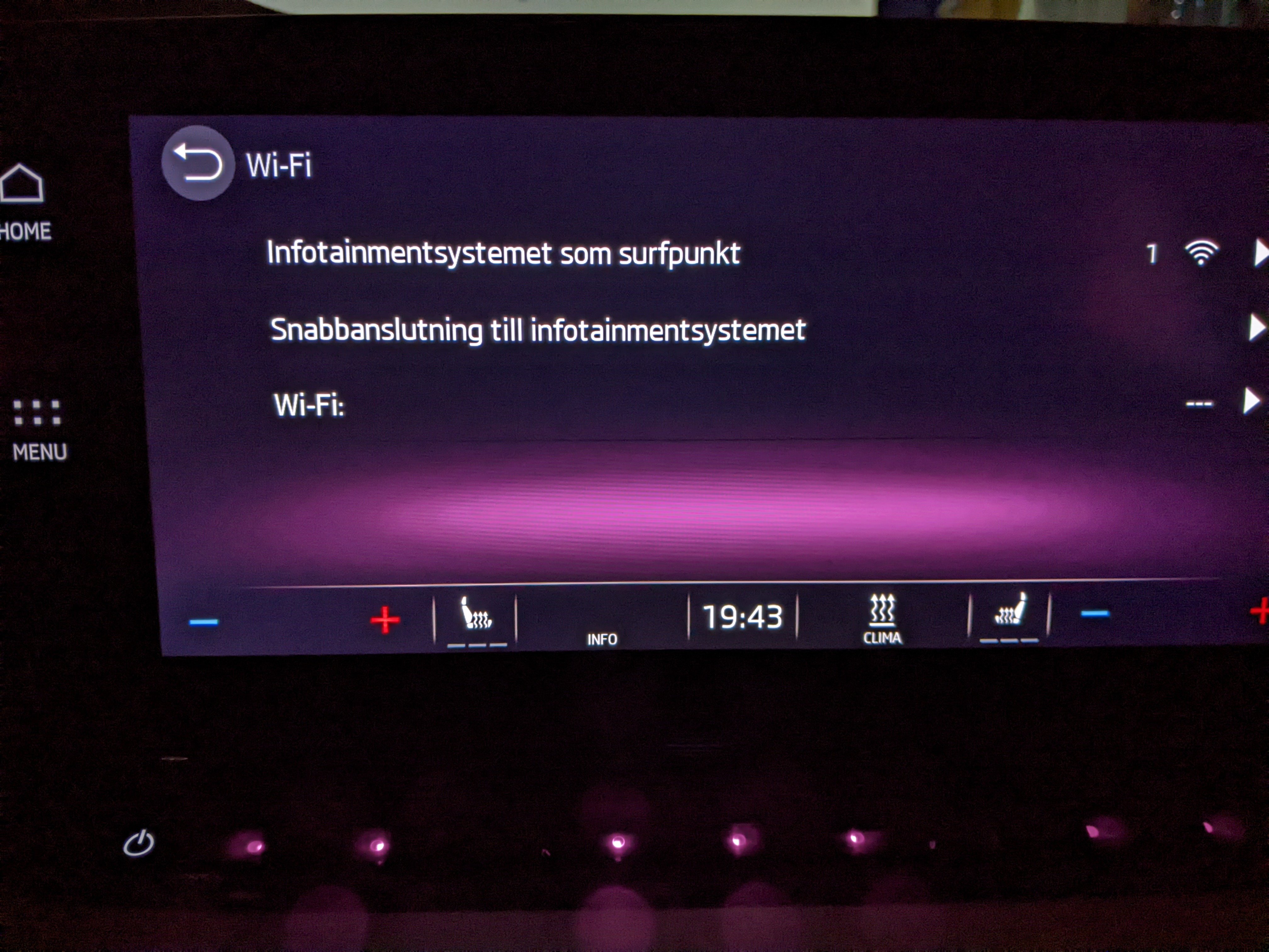

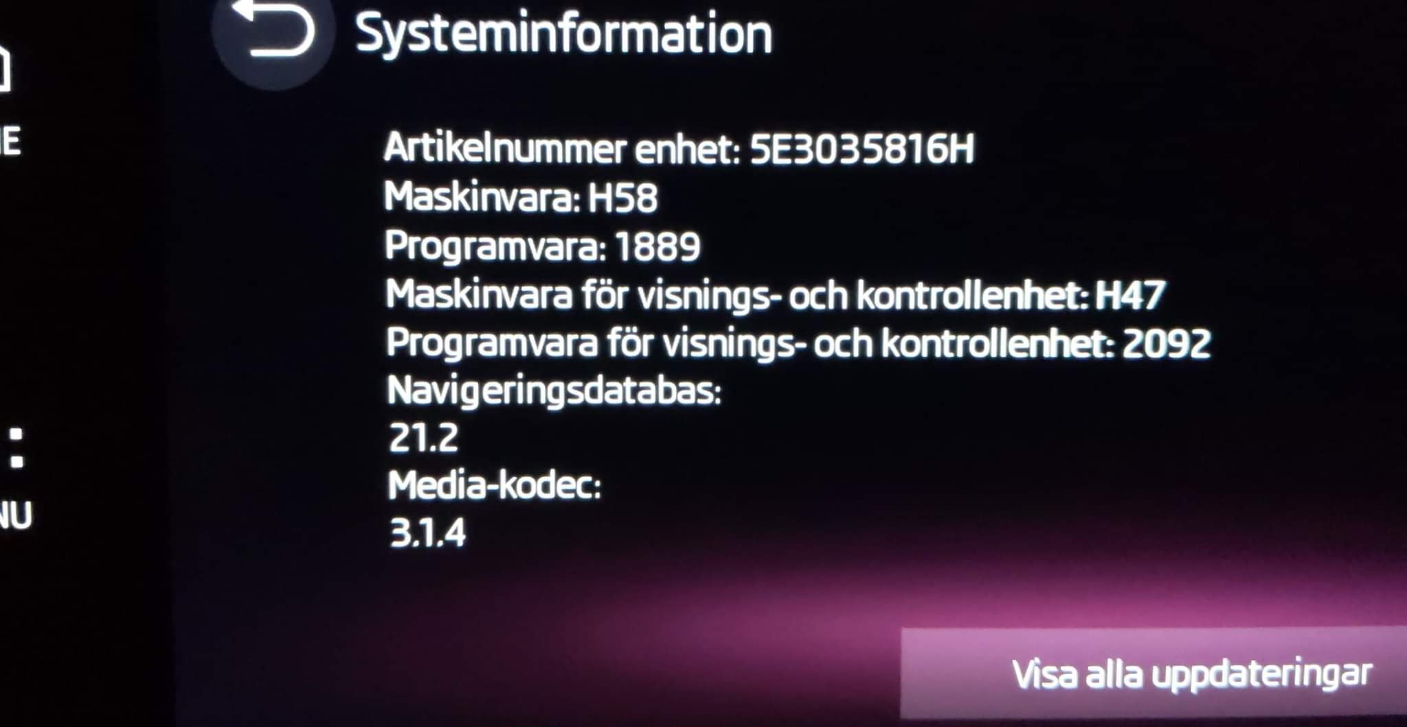

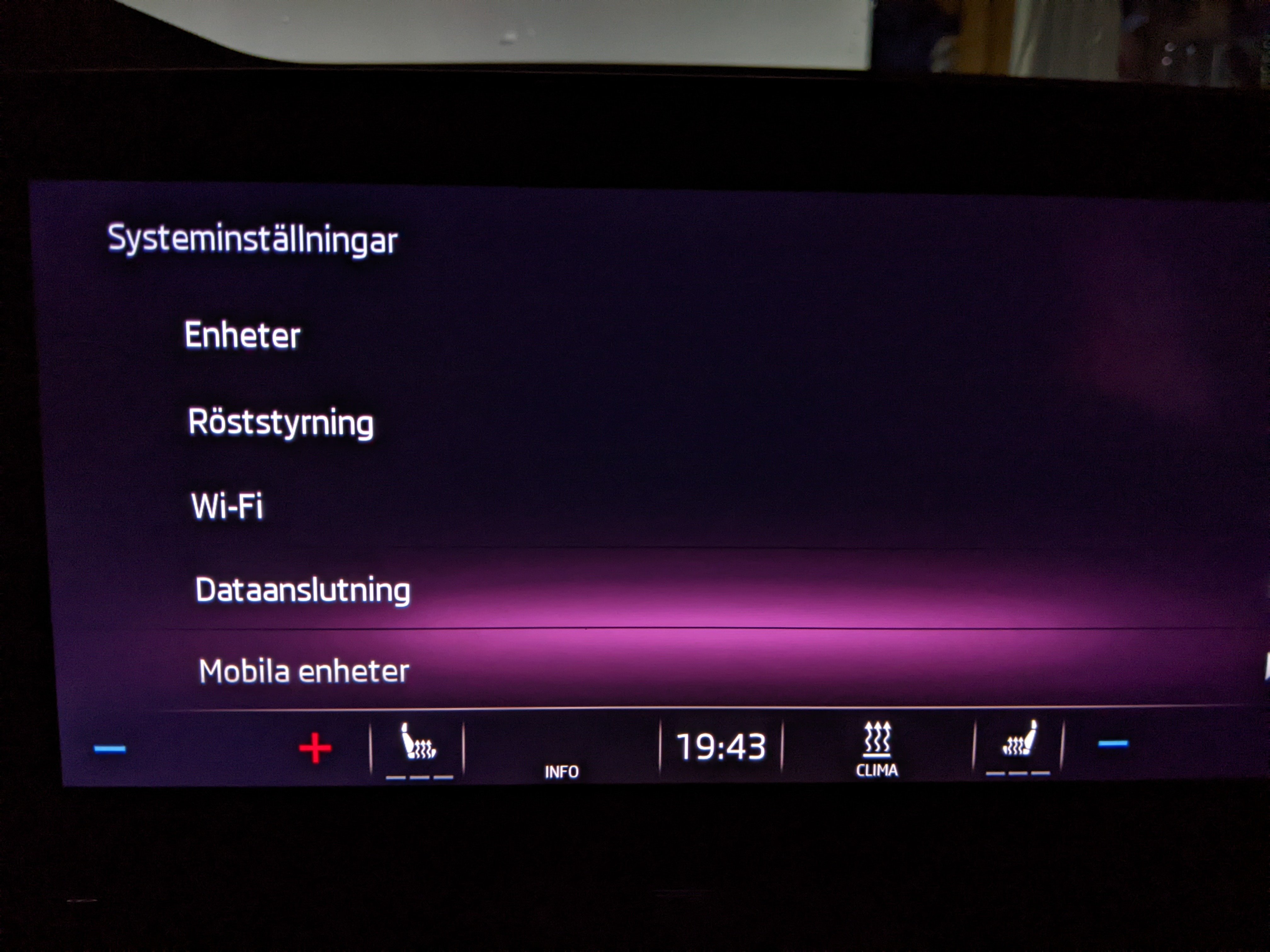

✅ My dealer fixed this!
I was missing the WiFi setting in my infotainment system. After a visit to my Skoda dealer they managed to get it working. I can now see the WiFi setting in my infotainment system and Android Auto Wireless started working automatically.
Car: 2022 Skoda Octavia e-TEC
Phone: Google Pixel 3a, Android 12
Infotainment: Bolero
(The image with the versions is before the dealer fixed it, so there might be a chance that the system got updated.)
Thanks to all other posts in this thread leading me up to this conclusion. If you also is missing the WiFi setting, contact your dealer, this can be fixed!

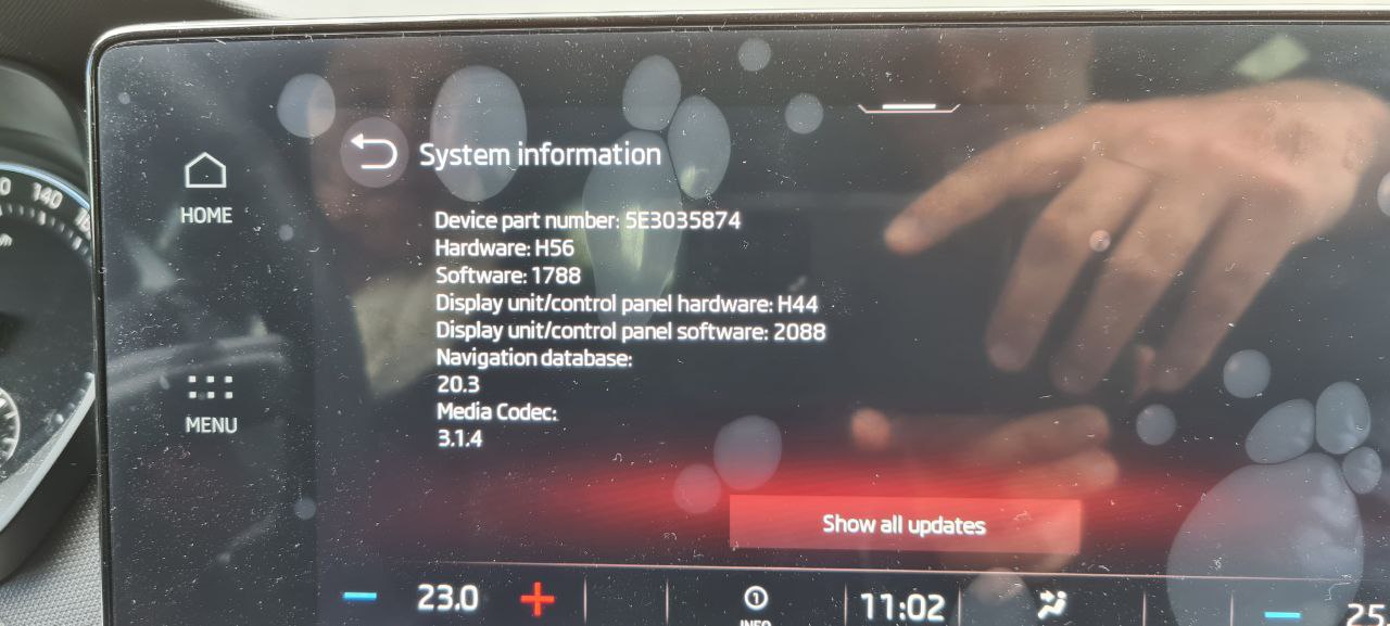

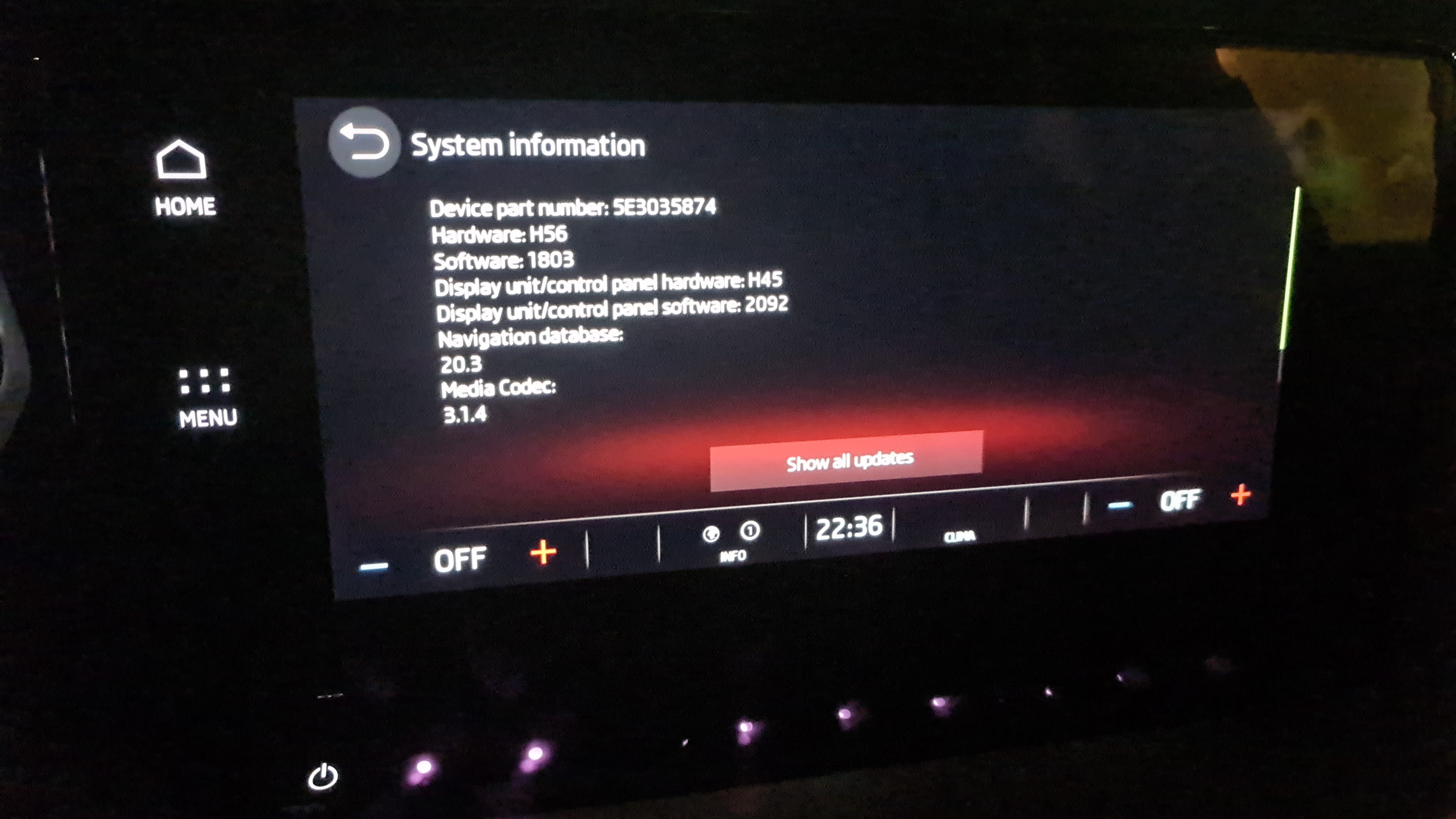

After a major update it still asks for USB connection...
Might be idea to add version infomation of your software (picture?)
Here it is:
@Matt_130 Indeed it does seem weird then to keep asking for USB, from my understanding wireless android auto should be added/functional.
Bugs upon bugs, or it's something about phone blocking perhaps.
I deleted all data from AA to see what happens but it still doesn't work.
