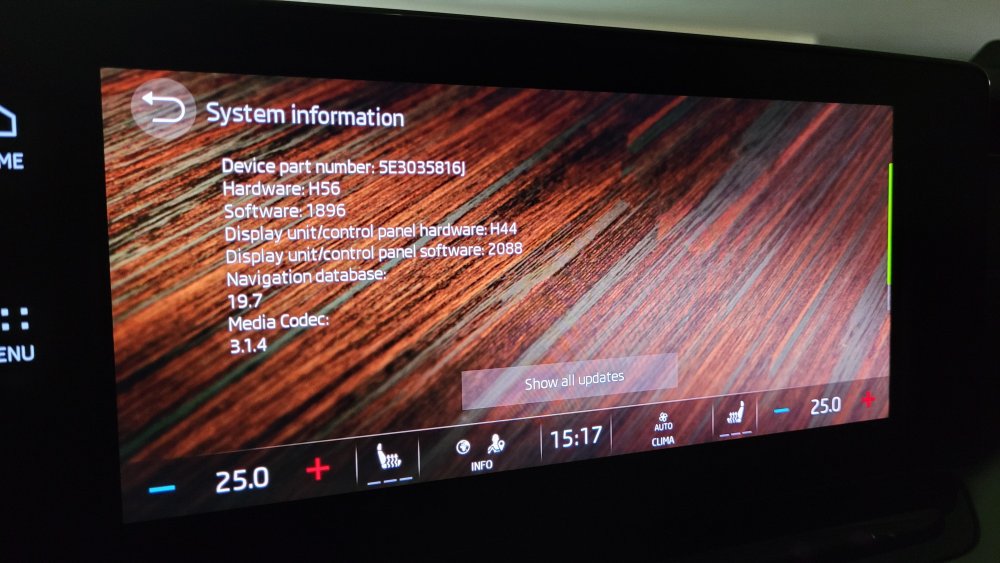

Ok this is the last thing that I can't get to work on my vrs. It's not the end of the world, but it's bugging me that I can't get the wireless aa to work.
I have 1896 software. I have Android 13 on a pixel 6. I never get there option to switch to a wireless connection.
Is there anything silly I could be missing? I've tried forgetting phone and reconnecting.

Good news! Last monday I had my Octavia iV infotainment updated. The main reason was to get the mediaplayer to work. I haven't been able to play MP3 files since I bought the car ½ a year ago. The update solved that - hurrah.
Then, a few days ago, when I picked up my unplugged phone in order to leave the car, it dawned on me, that I had actually had Spotify playing. And yes: AA was now working wirelessly, and had simply connected itself, without me even noticing 🙂
I have an early unit, which originally came with a version B device number. Consequently, I had abandoned any hope, that it could be updated to wireless AA. But now its version F - proving that the lack of wireless AA on early models is not a hardware related thing, but can be solved by software.

I've 1896 software and using a Pixel 4. When collecting the car, I connected it via Bluetooth, then by USB cable. I went into smartlink (I think thats what it was called) and followed the instructions for Android Auto setup. Switched off the car and since then, I've had wireless Android Auto.

Thanks. I think mine must be switched off in the manufacturer settings, I have read on the seat forums that some mib3 units have it set to usb only (even on latest software). Of course, the local dealer won't have a clue how you change it 😀

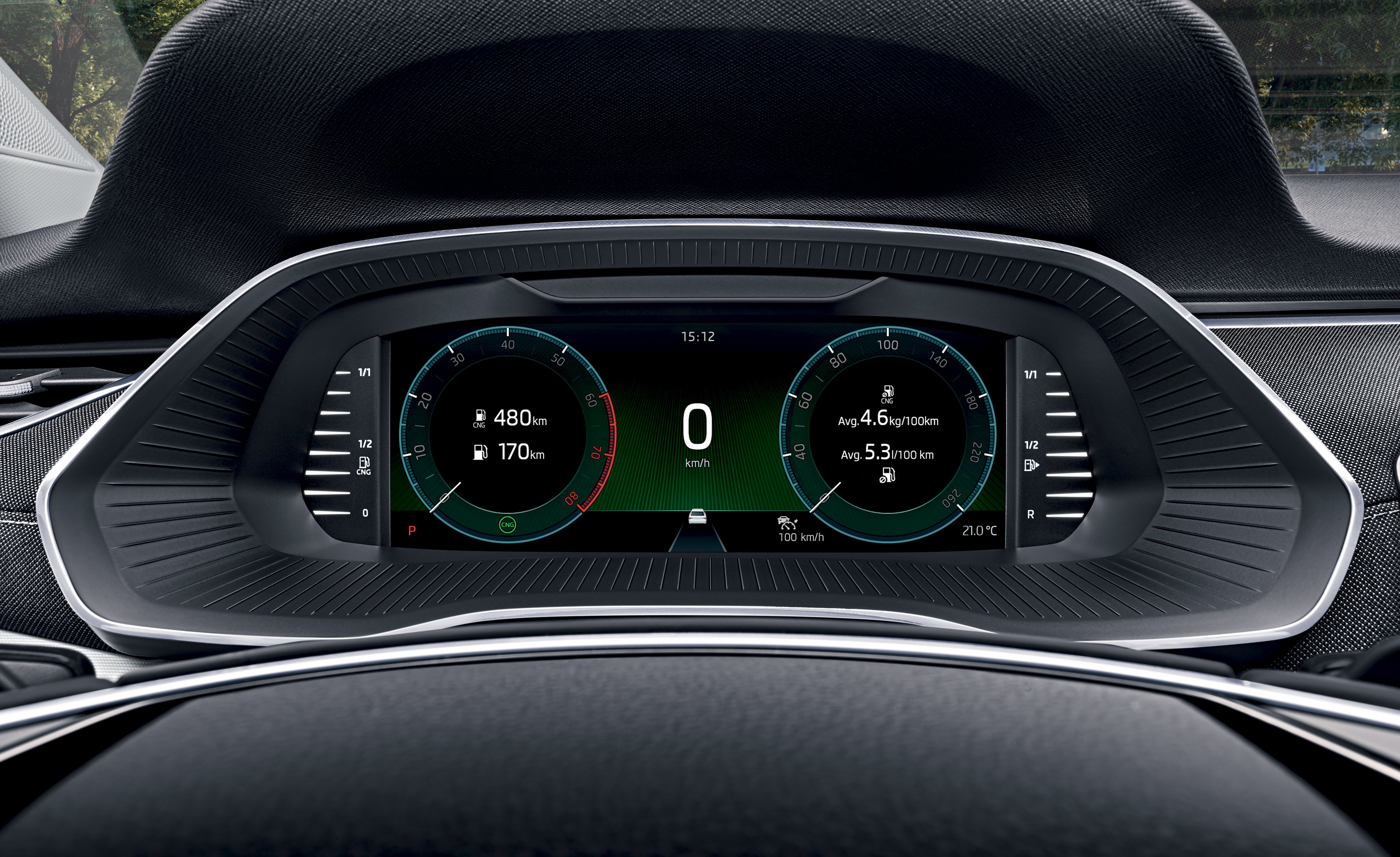

This weekend I noticed for the first time directions from Waze showing up on the dashboard - the center-up position, where the clock is usually shown. However, what's extremely annoying is the fact that those directions come and go. Once they are shown, they will stay on the dashboard for the rest of the trip. But if you stop for a gas station or whatever other reason and you leave you car, AA disconnects and it reconnects when you return inside the car. The new AA connection might now show Waze directions on the dashboard. The statistics I have so far show a 50-50% probability. And that's for this weekend only; I never saw the Waze directions before, and I use Waze all the time.
Any ideas???
@SkOmk4, if you are setting one of your gauges to Routes you should be having them permanently, no matter if you stop the car and restart it.
Popping them up is not consistent at all from what I have seen and I am.not sute if this happens on Iphones as well.
Now, it depends if you are willing losing the informatiom from the center of a gauge for the instructions of your route.

That's the nice thing about it: you don't loose any of the Info inside the two gauges (or the left&right sides - for those using the other virtual dashboards). The driving directions are displayed on the center-top side of the dash, where you normally have the clock showing. I don't have a problem to loose the click against those detailed Waze-directions. I'll upload a picture when I get the opportunity; this weekend I wasn't lucky enough to have it displayed - I was stuck with the clock HH:MM.
The one attached is found online - only to show what's the region I'm referring to - the clock display; Waze directions use an impressively large area, much more than the clock size!
You can see the indications in the upper area if you are having route set in one of the gauges, destination set in Waze, and you are attempting to change the information from the gauge which has the navigation indications set.
But it doesn't become permanent.
That's the strange story... Each time it happened (only last weekend) I never touched the "content" of the gauges. I decided a while ago on what I keep in there as info, and I rarely scroll through those info. As a matter of fact, I don't even have "navi directions" activated in any of the left or right gauges.
On one occasion last weekend, I was trying to force the central display to show me waze-directions, because I was already almost convinced it was randomly working. I was on cable connection (wireless charging giving me less power than the consumption of wireless AA), I had those directions shown for more than 30 minutes and I stopped at a gas station. When I restarted I had the clock on display, so I tried to restart the AA connection. I tried from the car's MIB, but it didn't help. So I went on the Phone into Settings -> Apps -> AndroidAuto -> ForceStop. After that disconnected and reconnected the cable on the phone, AA started with Waze still keeping the old destination I previously set. The instant it restarted I had the waze directions on the dashboard (replacing the HH:MM) for a couple of seconds - not more that 5 - and then it came back to clock display...
