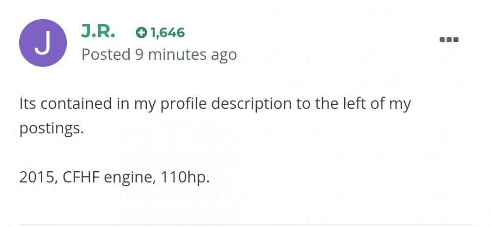

It doesn't show any info on my browser?
The CFHF engine looks to be the previous generation of CR TDI. If that's the case then it doesn't have the sleeved pump.
