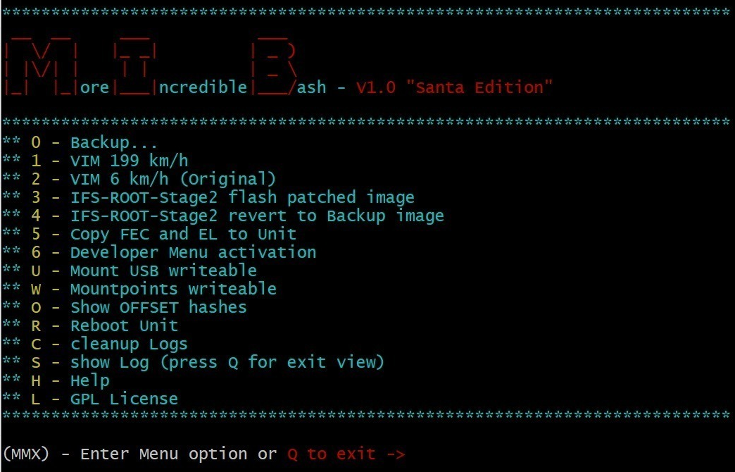

Activation VIM/MIM, CP off, GEM, AA, Mirolink, Carplay, Performance display for MIB2 high

you don't need the d-link - you can patch ifs root and install mib toolbox directly from sd card with latest mib toolbox, enable developer mode in module 5f using vcds, and get to it via green screen developer menu.
