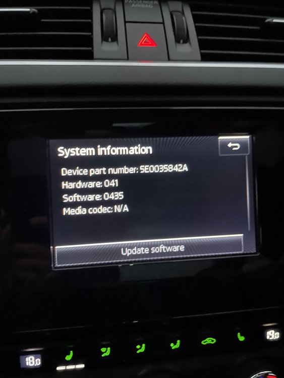

I’ve attached an image containing the details of the software we have now. From my reading, I believe there is a 0490 update available? Having the Canton system and from my reading it appears this latest update may help improve the sound quality somewhat? I’d really appreciate the help of any forum members that may be able to support please. I’ve seen the kind member @BATVANVRS helping others and it would be lovely if you could offer some help at all.

  • Guys you must post your system model number and SW version first...

Link sent in PM
Thank you very much for your help. File downloading now!

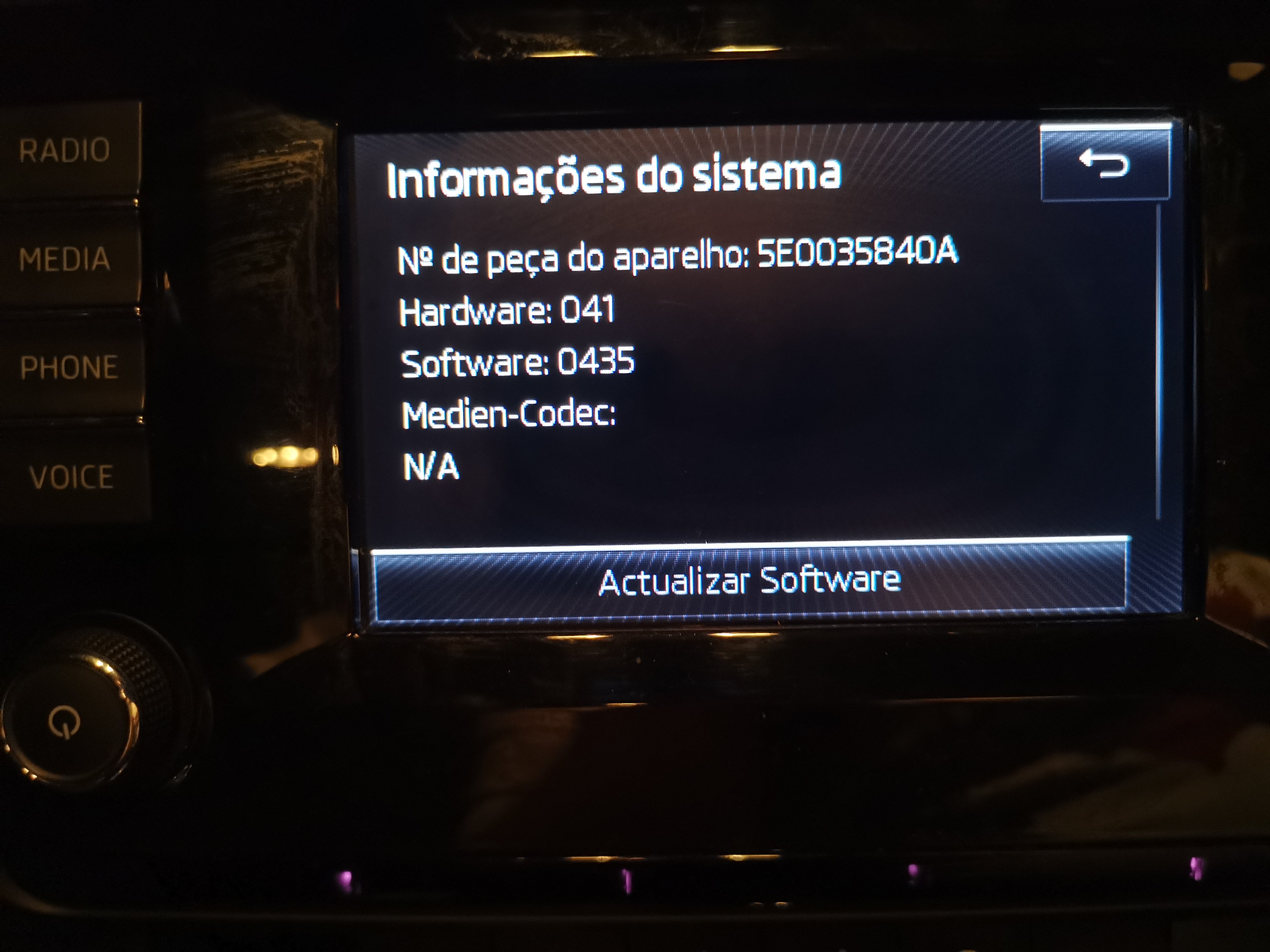

@pab567 I am very sorry i forgot to post these information.
Anyway I got them
Device part number: 5E0035840A
Hardware: 040
Software: 0435

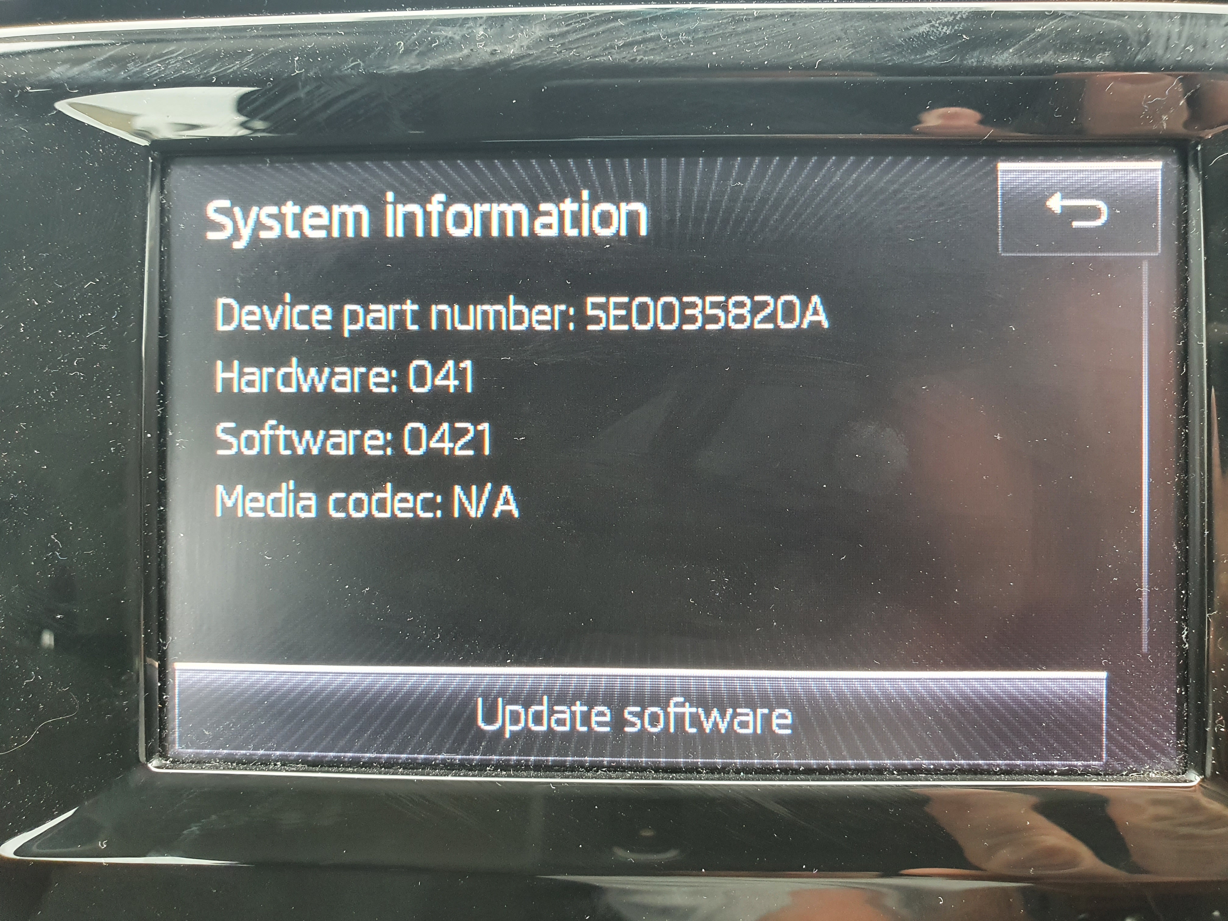

Hi @pab567 anything for:
device 5E5E0035820A
Hardware 041
Software 0421
Also, if you have, any information on getting android auto  or something similar to work?
Thanks in advance.
Downlad link you both have on PM. To get Android Auto you must have both display and glove box unit exchanged. If you are interested pls contact me on PM.

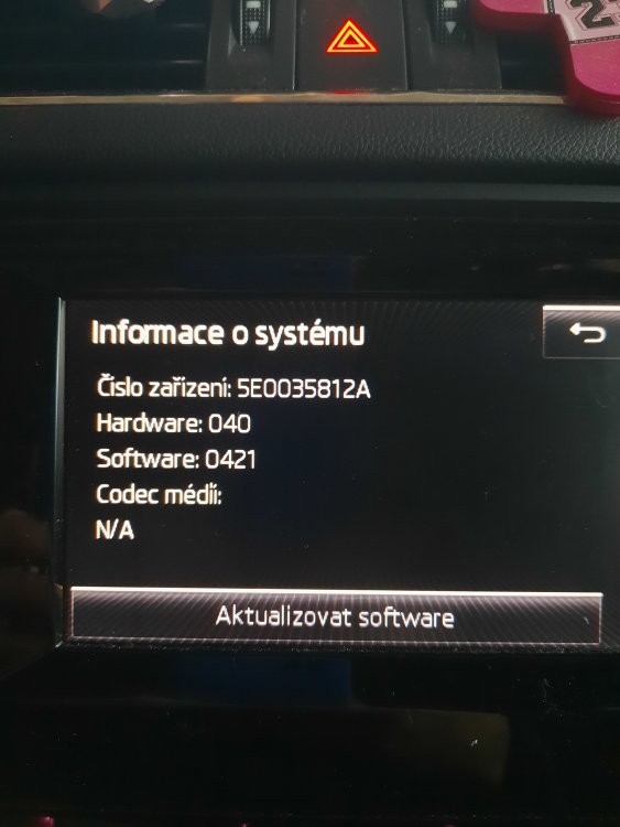

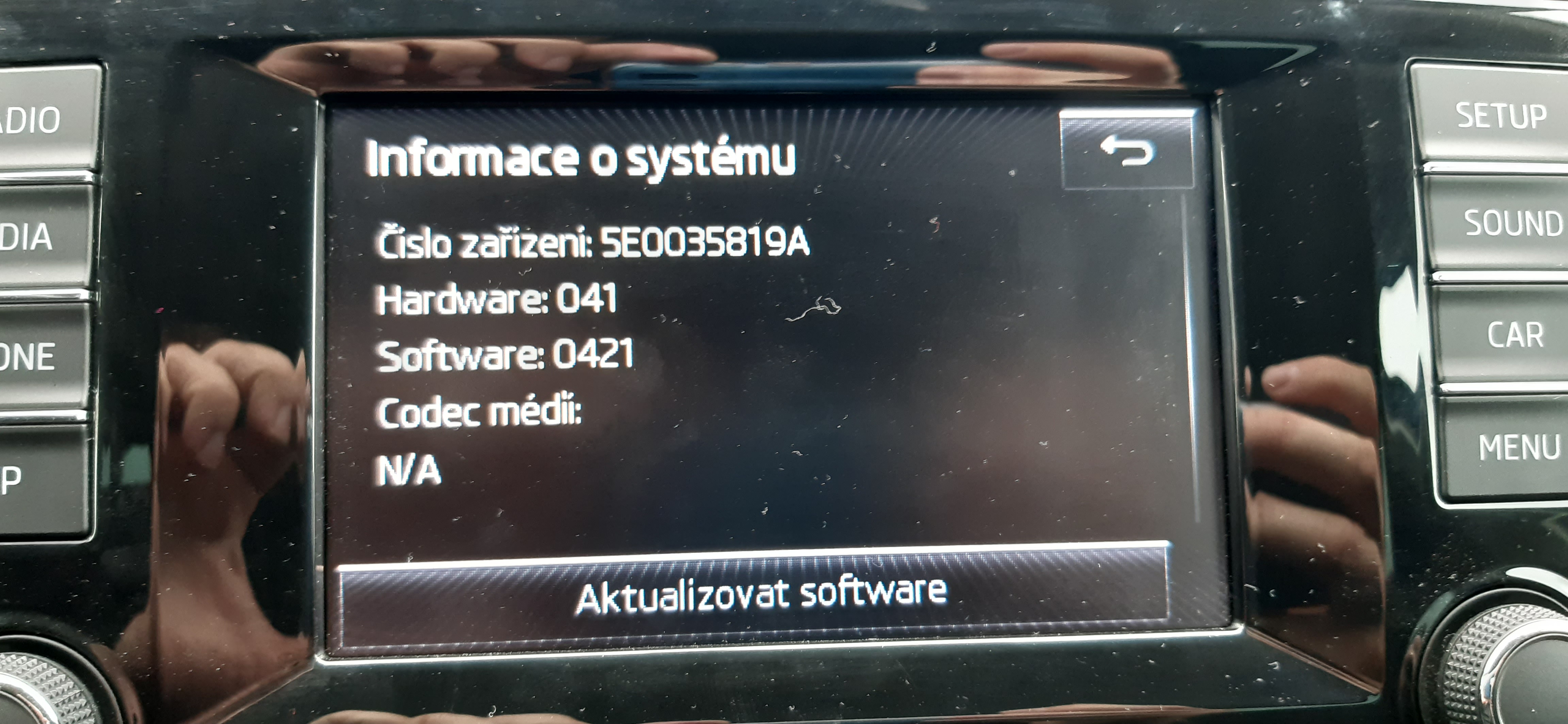

Hi,
You can send me a link to firmware update for Bolero MIB1 Octavia 3 (Slovakia).
Info:
5E0035819A
Hardware:041
Software:0421

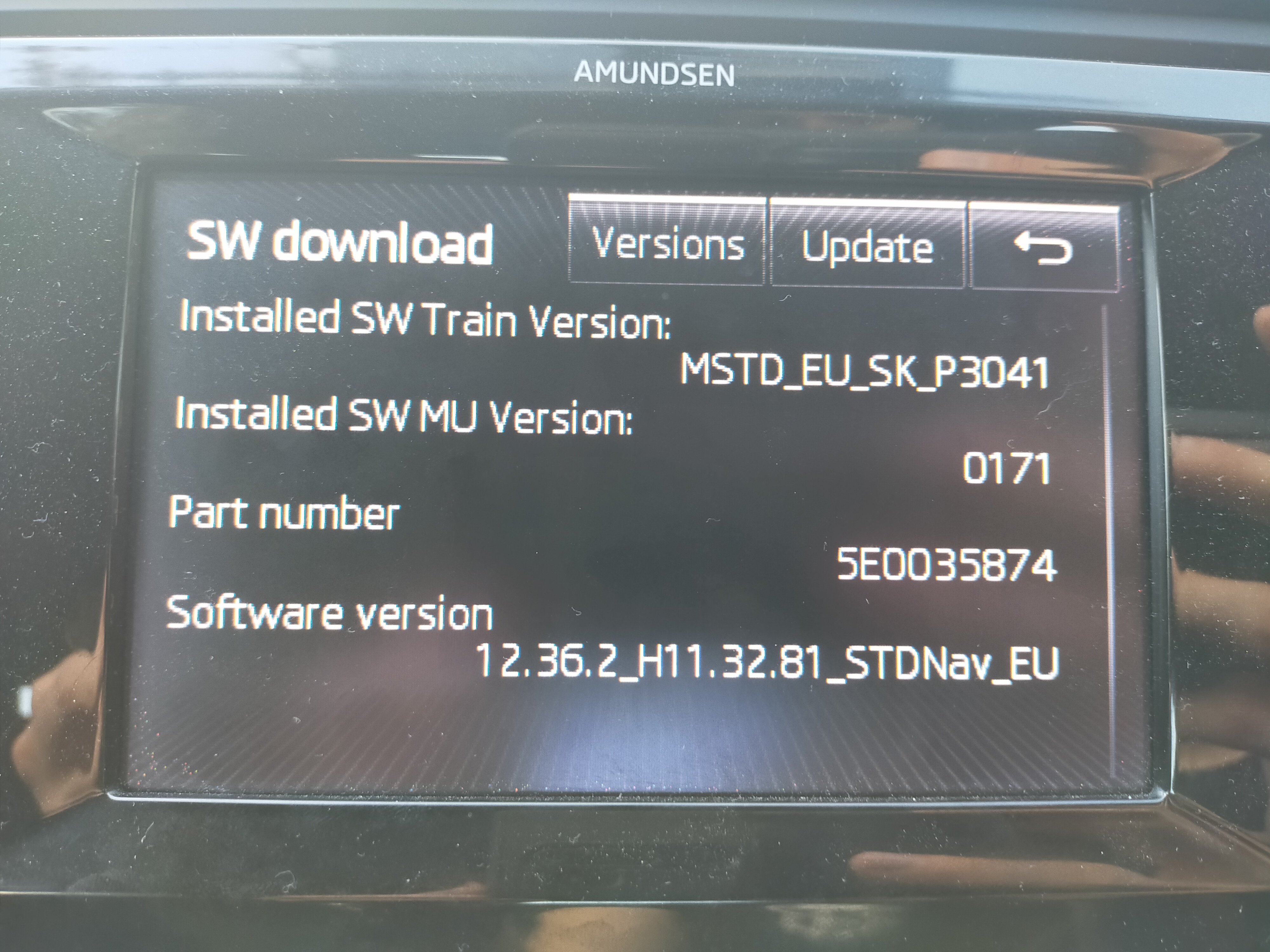

Hi guys,
I have been attempting to update my Amundsen MIB1 in my 2013 Octavia.
I have put in my VIN to the Skoda portal, downloaded & extracted files to the original Skoda SD card but the infotainment will not load the maps!
I have also attempted to use the equivalent file from VW (golf -2015) with the same end result.
Also tried using a USB & a different SD card (both formatted to FAT32) but still no joy! Can anybody help me!?IMG20210916175538.thumb.jpg.7be564278a6523bd249c59e2adf4ecf1.jpgIMG20210916175627.thumb.jpg.f11b60e22729339192605b0cc3bd18e2.jpg
13 hours ago, SRAD_LAD said:
Hi guys,
First thing is that the Amundsen will only read maps from a genuine Skoda SD card, so don't bother trying any other SD card.
I've successfully used both the maps from the Skoda portal and the VW website to update a MIB1 Amundsen (I did a byte-by-byte comparison of the files, they're identical).
For me the key steps were (BTW use a PC not a  Mac as the Mac adds files that the Amundsen doesn't like):
1) save the original contents of the SD card onto a PC as a backup
2) do a quick format of the SD card to FAT32 with 4K cluster size
3) unzip the downloaded files onto the PC
4) copy all the newly unzipped files onto the newly formatted Skoda SD card
5) insert SD card into either SD card slot and wait...

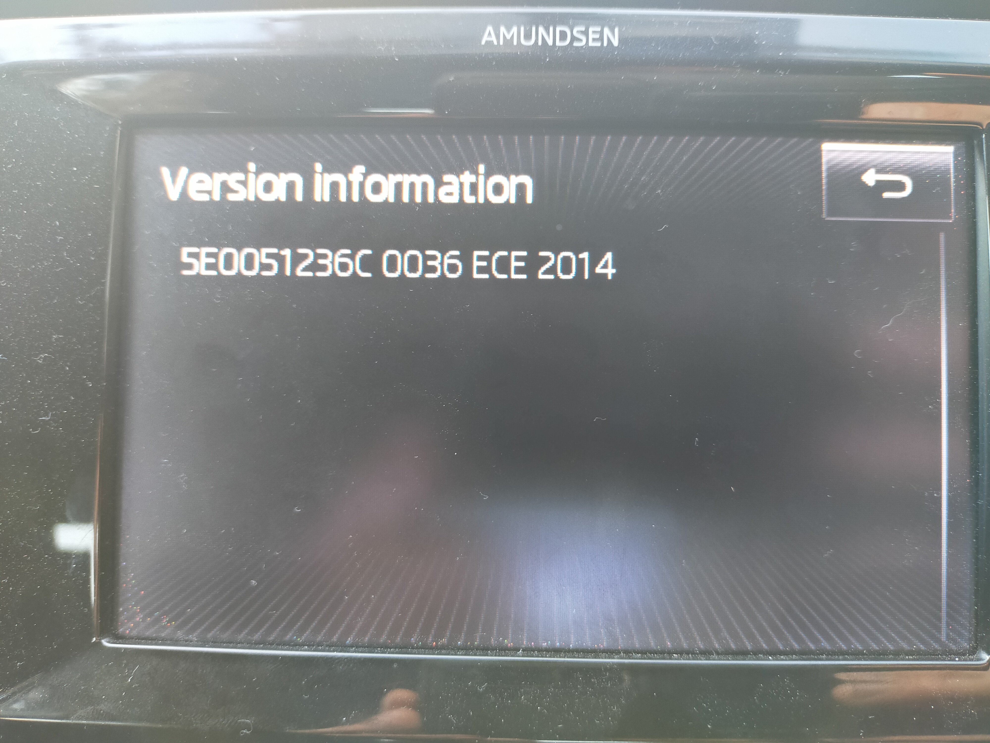

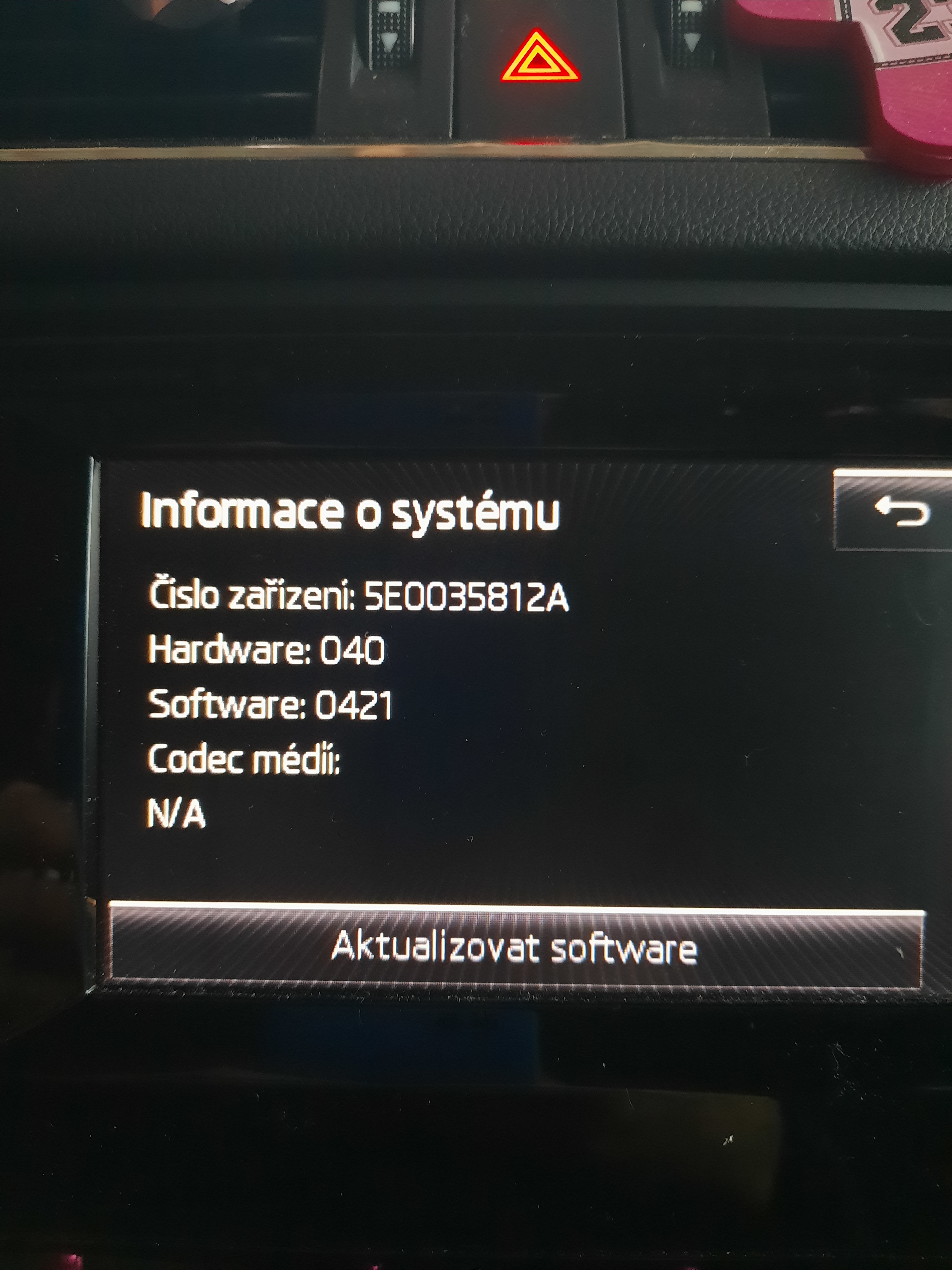

Hello
Does this radio can be updated?
thanks in advance
Hello
thanks in advIMG_20210921_004954.thumb.jpg.28f2be90b74c4623e505c3a54b5a3215.jpgance
