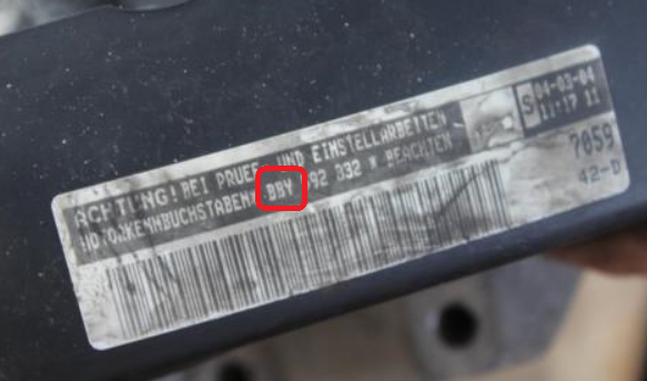

Have a look at the sticker on your upper cambelt cover. Like this (except it defintiely won't be BBY):
Thanks. Just wondered in relation to vindaloo's post on warming up time. Mine does get there ok it's just not fast at all. Any shortish journeys provide very little by way of heat from the heater. I've got heated seats which helps a bit.

A 1.9 TDI is not a VRS so therefore a PD100 is most likely, these run even cooler than ASZ or BLT, cold climates get an auxiliary heater but not here in the UK so there's not much to be done other than blank half the radiator off.
Aye, it is a PD100.
  • Sponsor
AXR or ATD engine code then. AXR looks to have EGR cooler, not sure if later ATDs did or not.
Edit: looks like EGR system on ATD is same as ASZ, no cooler.
AXR same as BLT, with cooler.
