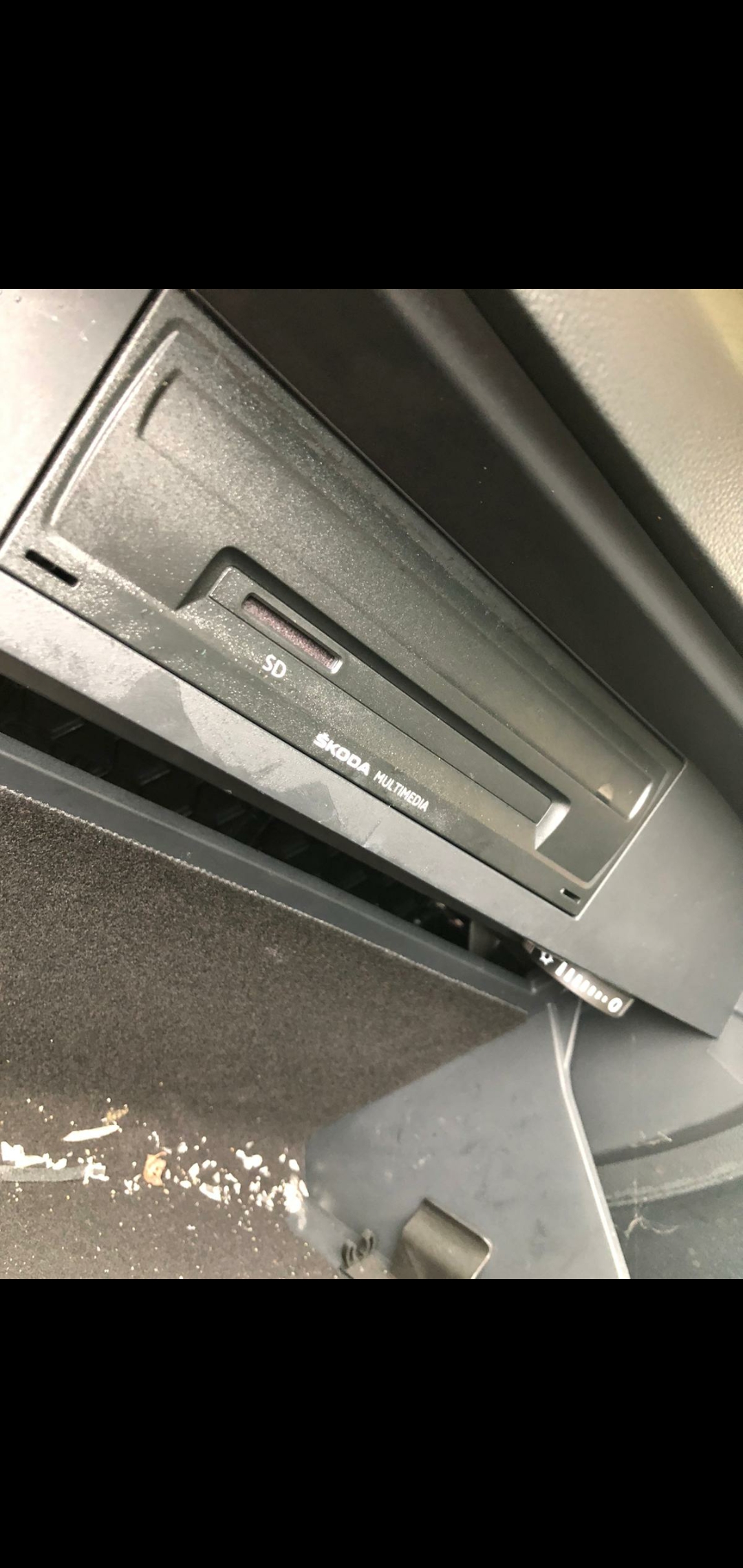

I'm so confused tho 😂 if I want to replace the screen do I need to remove the unit inside the glovebox? Also if it helps, in my glovebox it has 2 SD card slots and a cd drive

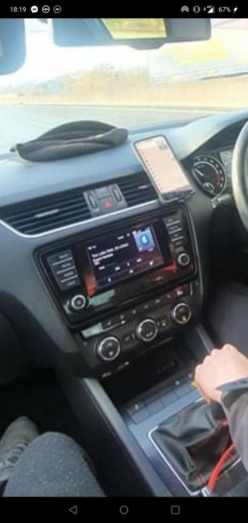

This is the clearest image I have at the moment, due to it being back at garage for a bit of tlc Screenshot_20210112-181954.thumb.jpg.77864d61396fa1c092cc98f8b01f67f7.jpg

The screen is just a display and button unit for the main head unit in the glovebox.
The screen and glovebox unit for MIB1 are only used for those specific models (stereo models, not car models).  MIB2 units have ability to interchange screens to some extent.
Different model glovebox units have increasing specs generally at 3 levels:
1. no nav, small screen (Bolero)
2. nav, small screen (Amundsen)
3. nav, big screen (Columbus)
As MIB2 have the ability to use bigger screens, many people have retrofitted the lower spec head unit witha bigger screens then use Android Auto/Carplay.  I believe the better units have better sound too.
The cost involved is to
buy the head unit
buy the screen
remove Component Protection from the head unit
code the head unit to the car
Fitting is relativly straight forward.  If you can plug a PC in you'll be fine.  Just need the removal tools which cost less than £10.

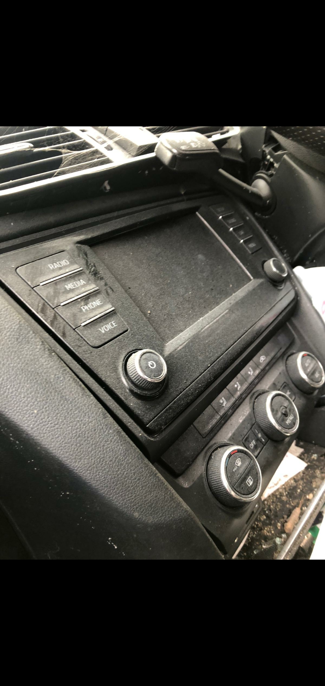

Hey guys! I've rang around a few breakers, and I found this one, does anybody know if it's mib 1 or 2? So that I know for future
Looks like a mib1 unit.
I thought that looked like a mib2 bolero.
I'm with MarkyG82 - my guess was a very dirty MIB2 Bolero :D
Like I said, I rang a few breakers and found this from a 17 plate  hence the dirt 😂
