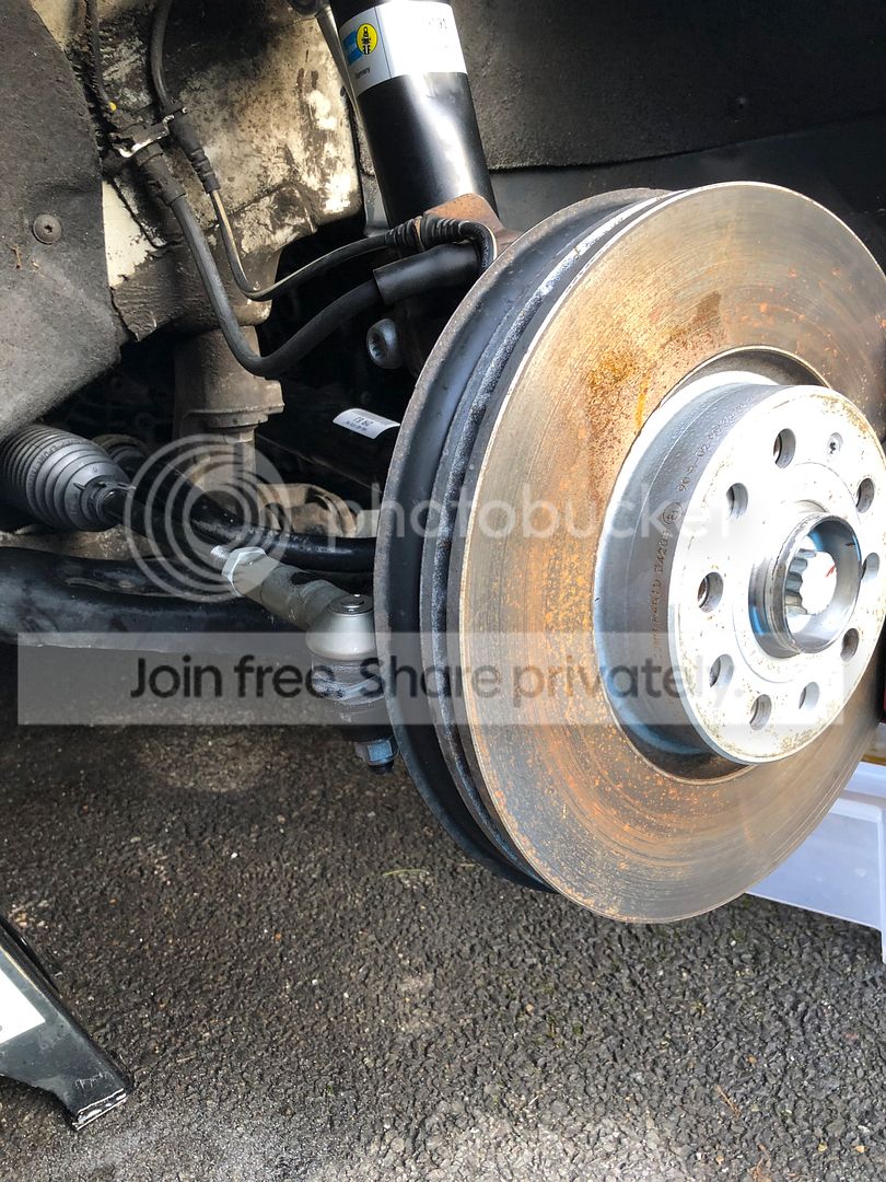

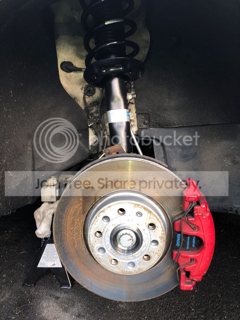

Front axle nut rusted solid, any ideas please
I did the right side, no probs. It is the style of multi 12 point with ribs on underside of head. They superseded that bolt, to smooth underside. Think I know why !!
left side. Pb blaster, 1m breaker bar, 2 blokes standing on it,
Hired a high torque Milwaukee Fuel, no movement. The one they use on trucks, 1/2 inch.
Anyone overcome this?
Bit stuck for a next step. Any ideas massively appreciated.
