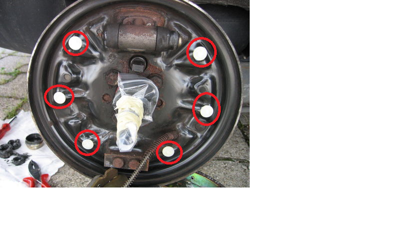

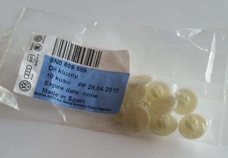

You also need the shoe glide pads as they are very often trashed. Part number 6N0 609 589 (twelve needed).

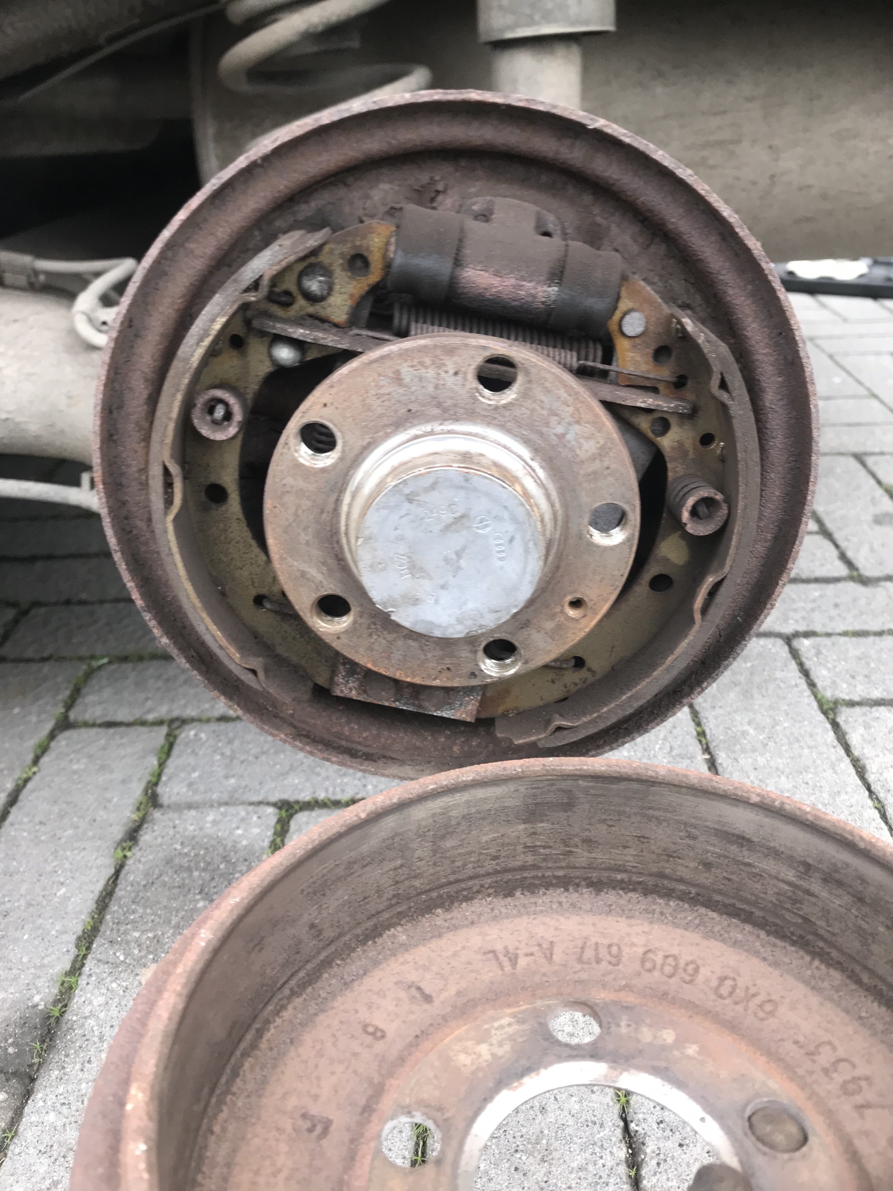

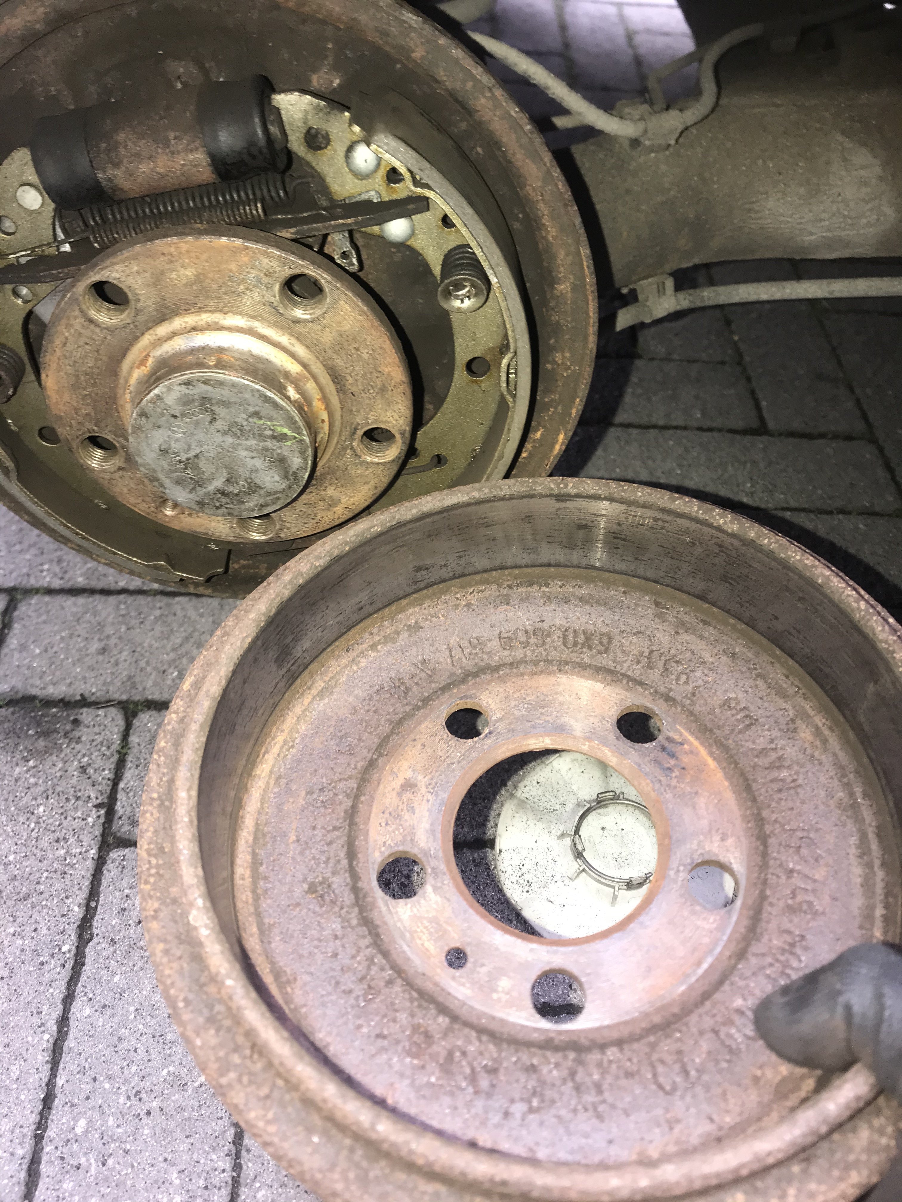

Pic 1 Driver Side drum and shoes, Pic 2 passenger side drum and shoes.
the shoes look like they have good tread? or is it worn. measurements for brake pad on shoe is about 5mm on both sides
Now to confirm; is it wise at this point to change both shoes and drums, these do look quite old.

They look absolutely fine, what's the problem with them?
They're really noisy and squealing and making that horrible noise bad brakes do.
Im thinking to get some brake cleaner and give that a go see if its just some dust and dirt thats caught up.
how do my drums look too...
They really don't look bad, just clean everything up nicely and put it all back together properly.
It's unusual for rear drums to be noisy unless there's debris inside.

Looks like driver's side shoes are quite new compared to other side.
While you've got access, and with handbrake released inside the car, check (both sides of car) that the pivots move OK at the top of the levers inside the drums that the handbrake cables pull on.  It's quite common for those to seize up, giving handbrake unevenness.

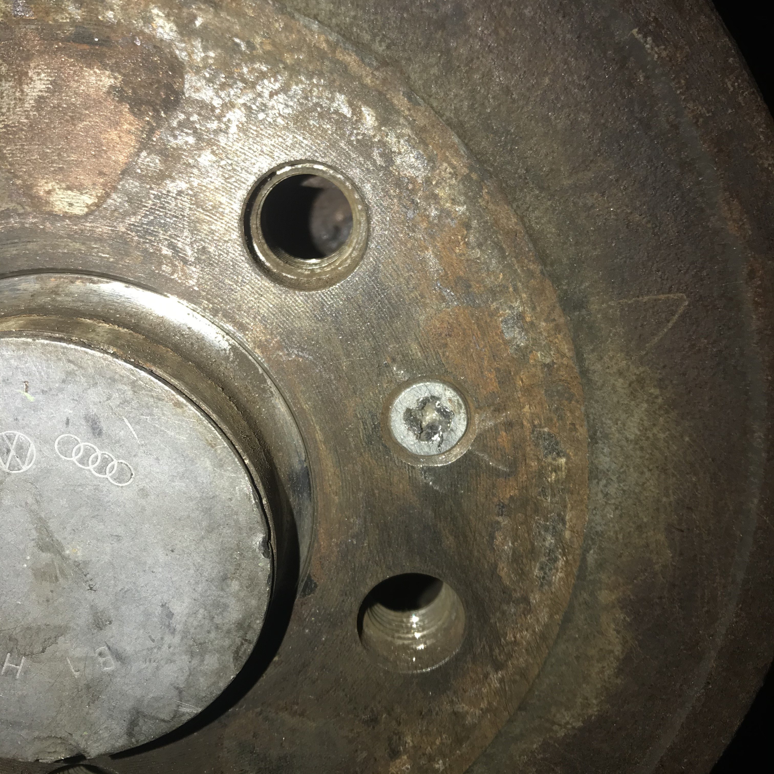

Lo and behold i have managed to strip the screw. I must've tightened them about 5 degrees t0o tight.
What are my options here, once i get this out i will be beating it up for ruining my day.
  • Sponsor
Tap it round with a punch and hammer.  Shouldn't be too difficult.
Don't worry about it, the drum is actually held in place by the wheel bolts so that screw is just to hold it in place while you fit the wheel.
Edit: just use a flat bladed driver to get it out and don't bother tightening it so much next time.
Edited by sepulchrave
And, Ill try a flat head, i have a decent toolbox, so hopefully its not gone.
And what youre saying is, if I get the screw removed, I could leave it out since the drum is held in by other bolts...

Put point of punch into the outer end of one of the mangled bits of the screw head. Hold it at a suitable angle to be able to knock it round anticlockwise with a hammer on the other end!
Nice one I'll give it a whirl now.
Nope,
it seems too far gone now. Ive seen a few tools that remove the screw but its far too late now to run around shopping, and it's getting dark..
Any hail Mary's that could get this out ?.
  • Sponsor
You could probably drill the head off, if you're determined to remove it , then you may have enough left to get mole grips on once the drum's off.

Why did you put it back together without bothering to clean it first, it woulda taken 5 minutes to spray it with brake cleaner and wire brush the drum.
The screw that you brutally overtightened for no reason does not hold the drum on, it only locates it while you refit the wheel and wheel bolts, it's there for convenience only.
