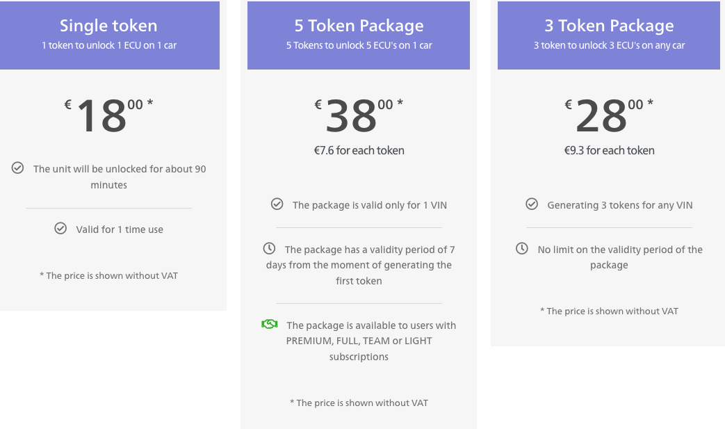

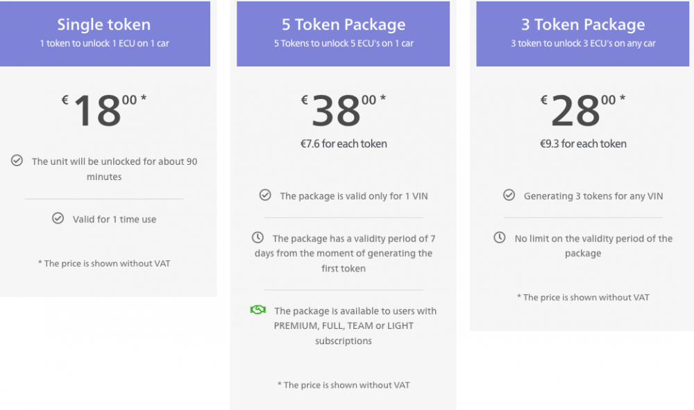

Good news, for single 35€ to this. It is going cheaper..
Just for those who could not be familiar, those screenshots are coming from VCTool, SFD section.

Tried coding with VCTool using cheap $3 adpater LM327 V1.5 and it worked great:
  • Bought 3 SFD tokens for 28€ + tax, try entering address not in EU maybe it will not charge you additional 21% tax
  • For test I unlocked only module 9
  • You will need Internet connection during coding
  • SFD token is not real time, it is near real time. You will receive email updated about queuing your request and you will receive an email when token is generated. It is very fast 1-2min max. Don't panic and try to unlock the module, you will receive CRC error.
  • After you unlock a specific module you can run all adaptions for that module
  • Modules stay unlocked for about 90min, during that time you can use other coding software like VCDS or OBDeleven
  • I used VCDS trying to enable cornering lights with fog lights without success because I don't know which channel to use. Golf 7 and Octavia mk3 channels didn't work. I also tried lowering right mirror when in reverese but I don't have memory seats and this feature is not working correctly.
  • All other adaptations are free in VCTool for module 9. My priority were "rear DRL lights" and "enable/disabe DRL in menus". I also enabled other available options for module 9.
  • I have two tokens left, next I will code Dashboard to show gearbox temp and other stuff but I'm waiting for VCDS firmware update for 21.9 version so I can check what else can be modified.
  • This bundle of 3 tokens can be used on different VINs, if you have three cars this can be useful
  • Maybe competition will force lower prices for SFD tokens soon, If you are not in a hurry wait and see
