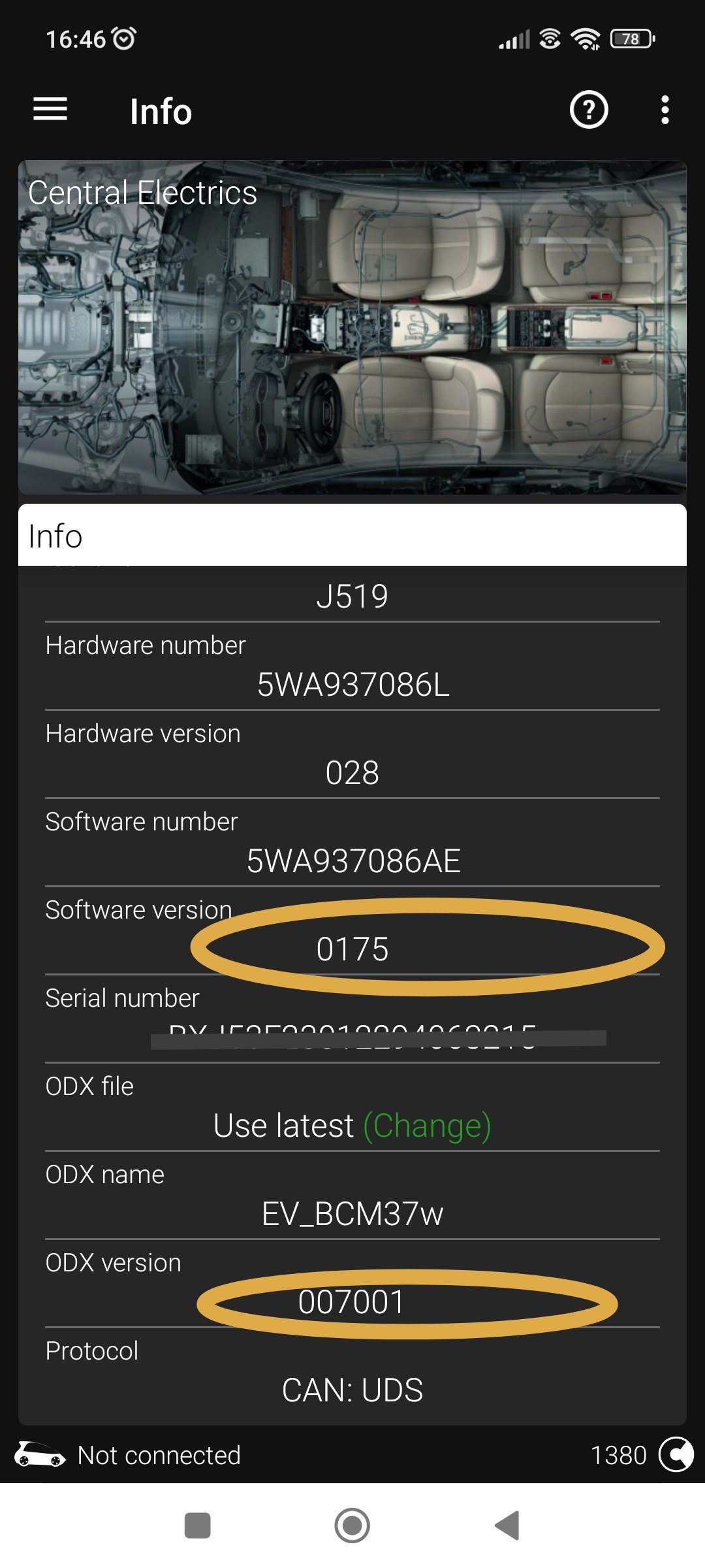

That's quite an interesting thing 🙂. Seems that this function is already released as an OBDeleven one click app but essential requirement is needed: ODX version 007001 in control unit A9. @djmartzian are you in a position to confirm?
I am running ODX version 006001 so I am not sure if this will work or not.
@Mario_Delgado, Please find below all the details about 09 - Central Electrics module  where, as mention before, the coding was accepted and the locking upon exit/leaving from the car is indeed working. ☺️
Awesome, thanks a lot for the info @djmartzian, I will take a look tomorrow, but for early versions I would say it's not going to work 😞
