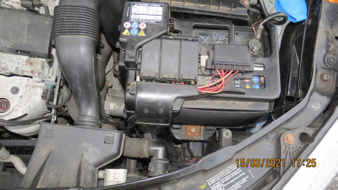

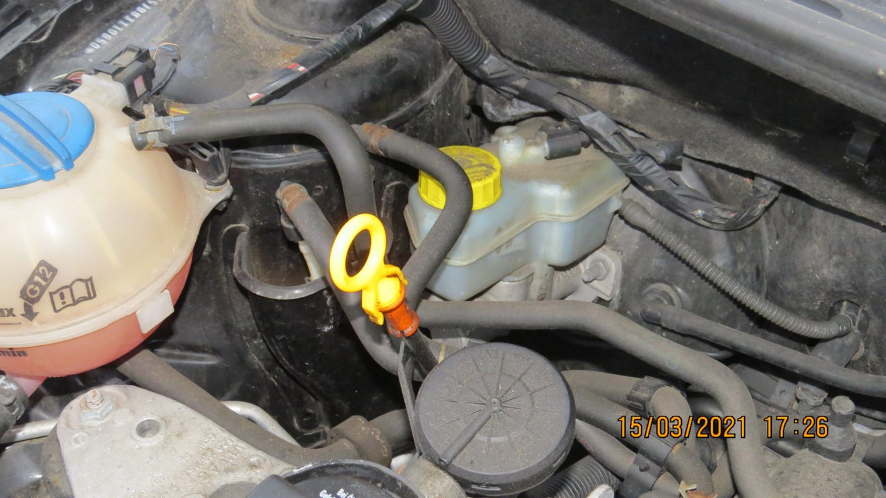

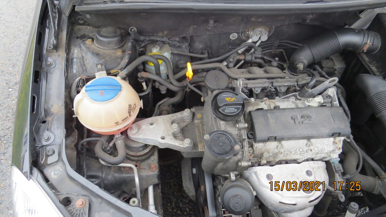

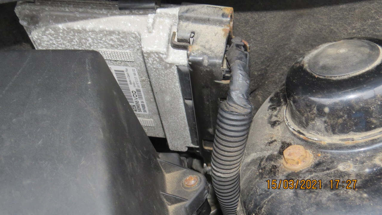

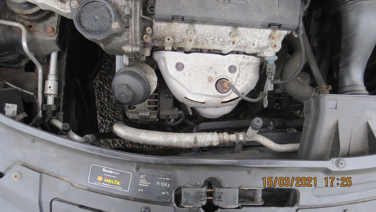

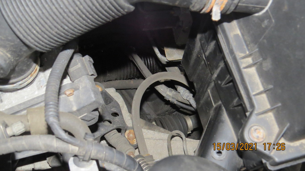

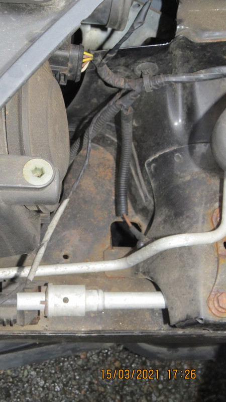

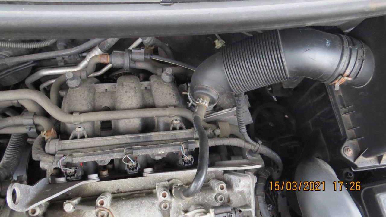

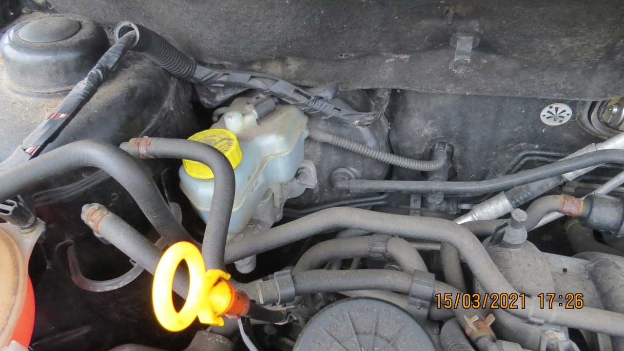

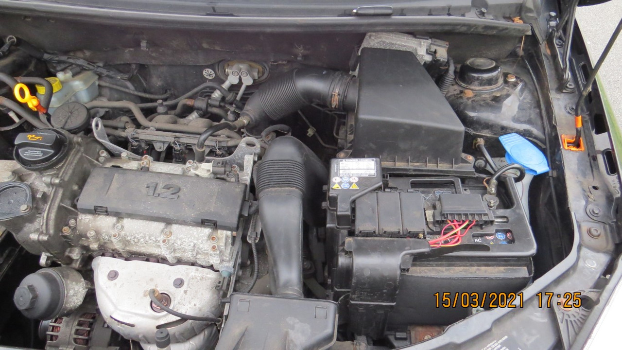

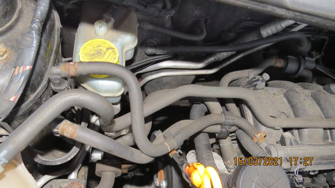

heres some pictures of my engine, the bit the op pipe is taped up, mine is ok so no idea where the leak is, will need to have a proper look/hear.
Edited by froggy8
Unless there's a massive obvious hole that I think you'd have noticed when taking the pictures I'm not sure that pictures of your engine bay can help people diagnose your problem (I may be wrong though as I am definitely a novice to all this).
If it's the same issue as mine likely is then it'll be a crack or split in one of your vacuum hoses, you'll have to do what was recommended to me and visually inspect all of the hoses for wear/damage, probably starting with the ends of each section where they meet other components.

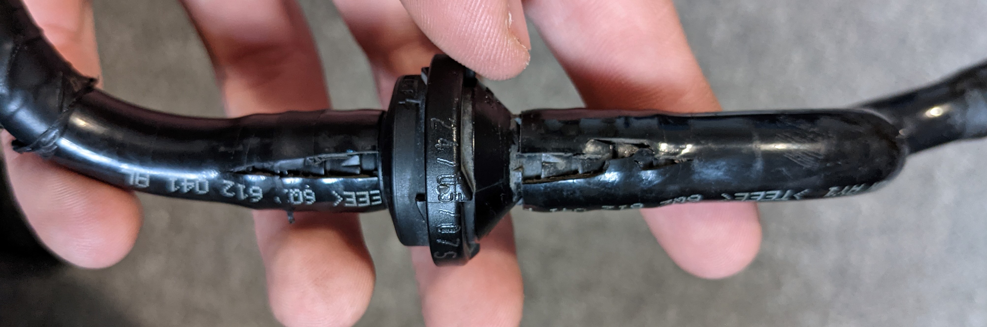

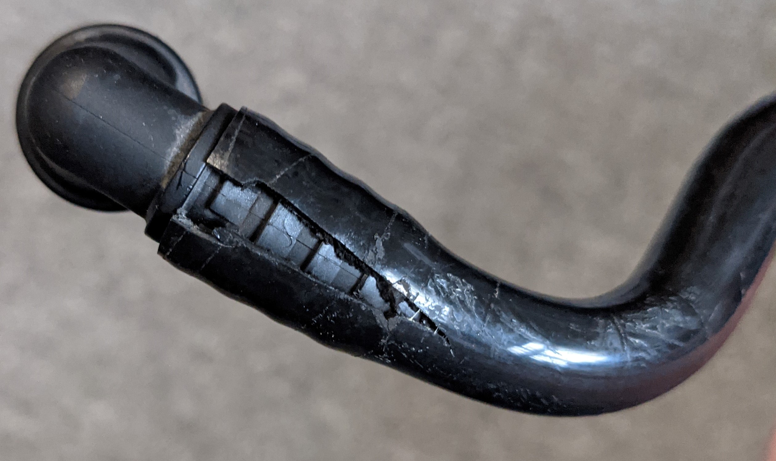

Update, that hose is absolutely split to buggery, there seems to be about 3 layers of electrical tape spanning the entire length of it.
I checked both sides of the non return valve and they both had massive splits at the back, could actually feel one them through the tape now I knew what I was looking for.
It has been taped back up and a replacement hose has been ordered from Mike at cloverdale.
Thank you to both @Wino and @sepulchrave for your help with this.
Hopefully this is the only hose of mine that is split and the vacuum leak is no more.

Hopefully so, when it's been swapped I'll take all the tape off and see what the full extent of the splits are, will post a picture if folk are interested.
  • Sponsor
Here's one I found a couple or three years back; a neighbour's 2005 Polo:
@Wino I unfortunately think this is worse than your example.
The end that goes into the inlet manifold
Eitherside of the valve
The end going into the brake booster was not cracked somehow.
Checked the date of manufacture and it's 2007, so this has been with the car for it's whole life.
New hose is installed and hopefully the car is now happier as a result.
Cheers again all for your help.
Edited by BrumTom_
