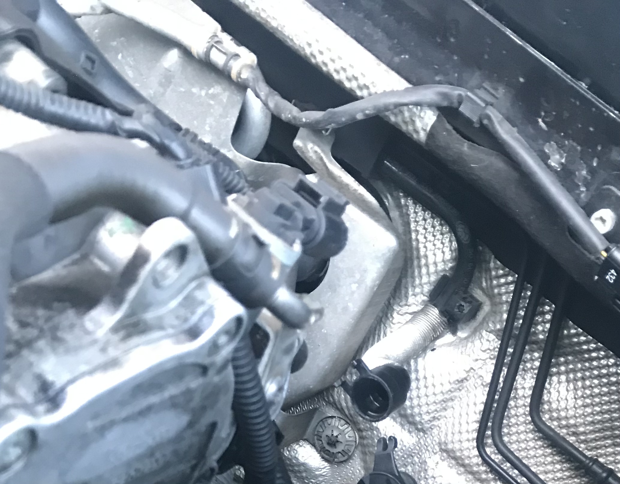

I hope you don’t mind jumping on ya thread and asking I ve got to change my servo vacuum pipe, I’ve unclipped it but how do you remove it? I’ve looked all over the web and can’t find nothing :(
On sorry , this is a Skoda Octavia vrs 2006
Mine was just push fit on both ends, so had to walk it out/off of the connectors on either end, not sure if your's is the same or not
Thanks bud , unfortunately it’s not it’s seems every pipe in closed in a box behide a heat Shield, ive been asking since Wednesday on Skoda sites but no1 got back to me yet :(
  • Sponsor
Take a Stanley knife to the silvery heatshield if you can't be bothered to undo it via the clips that just unscrew (mid-bottom of photo). Then tuck the new one behind the flap and gaffer-tape it shut.
Can't see enough of the next bit along to help much, but tyrapping it to the other pipe that seems to go through something would be an easy solution.
Show us some more photos, give us a chance.
Thank you , I’ll look and take some more tomorrow and have a proper look , I should of took more when I was looking at it , with the picture I put up , if u follow the unclipped pipe to near the top of the photo and across abit there’s a looks like a black trucking . Pipes go’s through there tight with a few other pipes and comes out the other side into the servo ,
  • Sponsor
So there's probably a way to open that trunking. Get in there and start pulling and poking. :)
With me luck ,, I’ll probably write the car off lol
I changed it over but now I’ve got hissing noise from brake pedal 😢
