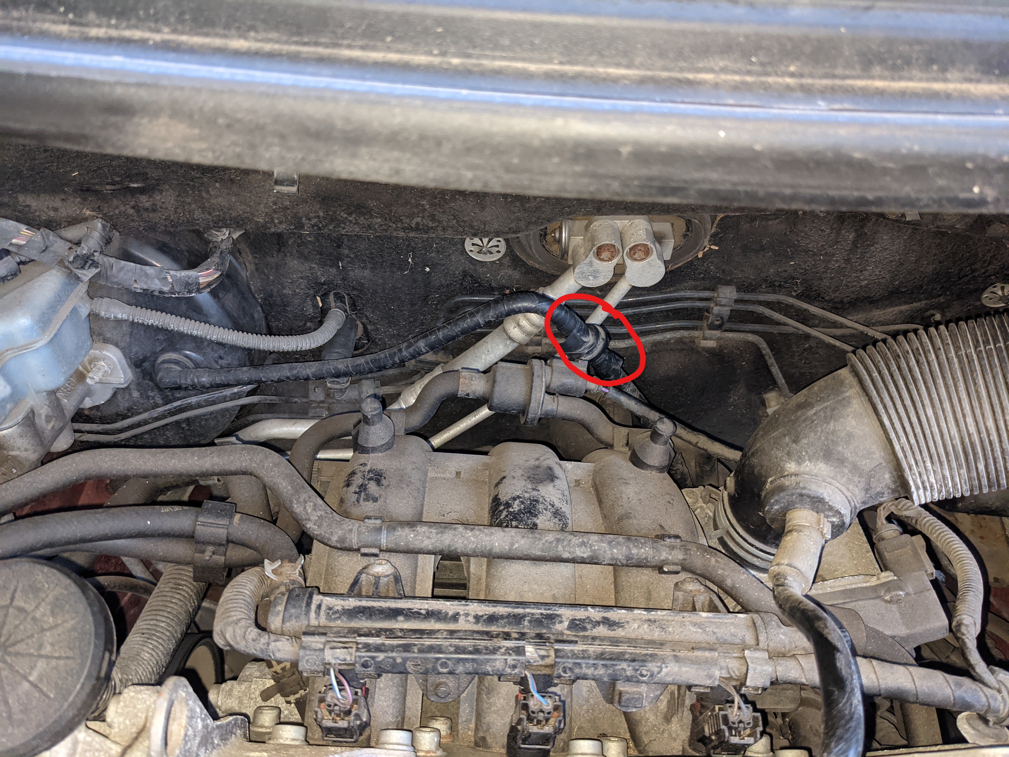

On either the brake servo vacuum hose is a favourite for leaking at the connections to the non-return valve not far from where it leaves the inlet manifold.

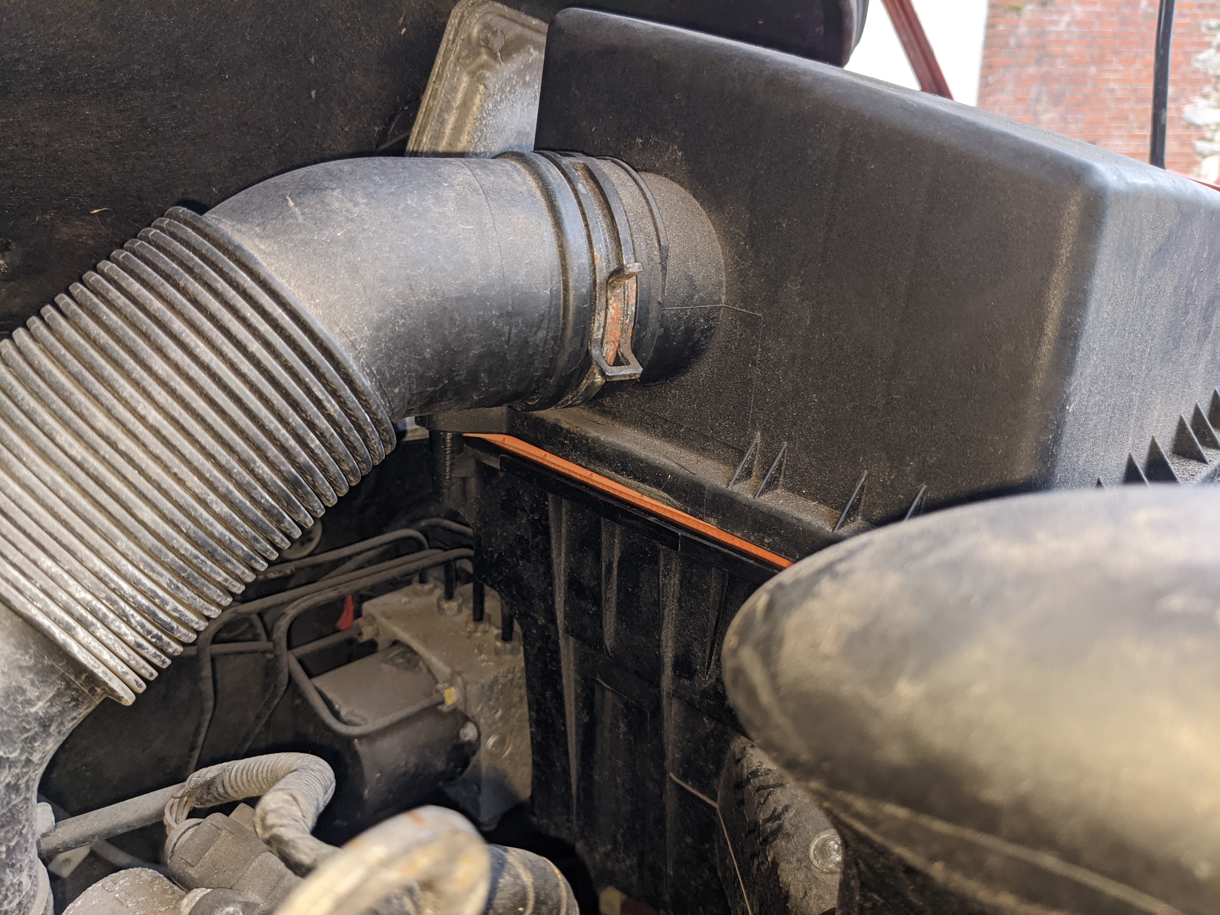

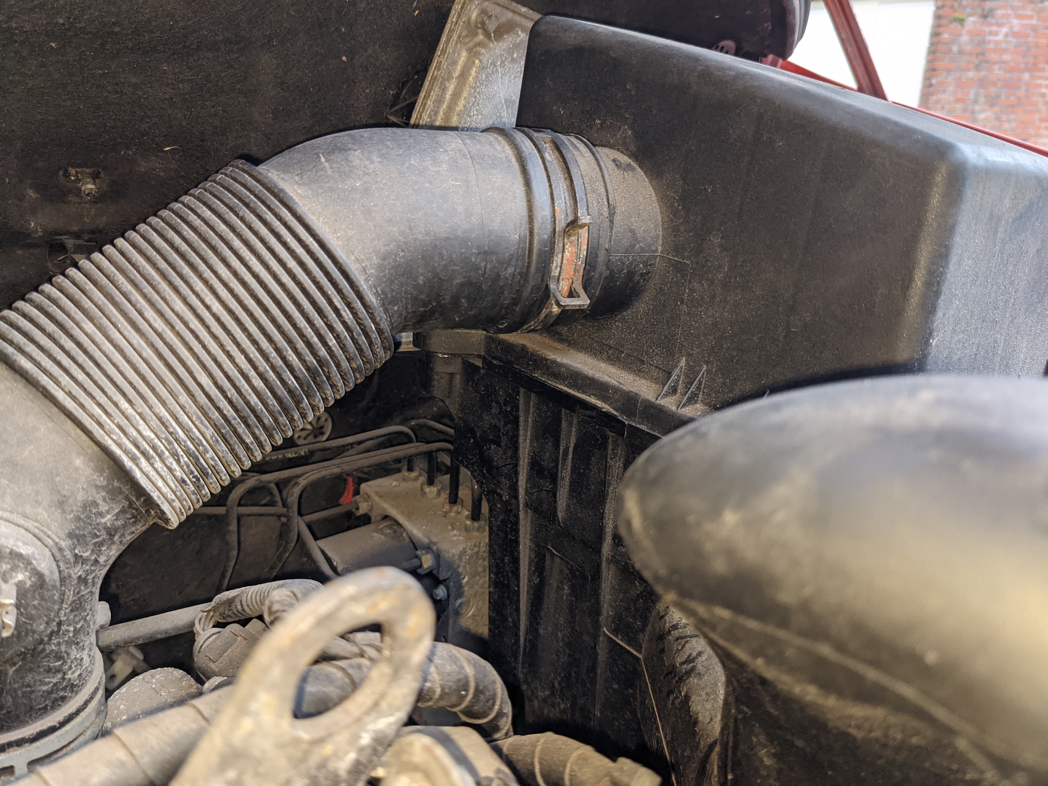

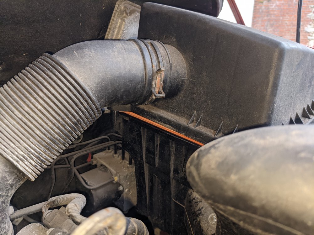

Not sure if this was the only issue but it definintely wouldn't help the air leak situation, I would like to preface this by saying my more knowledgeable mate who was there at the time was responsible for swapping the airfilter whilst I was doing the pollen filter.
The back left screw missed the mounting hole... This is now fixed.

Unfortunately, air leaks upstream of the throttle body won't be relevant, they'll just let unfiltered instead of filtered air in.

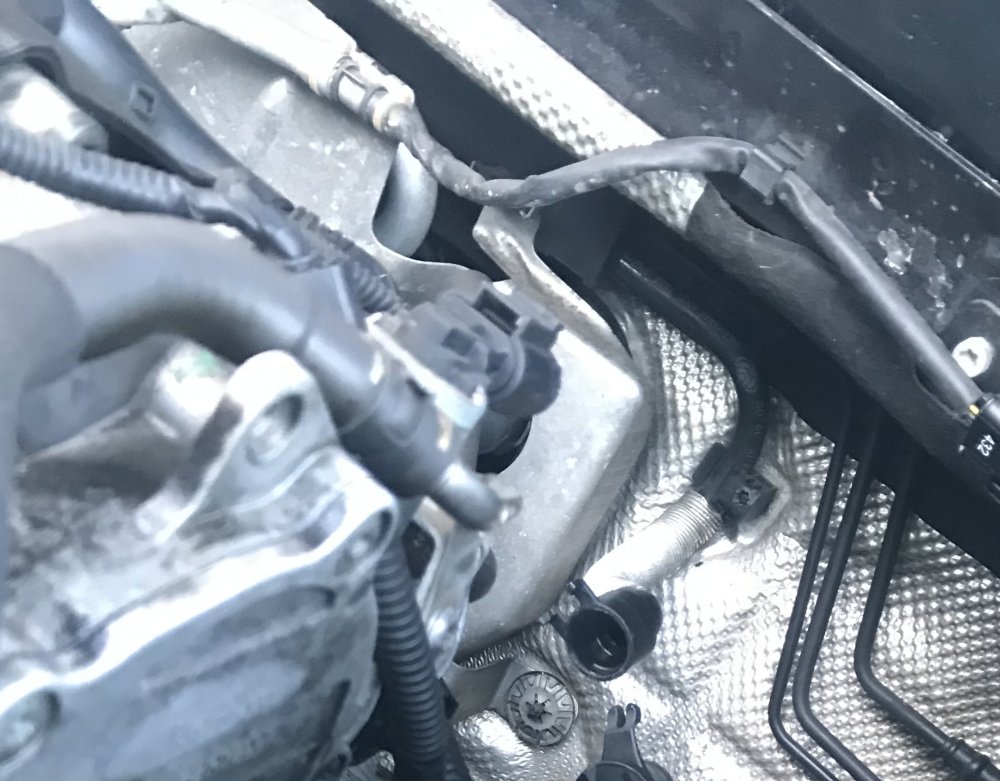

I have had a feel around the non-return valve (or atleast what I believe it to be and have circled in red) and cant feel anything when the car is running, I don't think I'd have expected to though tbh
I will give it a run tomorrow to get the engine hot, when I do what should I do to test afterwards if the leak is there, I have read that spraying stuff onto the hoses and listening to hear if the revs change is a good idea, is that what you would recomend?

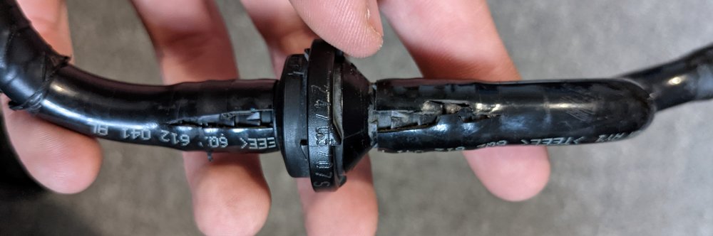

Dude, that hose is covered in elec-chickens tape! It's bound to be split to hell under there. Fix it.
Ok noted, that would explain it, I thought as it was all covered maybe it's supposed to be that way. I was wrong.
I assume the previous owner also discovered it was leaking and this was their fix for it.

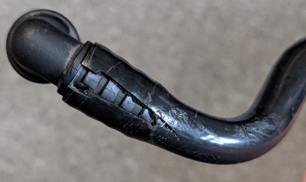

Peel off the tape either side of the non-return valve and re-do it carefully with gaffer tape.  See if the fault goes away.  Always a good idea to be sure of a diagnosis before spending hard-earned.
Yeah agreed, I assume this will probably need replacing sooner rather than later even if the current bodge job is still holding, so if it's not the problem might as well do it at the same time once I've identified the source of the current leak
It will be leaking, that tape is flapping about and the adhesive liquifies at under-bonnet temperatures, the only stuff that's airtight is self-amalgamating tape and that doesn't really like the heat either.
