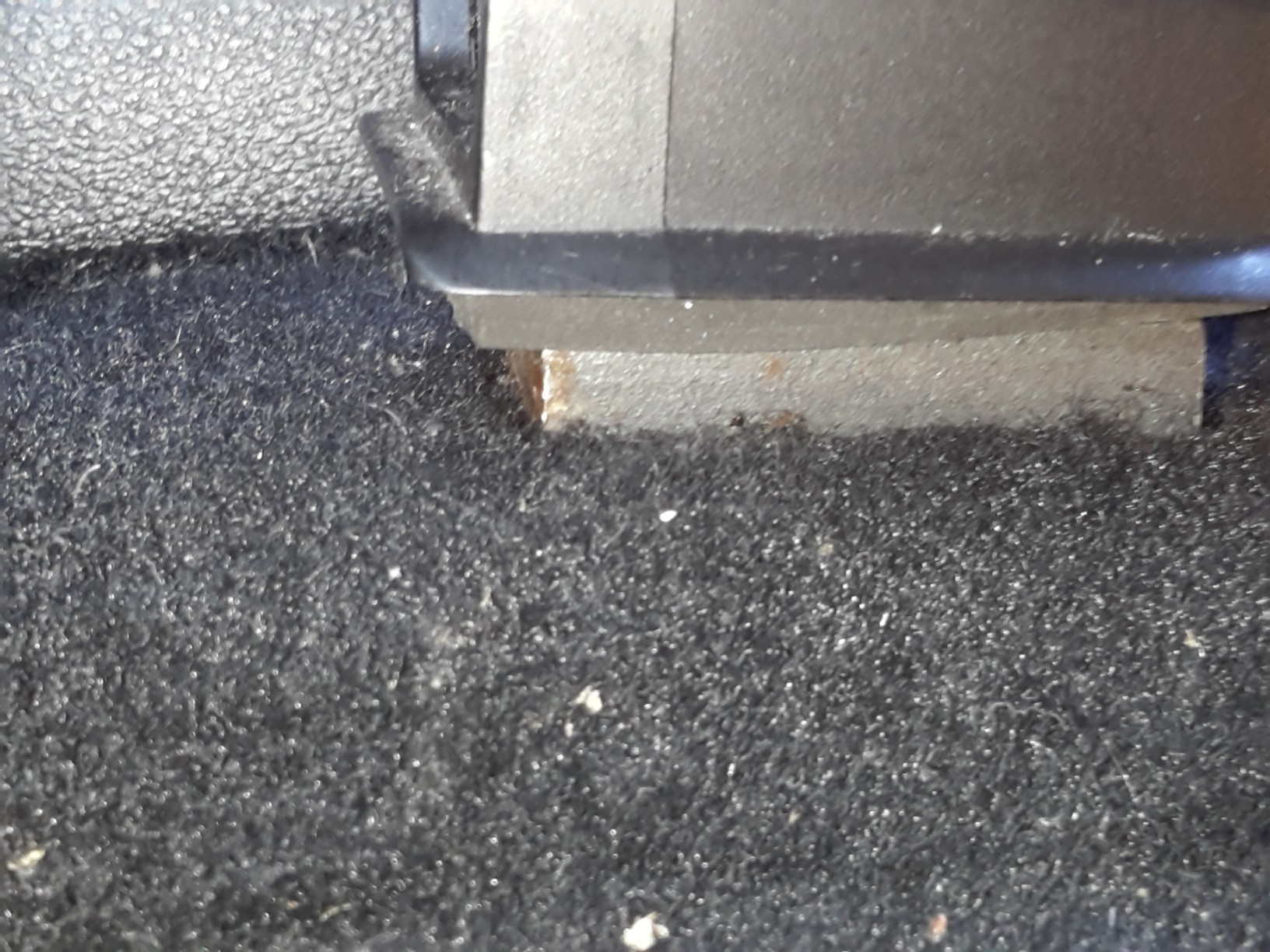

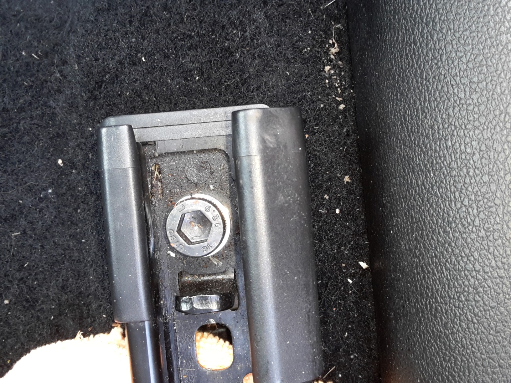

Some photos and more info for the tilt angle increase:
The 2 front bolts are M10 x 50mm ,
https://www.mackay.co.uk/m10-socket-cap-metric-head-allen-hex-screws-fasteners.html
you also need 4x M10 spring washers.
https://www.mackay.co.uk/washers-spring-stainless-steel-nutsboltsscrews-fasteners.html

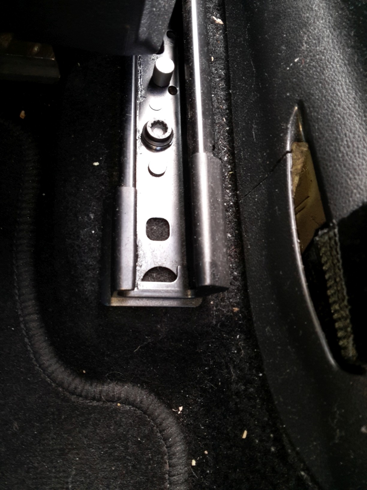

Even though you replace only 2 front bolts, rear bolts also need spring washers for everything to sit securely and not come undone, as the angle has changed.
The actual supports are 12mm thick steel, 25mm wide and 12mm high, cut to 45mm length, with a 10mm thick solid neoprene rubber laid on top.
Steel goes at the bottom, rubber at the top to allow change in angle.
https://www.mackay.co.uk/flat-black-mild-steel-metals-warehouse.html
I got bolts, washers and steel from Mackay, though they are pricey for shipping. The nice thing about this shop is they cut your steel to order, so only drilling is required (pillar drill best for the steel and the neoprene).
But feel free to use other suppliers.
As I said earlier, I got short neoprene rubber strips from Ebay, search for solid neoprene rubber strip in about 25mm width and 10mm thickness. I would not go higher than 12mm with a neoprene rubber strip alone, you need steel underneath for support.
You can see front lugs in the photo, they still are in the floor for a few mm. There are also rear lugs I think, closer to rear bolts.
All in cost was about £15, plus drilling 4 holes (2 in steel and 2 in neoprene). Not much visible from top as there are plastic covers on rail ends, I had to put mobile phone right to the floor to make the photos.
HTH
Front supports:
2029510938_frontsupport20210321_083645.thumb.jpg.30f5c223d871784c641ec2f72ddb84f5.jpg
Front bolts with spring washers:
528359318_fronthexboltwithspringwasher20210321_083721.thumb.jpg.286ef41ee169829192b99086be6efb9f.jpg
Original rear bolts with added spring washers:
482142750_rearoriginalboltwithspringwasher20210321_083852.thumb.jpg.0a5598d9a03cccecf67f84c4397ecb98.jpg

Thanks so much for that.  Will make it much easier to try this idea.  Apart from being a cheap option, it's also reversible if so desired.
I think this could be good as it'd allow a greater degree of angle whilst adjusting the height as the seat seems to tilt more than separate height and tilt.  Eg.  You can crank the angle and then maintain that same angle when trying to add a bit of height to the seat which I think would help the long legs too and addresses an element of what @varaderoguy also said.

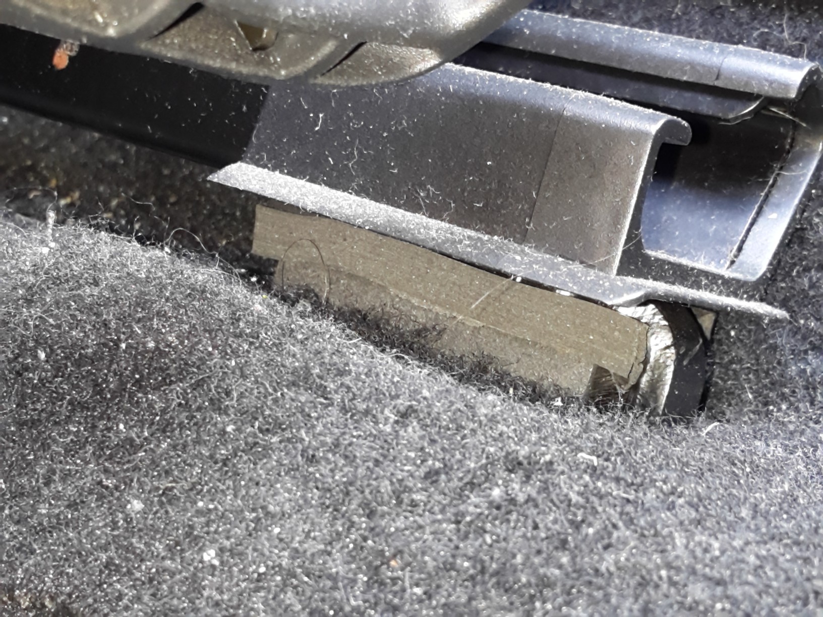

That aint steel in the photo!
Steel at the bottom, solid neoprene rubber on top. Another picture from different angle:
Edited by dieselV6
My mistake, now I can see what I was looking at rather than what I thought I was looking at its very clear to me, the rounded sheet steel seat frame looked like black neoprene on top of two distorted blocks of fibreboard.
