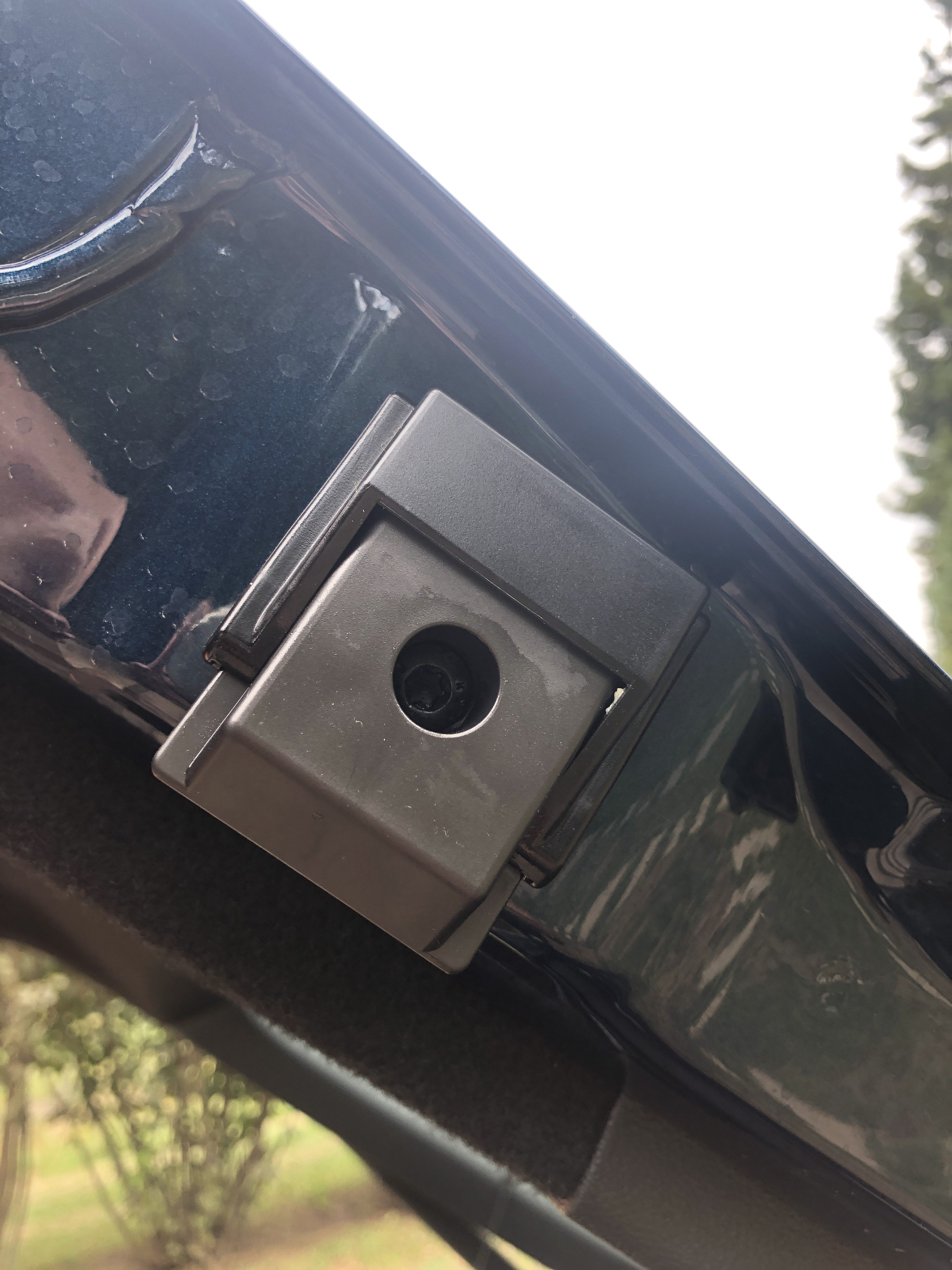

    I've got the same thing in my boot but can't work out what it is. It sounds like something is flapping up and down, almost as if the hatch is not closed tightly or the boot liner is not completely fla
Hi In my opinion it’s the boot if it’s a hatchback the black plastic  things on either side of the tailgate when you open it you can press them in which is what happens when the boot closes I put loads of grease into them and it stopped not done it since.

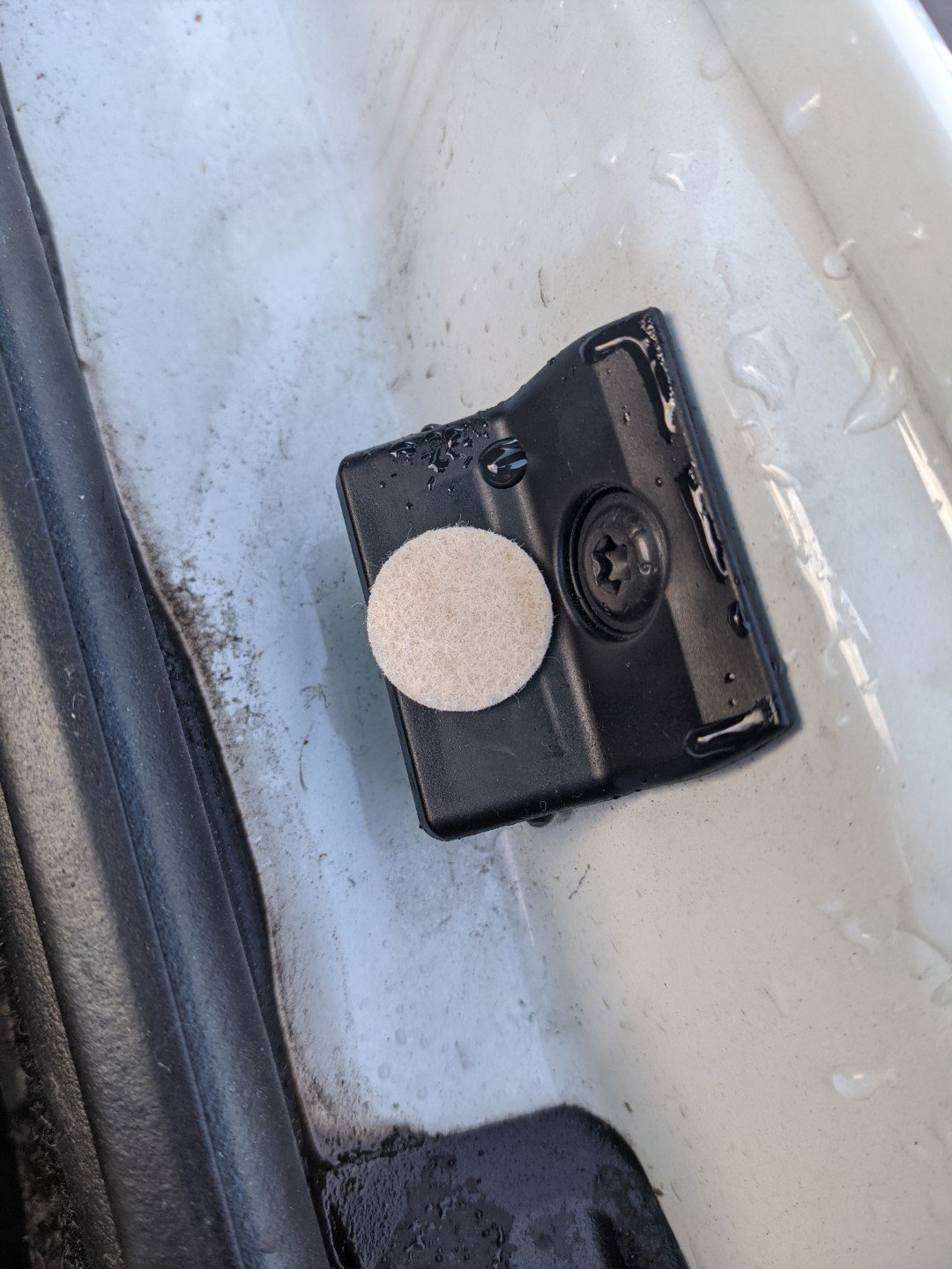

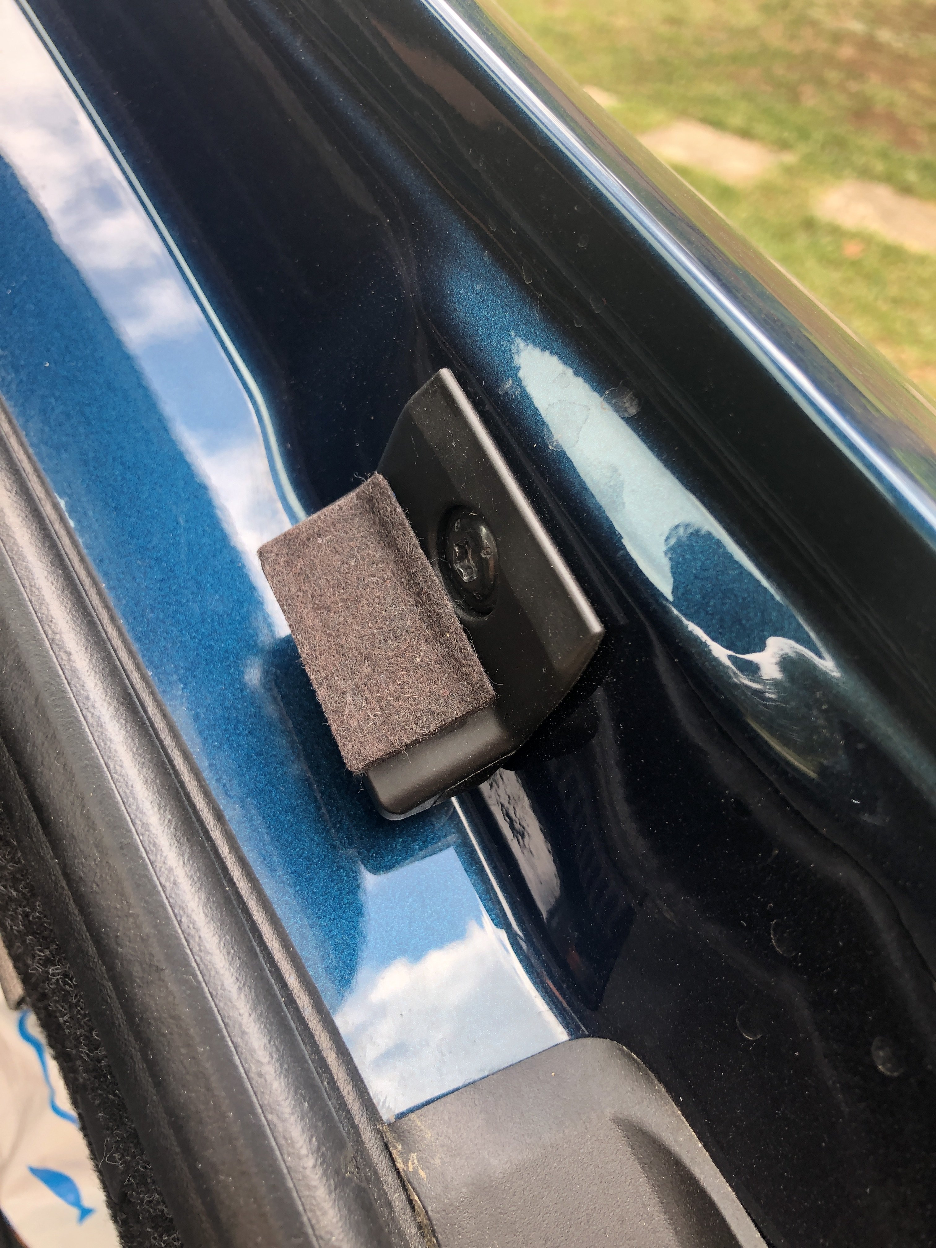

Damn dumpers, simply design flaw. I went crazy and even removed everything from my trunk, and rattling noise was still there. Even though that there might be issue with hydraulic door lifters plastic shield, but at the end problem was definitely dampers.
So I SOLVED the problem by following advice in this topic and applied two felt pads (left and right) and voila, rattling noise disappeared:)

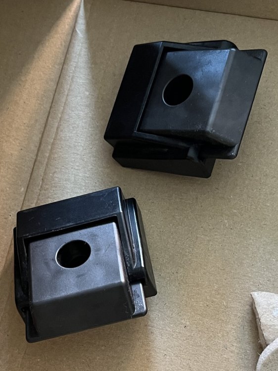

Hi all, I had the same problem with my MK4. Last week the car went to 15 000 km service and I mentioned the rattle in the back. The dealer told that there is a recall for that problem and they replaced the spring dampeners on the boot free of charge.
Everything is quiet now, it's like I'm driving a new car 😄. The new dampeners feel a lot stiffer than before.
Great news. Is it redesigned dampener or just a new piece?
To my knowledge the parts were replaced and they physically feel like they have stronger springs in them. I don't know if the old parts were defective components or just bad design from the start.
Do you mean this parts?
https://m.oemvwshop.com/5ja827249b-buffer-p302630/
15 minutes ago, derdewyl said:
Yes, these were replaced for new ones.
Ok, i change these parts, myself last winter.took car two times to dealer,they do nothing that helps.so i bought these parts to myself,cost 2xpieces 20€. That help,my car has been now silence at the back 6months

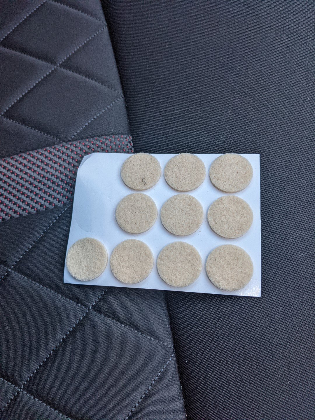

Gone with the felt pad option, it looks crap but it works. Shame it doesn't fix the infotainment system 😀
£1 for a pack of 24 from Amazon.
