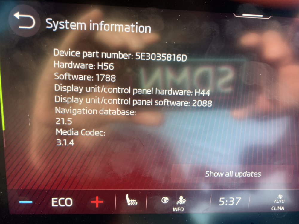

I was just watching a video on a British Golf 8 GTI Clubsport and I notice that the values in its system info screen are identical to those in our Skoda VRSs as shown earlier in this thread.
Here is a screen capture from the video. Note the device number, hardware and software  versions are similar or identical to: 5H0 035816 D (vs 5E3 035816 B), H56 (vs H56), 1788 (vs 1788).
So the values we see are not as specific to the car model as I had thought. I wonder if the VW users have similar issues to our Skodas. Does anyone know what the equivalent forum to BRISKODA for VW users is?
People have the same issues with all cars in the VAG group.
