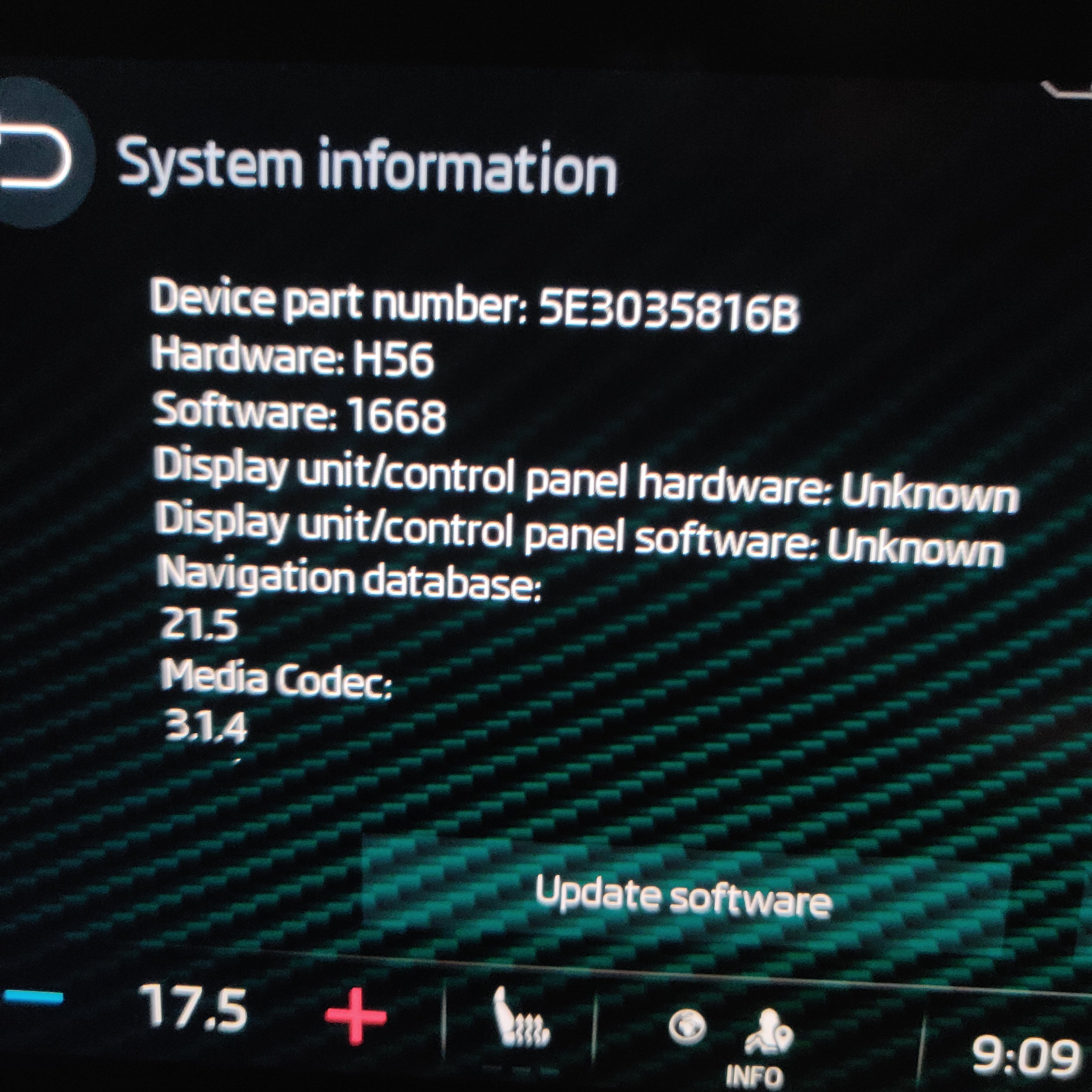

Not sure if I have done this right, but showing as software version 1668

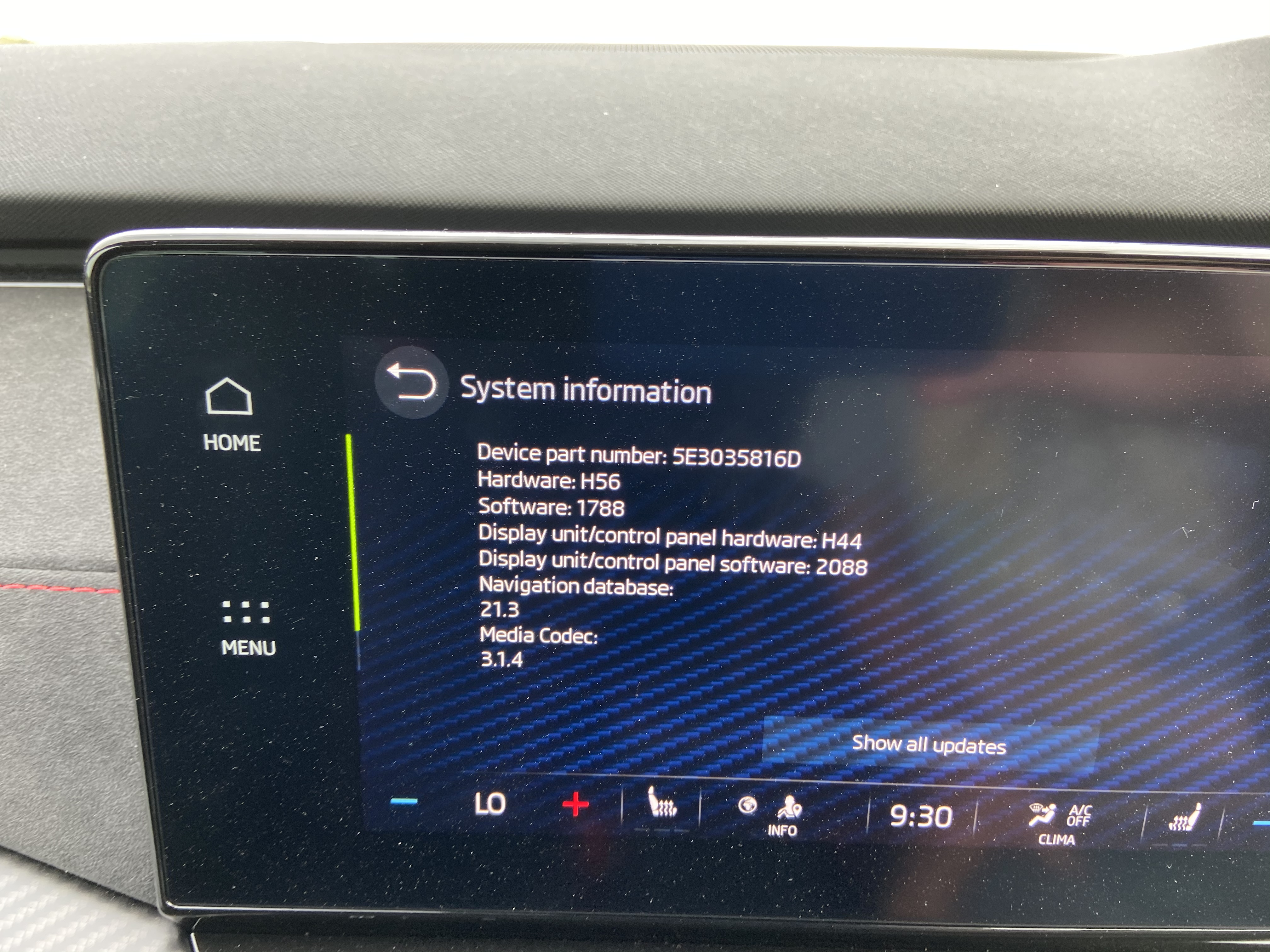

Mine went in last week and has the VW wide 1803 installed in the Golf and Octy. My prev SW was 1788
1668 is what mine is showing.  Others seem to quote 1688

@krsone01634 can you make a pic of the car's system info?
I think this was already discussed here on this forum. HW units ending with letters A, B or C (or no letter) have SW versions 1668 (some also report 1688). The units ending with D and onwards, have SW version 1788. The latest upgrade for 1788 version is 1803. For 1668 version there is no know upgrade to this date (at least to my knowledge). So it would be really interesting to know what did they actually update on krsone01634's car. Is it possible they swapped the whole unit? I did notice some posts from people saying Skoda has swapped their computer unit which has fixed all their problems.

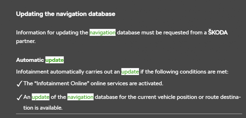

On 07/06/2021 at 23:20, krsone01634 said:
Hello,
I have also the same device part number, the same hardware and software and the same media codec.
But I have 21.2 navigation database.
I recently visited the dealership and they installed the updates that the car  had pending. There they told me that they don't update the maps.
Does anyone know how this version of navigation databse is updated?
2 hours ago, fguirado69 said:
Hello,
It's update automatically over the air. Once update is available for your car, you will get a notification message on your screen.

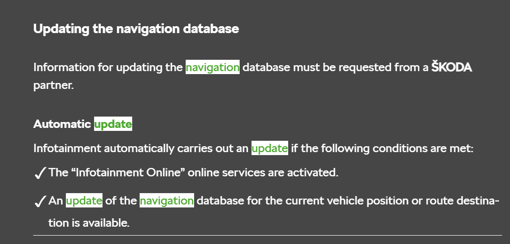

Hello,
Yeap it's an OTA.
This is mine at the moment. See what happens next week when it gets its software update.

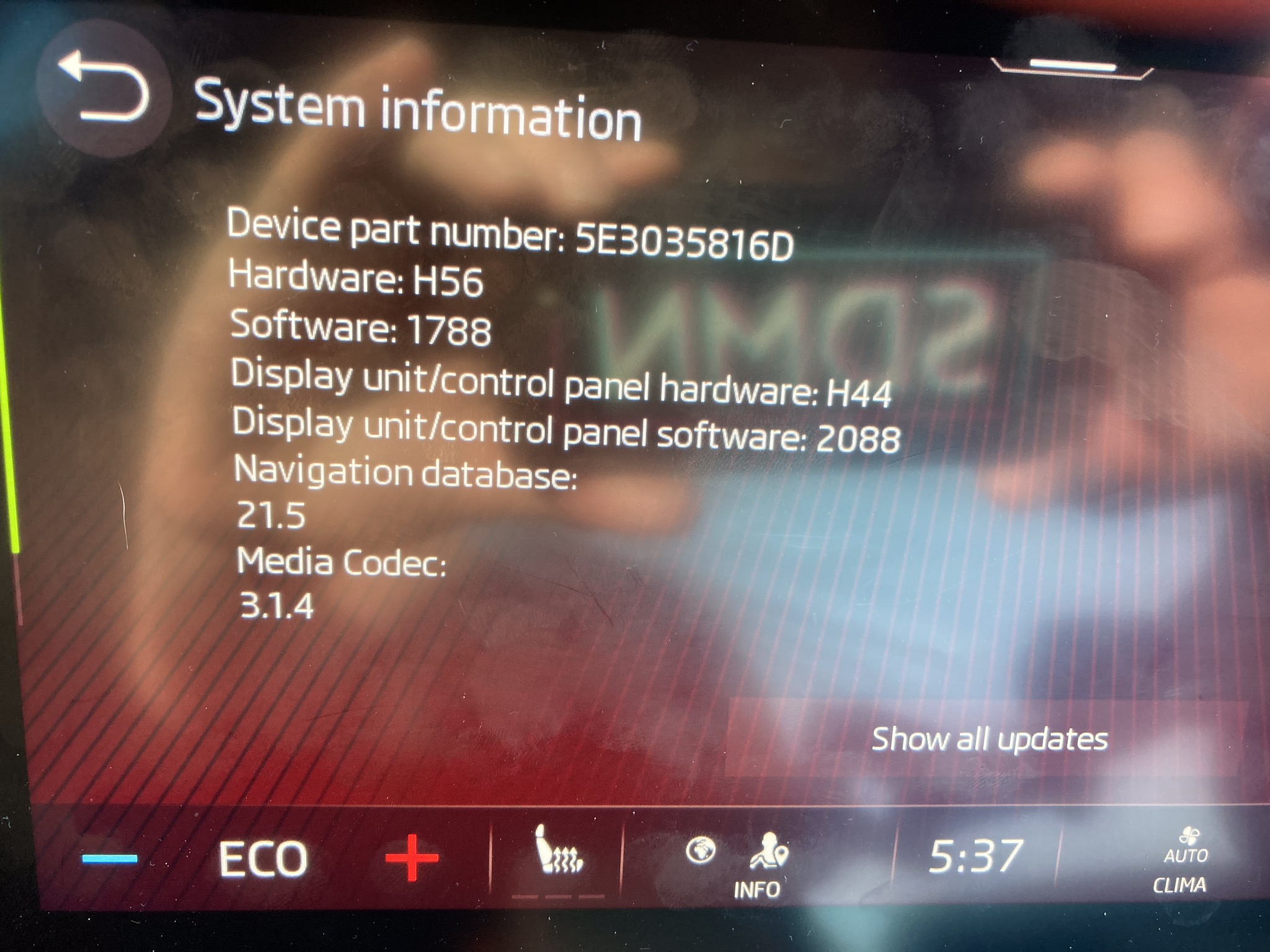

Here’s my settings , purchased a week ago, ex demonstrator so assume it’s all up to date. Although I did have a black screen the other day, it reset after 15 mins parked up.
