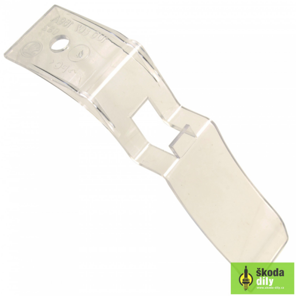

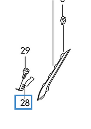

Did the fitters transfer the plastic ticket holder from the old screen to the new or was it included as part of the new windscreen?
As far as I am aware it's not attached to the windscreen but screwed to the A post.
Edited by Urrell
when i had a new screen here in france it was just a push fit, perhaps held in place by the screen glue!
Skoda parts book show the ticket holder screwed to the A post
