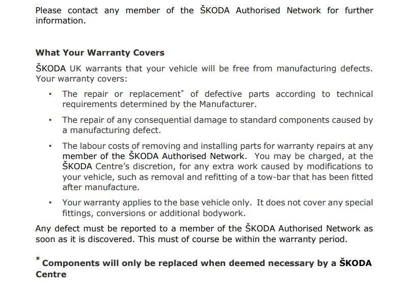

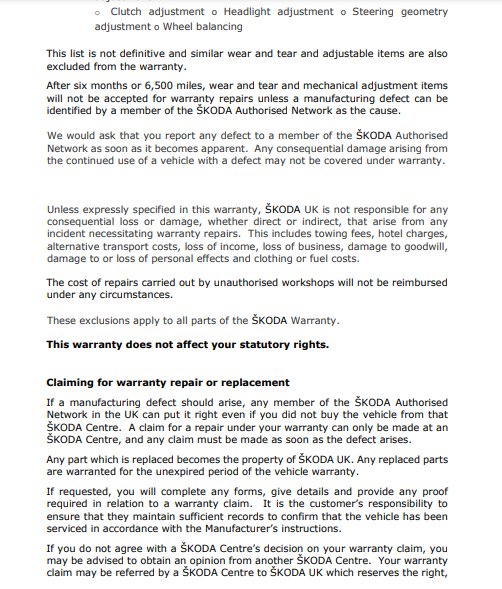

The Warranty requires you to take the vehicle to an Authorised Repairer.  Not necessarily to where you purchased a New Vehicle.
The Warranty provider can authorise the work under warranty or allow the Authorised repairer to decide if it is Warranty work or the vehicles owner will be paying for work.
Forget about Importers and read and understand the warranty terms.
SKODA_Warranty_Terms_November_2021 (1).pdf
Best to Read and Understand the Warranty and that includes 'Exclusions'.
Also your legal rights in the UK.
