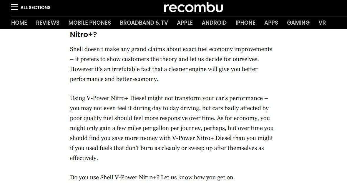

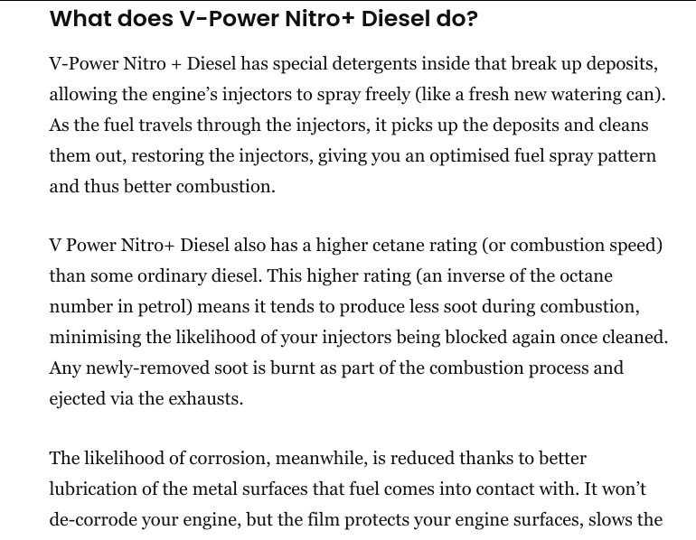

So do you think there is a benefit to you running a TDI on Premium Diesel over standard Shell Diesel or any others including supermarket, and do you pay for your own fuel?
Is it better performance and fuel efficiency you get with the Premium Diesel which has no higher a Cetane?
As far as I'm aware it does have a slightly higher cetane rating, about 2-3 more. But, this depends on who you listen to. All I am able to gather is it's able to do a more complete combustion due to said snake oil additives, thus meaning a potential for the DPF to have to do less work. That's the theory
Yes I pay for my own fuels. I'm more than happy to put V Power diesel in my car because of those snake oil properties. I'd sooner do that than try to mess about mixing in quantities of additives. When I had my tranny van and I was up and down the country working away, I was forced to use BP ultimate diesel (much to fleet's dismay) as the normal diesel wasn't working. Anyroad, after probably around 50 miles, you could see the odd puff of visible fumes on take off if you did a little traffic light GP. I would say it did drive better, albeit is a t280 swb mid roof tranny. I am convinced it did clean out some of the 'crap' and make it drive better. This was before I took ownership of my VRS TDI. So when I started driving it, I was more than happy to pay the, call it, £7 a tank premium.
But we're digressing from the OP's original point

If a Cetane was showing on pumps like the Octane does with petrol then there would be no doubt.
Royal Dutch Shell do not mention a higher cetane.

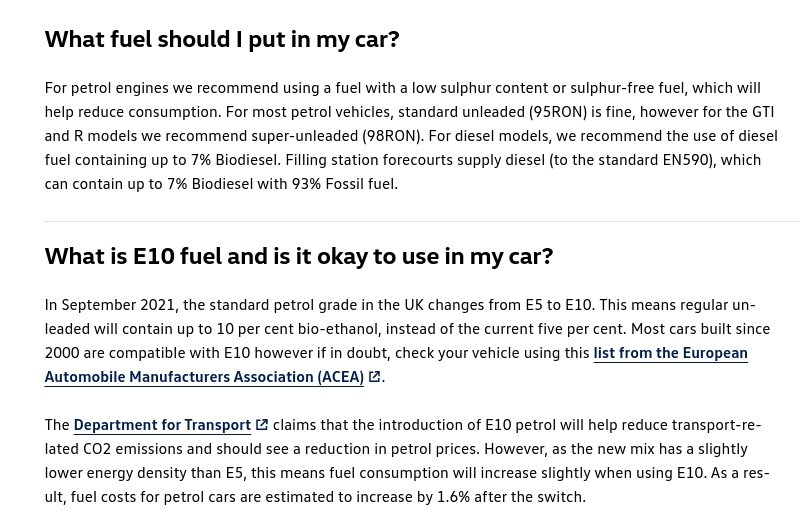

If it makes you feel better, in my Golf R, mixed driving  with a fair chunk of urban, and not driving hard, just the occasional burst onto a slip lane I get about 320-330 using VPower 99!
Motorway, longer trip 70mph (may be a little more), maybe 400-420 miles.  I have put 95 in it before and the range was slightly reduced, it is not recommend for this engine (Golf R) but with current fuel prices and the premium shell charge for V Power I may have to experiment a bit and keep a brick under the right go pedal... Haven't tried E10 95, my experience was before that in May 2021..
https://www.volkswagen.co.uk/en/need-help/need-help-faqs/fuel.html
VW Recommend 98 Super for R's & GTI's for lower emissions. so that is 97 or 99 ron min Super Unleaded in the UK.  (That is for a more efficient engine if it means a cleaner engine.)
But your cars that were sold & are now sold was tested for the old tests and now with the WLTP / RDE & RDE2 on 95 ron Unleaded, and that will have been E5 and now might in the future have to be E10.
The UK Government should have the testing done again in the UK with E10 used.

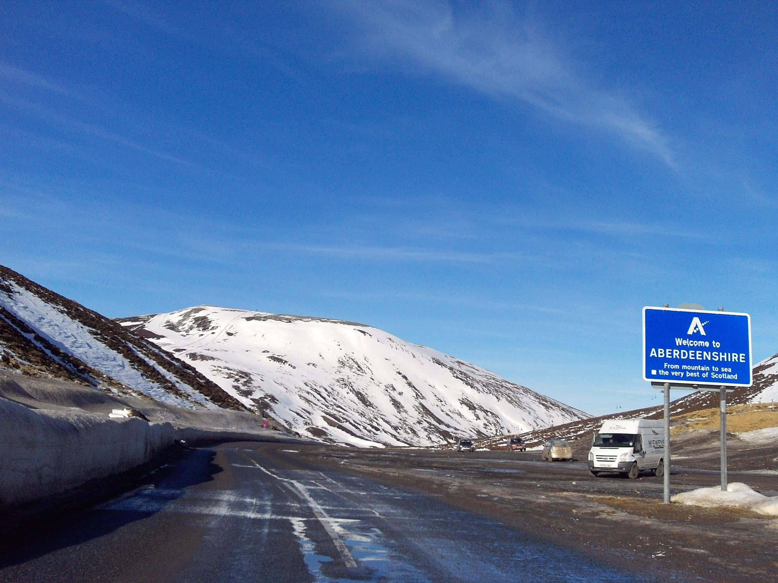

Shorter journeys in a Diesel and colder mornings and a TDI taking 6 miles to have the coolant getting to 90*oC and around 15 miles to get the oil to temp is rather different from a TSI.
I ran a 2016 SEAT Alhambra 2.0 TDI SCR DSG for 3 years and over 40,000 miles.
Apples and Pears there with DERV vehicles.  I know exactly when the Winter Grade Diesel arrived at the filling stations i used and how the efficiency changed.
It did not drop if the temp at the start of October was the same as at the end when Winter Grade diesel was in my car.
I keep an accurate record of every purchase of fuel, price and miles per litre achieved, always have.  Sad but I take photos to keep a record as well.
http://briskoda.net/forums/topic/455627-skoda-petrol-consumption-poor
http://briskoda.net/forums/topic/457520-petrol-prices
I very carefully and accurately monitor fuel pre First Winter Fuel delivery then the after the change and using it..
Also temps. and am doing the same trips several times each week at the same speeds and in the same time.
Lots of Average Speed cameras, and trip from the Sea to the Mountains and Mountains to the sea indifferent seasons.
I also do lots of journeys on the A77 at just above sea level along the coast at various weather conditions / temps.
