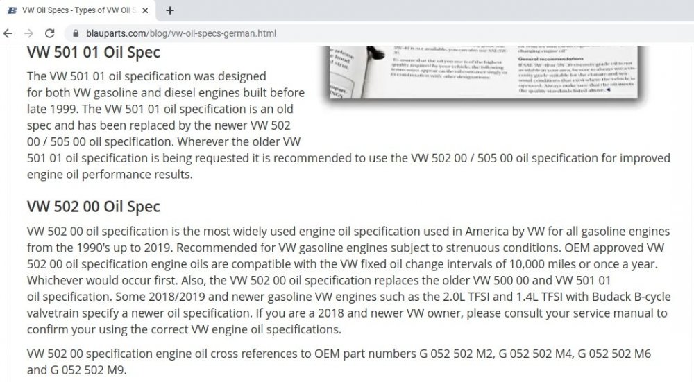

So VW 504 00 / 507 00.
  VW 504 00 for this age of TSI, Fixed or Variable servicing. 5w 30 FS III   (that is long life.)
Or if you want VW 502 00  so 5w 40 FS.    This is the spec if you can use for Fixed Service Oil & Filter intervals with a TSI.
That was how VW Group were showing the recommended oils by 2014.
Below what show as far as VW505 00
