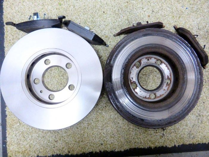

This is one of the rear discs I replaced on my Fabia, looked OK from outside but when changing pads this was the state of the inside of the disc and more than worn out pad on that side.
Edited by Urrell
If the pads/discs are worn more on the inside that could indicate a sticking caliper, although because Skoda cars tend to use one piston sliding calipers they might wear more quickly on the inside anyway.
