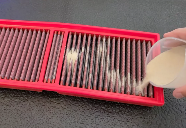

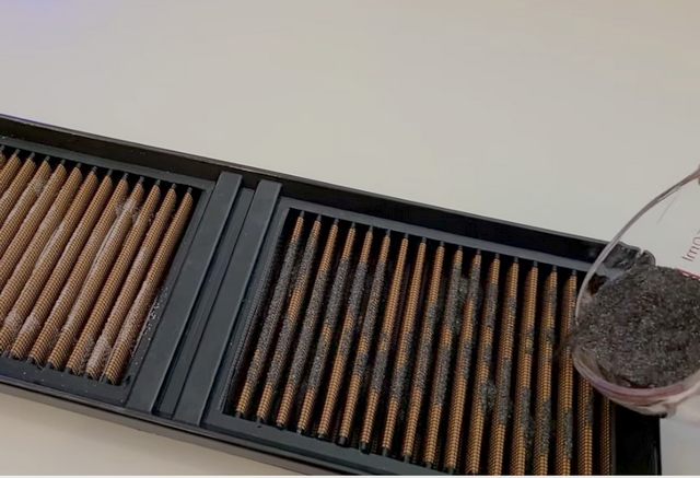

Do performance air filters like BMC, K&N, Sprint let more sand and dust than OEM and is it worth it?
We looked at automotive air filters and their efficiency on the Alfa Romeo Giulia and how the OEM paper filter compares to the cotton gauze style K&N or BMC filters and the single layer synthetic filter like the Sprint filter.
Although hitting a filter in a hard surface isn't the best way to test the permeability the results were unexpectable.
For sure in different conditions the results would be different (more scientific) but i think you will get the idea.
I've seen this video, this video would make you worried, but you shouldn't.
Let me explain why, first of all i've fitted a sprint p08 on my car.
That test doesn't tell anything, you are puting a extraordinary amount of foreign material on the filter, more that it would ever be accumulated by all your air filters combined.
Secondly the oil style filters will perform much better in such a test as the oil has time to adhere to particles.
The sprint is a very fine mesh so, it simply seperates out particles above its micron rating.
Thats why sprint has 3 types of filters.
Filtering efficiecny of the p08 is as follows.
100μm = 93%
80μm = 70%
60μm = 34%
40μm = 0%
Of the p037 is
37μm = 93%
25μm = 70%
15μm = 34%
5μm = 0%
Of the p08f1-85 (race filter)
100μm = 95 %
85μm = 70%
75μm = 34%
65μm = 0%
That honestly is excellent filtration, the p037 can and WILL match paper filters, while flowing 10X as much, the p08 flows 12% better than the p037.
So for normal use the p08 is perfectly fine if you are rallying go for the p037 and if you want to have to retune the car go for the p08f1-85 as it flows 300% (yes 3 hundred percent) more than the p08...
