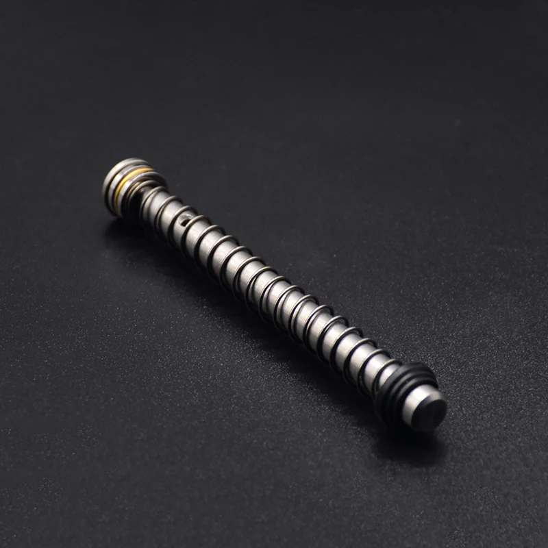

The thermostat with the pin pushes the rod and opens the flap and when withdraws the flap goes back to normal position (which closes the cool air).
Hot air->thermostat warm->pushes pin->rod goes front->opens the flap.
Since has wax inside soon or later there will be a leak and the rod will not moved (front or back) and will stay in one position and ''game over''.
The rod is something like this:
P1-Steel-Bearing-Re-entry-Spring-Rod-Sta
In the end has a hook and it grabs the flap so it controls the movement (Front-back).
