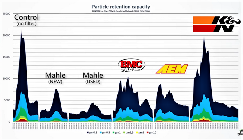

That test doesn't tell anything, you are puting a extraordinary amount of foreign material on the filter, more that it would ever be accumulated by all your air filters combined.
This guy with Skoda does the test better and at 8:02 says something very interesting:
"People are not buying filters like these for their particle retention capabilities"

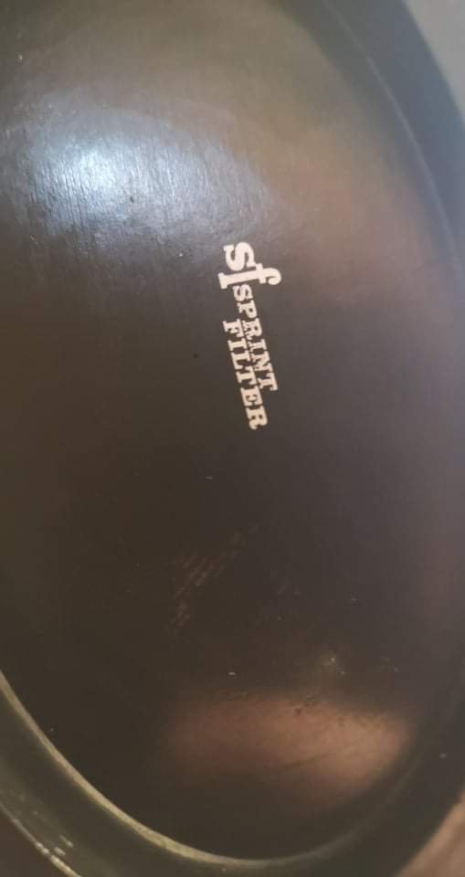

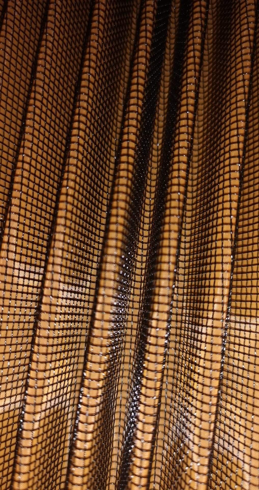

Sprint is like aem. Maybe a tad better.
You should understand what can and can't harm your engine.
I feel safe with the p08 more so with the p037. I don't know why you are getting so upset.
True and very interesting and informative video.  The red oil applied to the K&N filter is to trap particles and like the paper collects more over time.  When I first knew about K&N they had that the filter could be used for 100k-miles (160,000kms) in normal conditions before it needed cleaning, then at some point it dropped to 50k-miles (80,000kms).  It was always said by some that the K&N filter was better when used than when new, I must admit I never understood this but perhaps they meant filtration.  On the other hand the gut that had the Dodge Vipers (8l, V10 truck engine in them) moaned that they needed to clean the K&N just about every year to maintain horsepower.
I can totally understand that modern cars with all their computer programs would just adjust requirements based on the amount of air coming in and why perhaps the paper air filter on my wife's 2015 Fabia is four year service interval change.
My car uses carbs, you adjust them manually by setting nuts and screws by turning them, once you have set them you hopefully leave them set for years (until all the changes in petrol - unleaded, E5, E10).  I know the two different K&Ns filters that I have tried on my car even after cleaning restrict airflow when fitted from no filters.
It must be remembered my engine design dates back to 1951, 70 years, so is cruder in finish than more modern engines, tolerances and passages are wider.
As the chap said in the video the air flow capacity of the carbs and filter(s), on my car at least, are oversized so even when modestly uprated there is still plenty of spare unused capacity.  Think of it like drinking a litre of beer as quick as you can, how many seconds - we had a local chap who held many records, he downed a litre in 1.3 seconds, what ever you could down in 1.3 seconds is your capacity so the rest of the beer is not required, 1 litre is too much capacity for your 1.3 seconds of drinking.

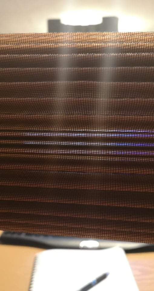

I had a K&N filter and then a BMC (plus a cleaning kit with that red oil inside) but they had the same problem, the plastic on the sides start separating from the main body, i tried to glue it but this didn't last long.
Was not a matter of abuse by me but it's not a coincidence that both filters had the same drawback.

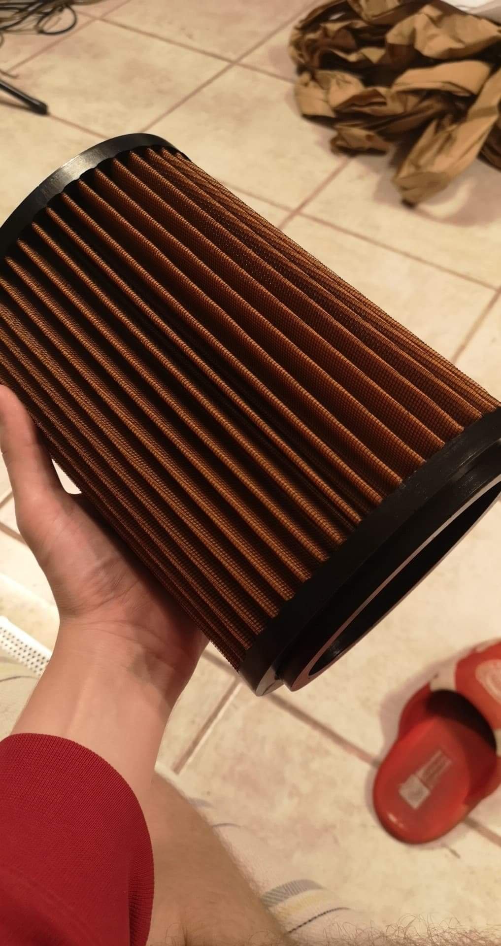

That is for the p037 the p08 will be much cheaper
Here is the BMC that i had for some years,maybe 15.000 km which i cleaned-oiled properly, not abuse it and trying to glue with specific glue the sides.
Yesterday i decide that ''enough is enough" and removed it, i don't think that i will use again a gauze air filter after the ''lesson" from K%N and this BMC.
This would never happen to sprint.

Are you sure it was a genuine part and not fake/counterfeit, same with K&N.
The K&N filter plus the cleanong kit was bought from the only authorized seller at that time. The BMC from a parts store (not from ebay) and the guy found the code for my car from a BMC catalogue in front or me.
Both had exactly the same isusue, the frame start falling apart, in both of them i used glue for plastics but in both of them after a while pieces started to detachmnent. In BMC some pieces stuck lige gum inside the filter box and another piece is missing because i throw it away plus there were many tiny pieces like fragments.
With such kind of support the frame has gaps and air unfiltered passes through.

That is the worst, sprint is exceptionally high quality thus the high price

Yes I agree in the beginning I did not trust them.
Then I did some research and they seem to be a league on their own.
So the price is justified. Imho
Just now, D.FYLAKTOS said:
This is it? 90 euro + shipping
Yes the Avg for the p08 is around the 90 euro mark.
For my brera I paid 100 for the filter but I bought it directly from sprint.

Greece is not USA on that matter, i bought the BMC filter many years ago and i don't have the receipt or the box (was before 2005, no forum-era, no e-bank records etc).
IF (i say ''if'') they accept it back to the store they will tell me that will send it back to the manufacturer, this will take lot of time and when they have an answer they will call me but i know that nothing is going to happen.
They put the blame on me (you expose it to direct sun, you didn't use the proper soap, you dropped it down, you glue it with inappropriate glue etc) and ''case closed''.
The fitting was gently as with k&N or the paper filter that i have used, no extra push etc but when i removed the upper part few days ago the frame starter to fall apart ! The main frame of this filter was so fragile that i have lost the amount of detridus which were inside the air box. Was like cheap foam which gets dry all falls apart lin every touch.
2 times with different brands exactly the same problem plus every time when i was removing it lot of trouble to wash it-let it dry for a day-spray it-wipe the excess-check for spots which don't have oile-wipe again and back to the car.
No oil area? no good filtering. Too much oil in an area? Drops back to the MAP sensor.
Gentlemen, i think i am done with the gauze filters.

I was thinking how small that air filter looked - or have you got big hands.
Edited by nta16
Dimensions are: 27,4 x 18,4 x 3 cm
