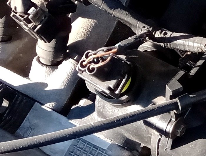

Even more perplexing is the photo below - the black wire and whatever happened to it and the plastic on the connector plug - has someone done a connecting bodge on the wire and its connection to the connector pluh?
I would be looking at the wiring going back from this connector and check the wiring and any wiring and connectors back from it.

I can understand the insulators going stiff with age and the environment they are in but the wires look like they have been hacked at and what I marked with the blue, purple and orange oval makes no sense other than perhaps bodging.  I have already put what I would do, all seems strange to me.
You and Thefeliciahacker will know the difference between the blue and yellow sensors I do not so no idea if it makes any odds.
Whether changing that connector and its wiring makes any difference to your figures I think it was a good idea to change it anyway.
to me it looks overheated...

I searched in my archives, i have photo that all the cables are bent but i can not explain why they were so rigid, even now the plug can stand upside down like a spider because the cables are like tree branches.
By the sensor with Yellow ring? By the engine bay? Hmm...
Must affected the signals otherwise i can not explain the immediately change on the instand fuel consumption at cold start.
I have found and older photo of my engine bay, i crop the part which shows the cables already be bent. Later became rigid and with that ''abused'' look.
That does look over short.  Should the wiring harness perhaps be supported to lift it higher, had the wires to the temperature sensor been shorten, surely all is not as from factory?
The plug is original with VW code on, i haven't touched the wires-pins etc for 22 years.
I have changed some coolant sensors yes but never ''mess'' with the plug except that maybe me or a mechanic while working pressed the cables down with his elbow.

In those three photos the wires appear to be a bit longer (and a lot longer in one photo) plus the big branch of the harness is supported and held up but a cradle type clip so the weight of the harness and wire to temp sensor are supported.
In your photo the wires to me appear to be below and stretched with barely enough length on the temp sensor to disconnect the plug - but as you put perhaps this was at time of photo because the harness had been pushed down as I see in your later photo with new wire length and protection that the harness is held by the cradle clip.
Looking at that photo did though also draw my attention to how tight the wires looked going to the coil pack.
Also what is the unclipped electric cable going over the the throttle cable that runs along with the wiring harness there and could it not be a cable-tied or wrapped to the harness and go under the throttle cable.
