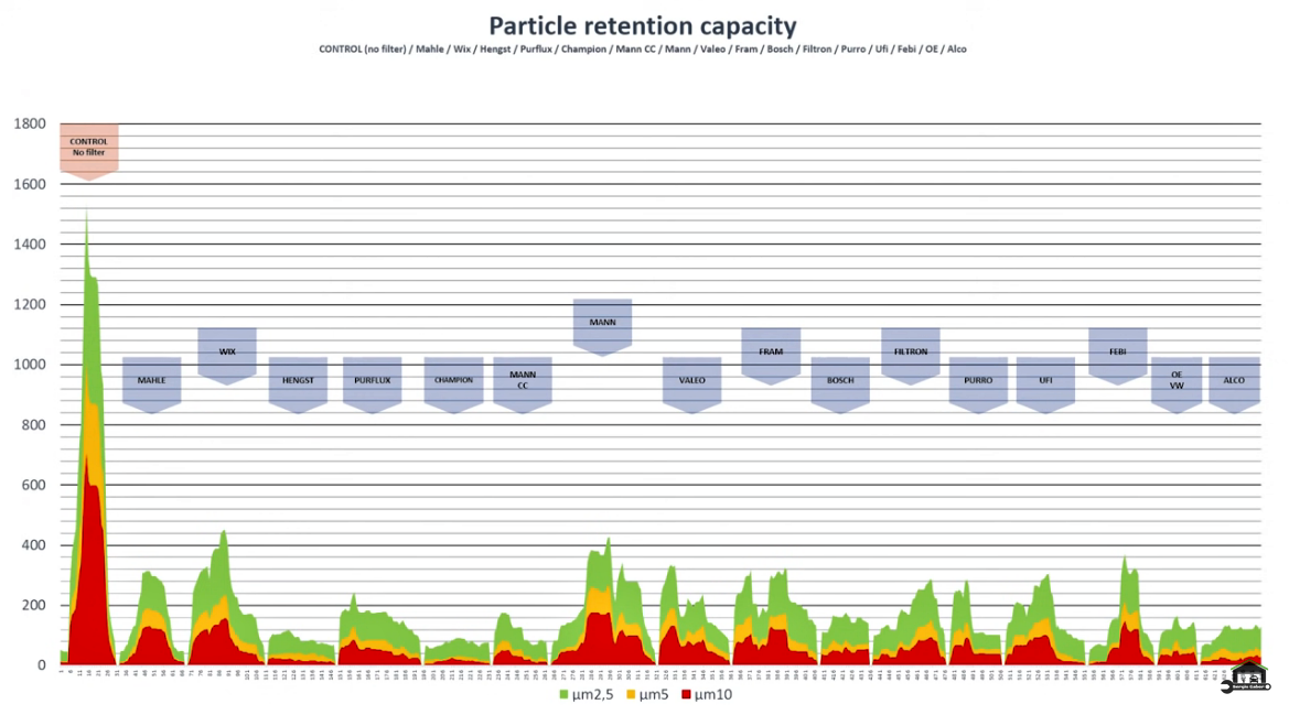

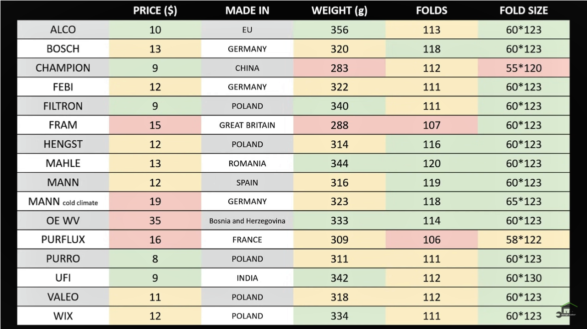

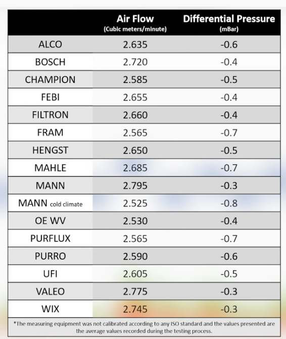

This is an excellent video for Paper filters only.
These are 3 screenshots from this video, very informative and i will have these in mind when it's time for the next filter change.
Interesting video.  I am not sure the chap has much knowledge of production of parts like these and package labelling.  Production quality can depend on who is running the machines that produce the filters, who is maintaining the machines, variabilities of materials and such more more.  Newer machines set up correctly with experienced operators may be better than more worn machines and/or less experienced operators.
Having the correct size is a different matter and the one from India being wrong is no great surprise, I expect the Champion one made in China may drop in quality as the contract or personnel change in the future.
For the frame shape having curvature I would have thought this may not matter if it is a good fit in the housing as it is clamped so would straighten, if that is what he meant.
As with any product testing for such low cost items it would be best to takes samples from different batches, be interest to see the same filters bought and tested 6 months later, I would expect the better designed filter to remain so but the rankings for the intermediates could different or closer or further apart.
As he said production of the same product may from different factory locations so could vary and possibly but I do not know production of different brand and labelled products, not necessarily these filters, could be from the same factory machines.  Buying on the internet the product may not be the local one to your region but for elsewhere.
A couple of car parts companies whose products I know have production in Poland.
As for the Fram box stating the product was made in Great Britain, it might have been, I do not know I would be interested to know if it was, or perhaps it was just packaged here for some reason of finance or even politics.
Concentrate on the two or three filters you can get that you think are the best and forget the rest, the matter isn't that critical.
