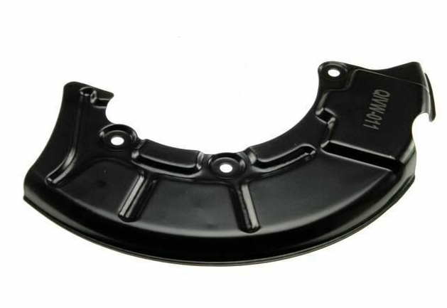

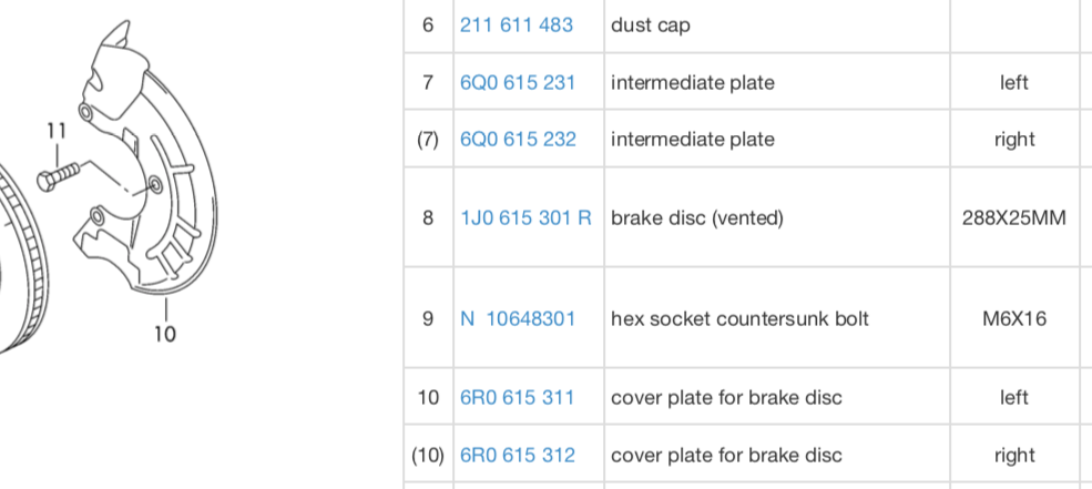

Having now stripped my calipers and am sorting a shopping list it did occur to me that stepping up a disc size the existing dust shields are going to be now too small and bind.
It's not the best idea to remove the dust shields / splash shields so has anyone swapped on say some Octavia ones? I've looked through a couple of swaps and those people have just removed em.
Octavia Mk1 above
Fabia above.
Thanks :)
No need, your standard shields will be fine.
Oh they will fit. Good! Shame they're rusty! 😛  Would they Octy ones fit were I buying some new ones?
Probably.
Have been running mine without shields for years with 312mm discs on the front. shields rotted about 5 years ago.
I'll have to have a look at the state when I take the discs off. You should run them really, keep the dirt/muck/water off the discs.

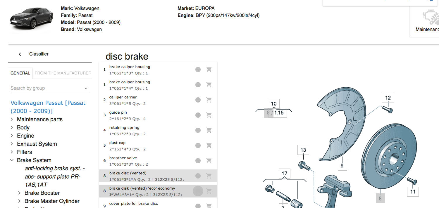

I'll throw my 2 cents in here.
With my 312s they do have proper sized heat shields but they're off some form of passat and were made fit. I had a mechanic fit them and left off new 288mm heat shields, he wasnt happy to fit them so kept them aside and put ones he found would work on. Would have just kept the original heat shields but they were stone rotten so needed changing anyway.
Still have the originals and the ones I bought sitting in a box of 288mm brake bits.
So, after a quick search, brake shields of a Volkswagen Passat B5 2001 - 2005 look like they're 312mm discs so maybe it's those. Interesting.
336719253_ScreenShot2021-12-02at01_46_49.thumb.png.4d8977b97315c82e99bc0b18ac50aaf3.png
OE NUMBER 1K0615311F
I hate to sound like Captain Obvious but why don't you just order a set of shields from a TT instead of yet another different VAG platform, at least the TT definitely has the same hub carrier which is why the brakes from it fit the Fabia.
16 minutes ago, Carlston said:
What's wrong with using the standard cover plate?
I dunno, but any further input here is probably superfluous.
As long as they cover the bigger discs I'm stepping up to the what I've got should be fine, they're just a bit rusty! I'll find out when I come to fit the stuff. Just waiting on parts and the powder coaters to let me know the calipers are ready to be picked up. So I'll update when I've got some pics to show you!
