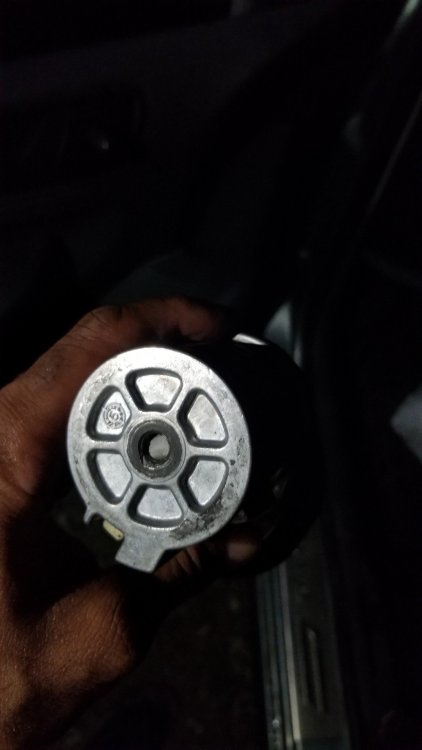

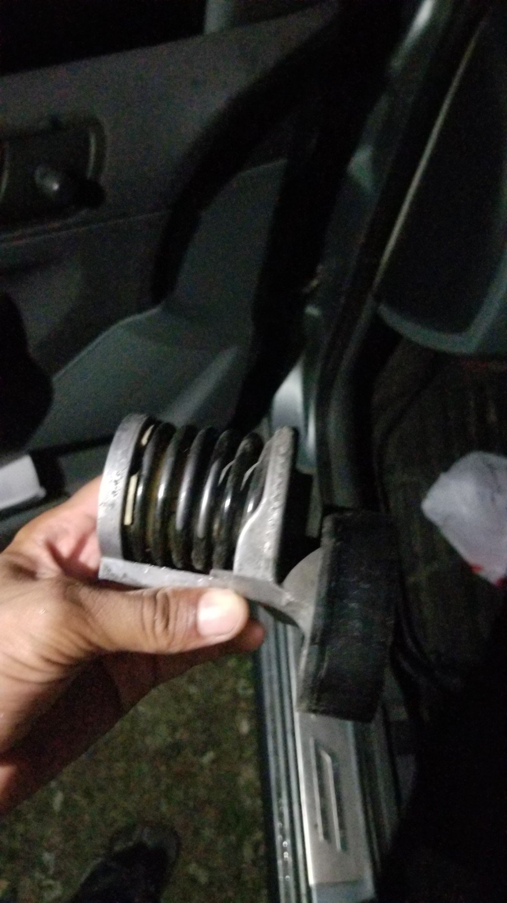

I am 250kms away from home and the bolt of the belt tensioner (the pulley)  just broke.

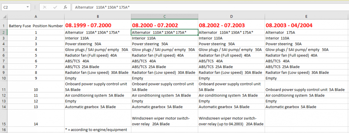

Or you can unbolt it from the big strip fuse on top of the battery.
I will send you a pic later about those fuses
That fuse is a 50A but a quick search has brought me up fuse 3 from the left then I saw Fuse 5 from the left - This is not helping !!
What year is your car as there are small differences- really need to check a wiring diagram for your car to make sure !
Lads posted this many moons ago but its for a TDI
It is a 2002 diesel sdi fabia
Should be strip fuse number 3
It changed to fuse 5 on cars from 2005/2006.
