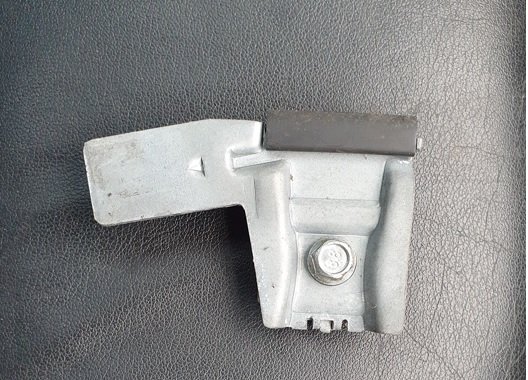

Well I changed the glass again back to the tinted ones !
With the glass out of the door and looking in the gap at the top. I could see the clamp - By getting the extendable magnet down in and picking up the clamp then pushing the loom aside with a welding rod with my other hand it came out the top of the door
The picture below is what it looks like ! so I knocked it out rather than loosening it too much ! I got hold of one from a 04 Leon but it was totally different.
It had come out of the plastic piece which is driven by the cable along the runner - A quick check of HatBoy Harvey confirmed
I can see where it has to go but you cant get a right grip of it to reinstall it in the clip - So a lot of swearing and blinding and chat about drilling out the rivets of the window mechanism again!
So I again put the glass in the front clip[ as kids had to be collected !
I have ordered a very long set of pliers with a 90deg tip so I can reinstate the clamp in the clip
Im getting quite prolific at taking the door cards off😄
It's impossible for that part to just fall out which suggests the plastic runner has broken so I'm afraid you're going to need to take it all apart to fix it properly otherwise it will probably jam and break your regulator.
Was just going to say the same - been there done that!  I'd be getting the runners changed before it all gets too late and the whole mechanism gets knarled up.
No need for a diagnostic, that little triangular indentation in the clamp is the detent, in order to remove the clamp you would normally have to shove a screwdriver into the plastic runner to lift it over that triangular detent.
Lads - Thanks a million for all the replies and sep for that very clear picture of the runner and clamp - There's deffo no way that can come out without the plastic getting broken !
From working with classics I'd guess that the plastic has got brittle over time.
Ahhh well I have to resign myself to the simple fact that I will be replacing the carrier and drilling out the rivets - I will replace with tech screws and I'll do both sides !!
