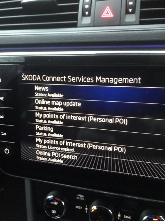

I was wondering if anyone has a solution for the issue I have with Skoda connect.
I have a duplicated licence in the infotainment online services for Points of interest one is valid the other says no licence .
This would not be an issue except that when the system tries to upgrade the maps a licence expired notIce comes up. This seems to be related  to invalid licence in the poi’s .

i took the case to the ombudsman who after around 12 months ruled in
my favour . Skoda UK said it was a software issue caused by a Third party i.e not them The dealer who refused to admit any fault but was ordered to replace the MIB control unit . I had no faith in them at that point . I took a cash settlement and had the unit reflashed by an independent vag technician  who told me an update had been interrupted and not properly cleared before starting again hence duplicate licences . The guy who did mine is no longer around but east Yorkshire retrofits have since done some work for me and maybe able to help . My unit still shows an invalid licence but the updates now work . Never got the Media Command working again as Skoda don’t support it in the uk anymore so cannot get the app on y new phone or FEC restored without hacking the system and as it’s still under warranty didn’t want to do down that line .
