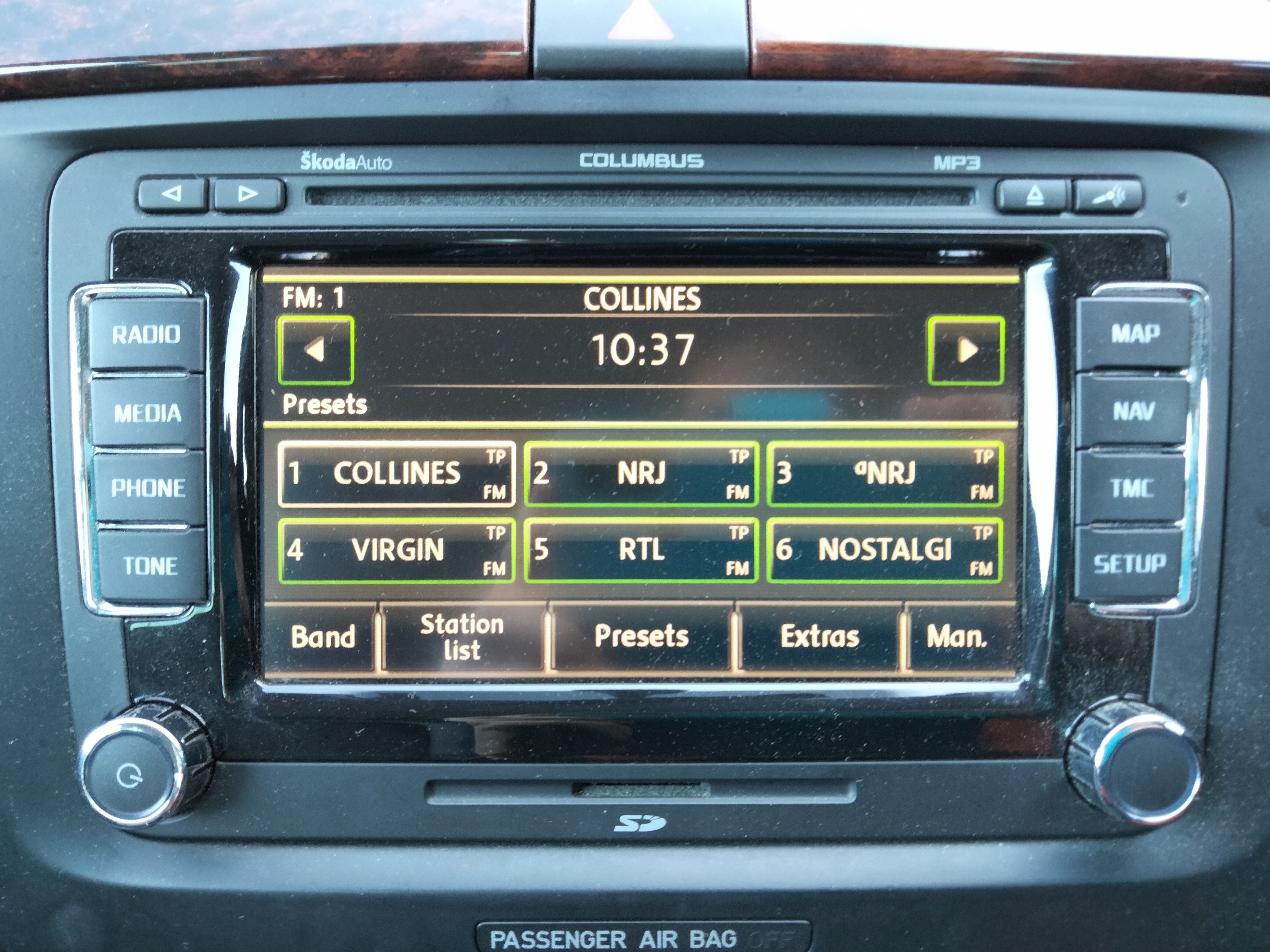

Hi Rustynuts
TIMG20220219103913.thumb.jpg.adaa0c5aa485eda0f4d8f8ea97b95ae2.jpghank you for your reply.
I have attached a photo of my unit.
This morning it has stayed on, maybe because the sun is shining.
Are these units affected by the weather?
If you are able to repair the unit are they posted to you or what?
