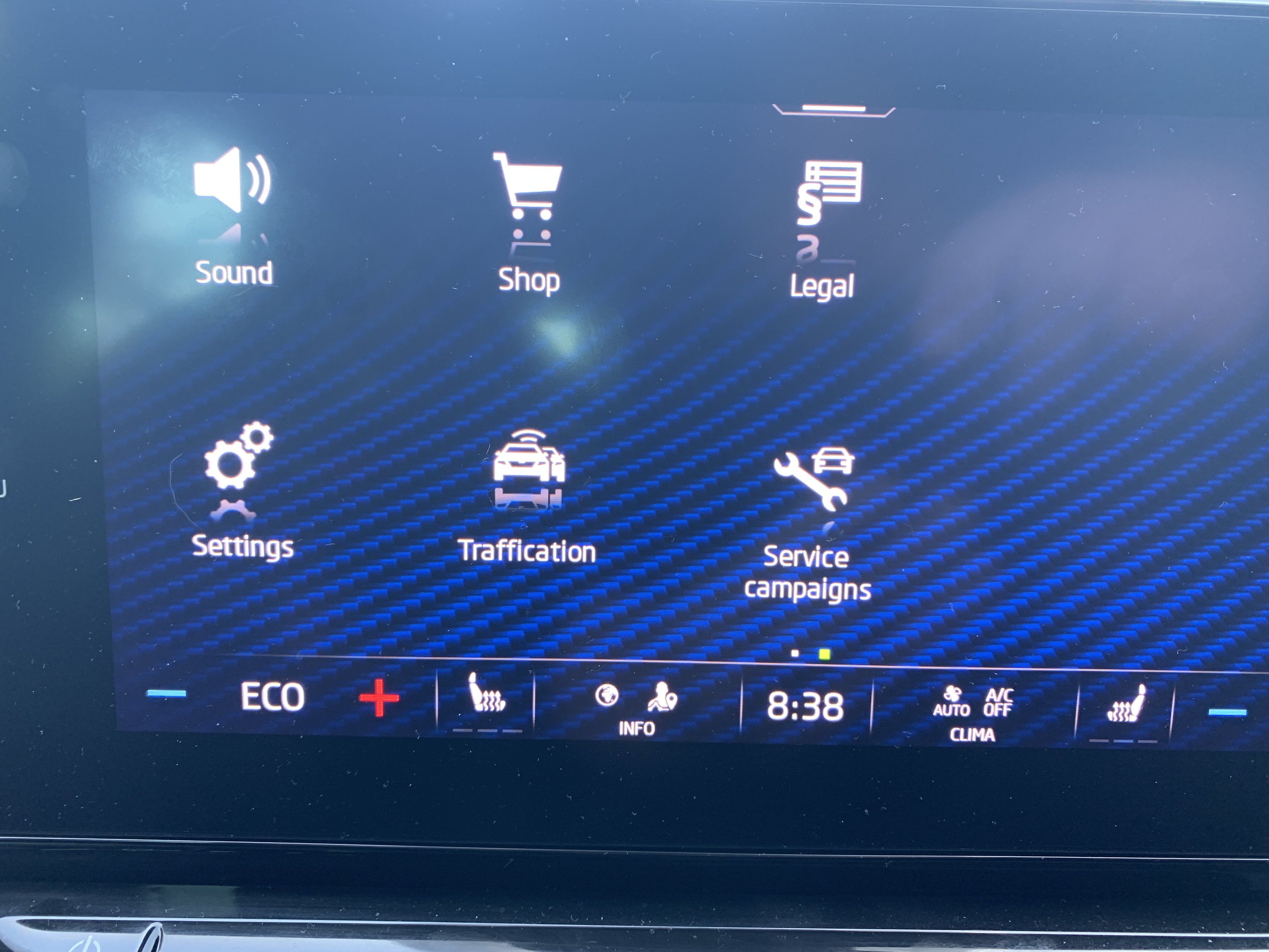

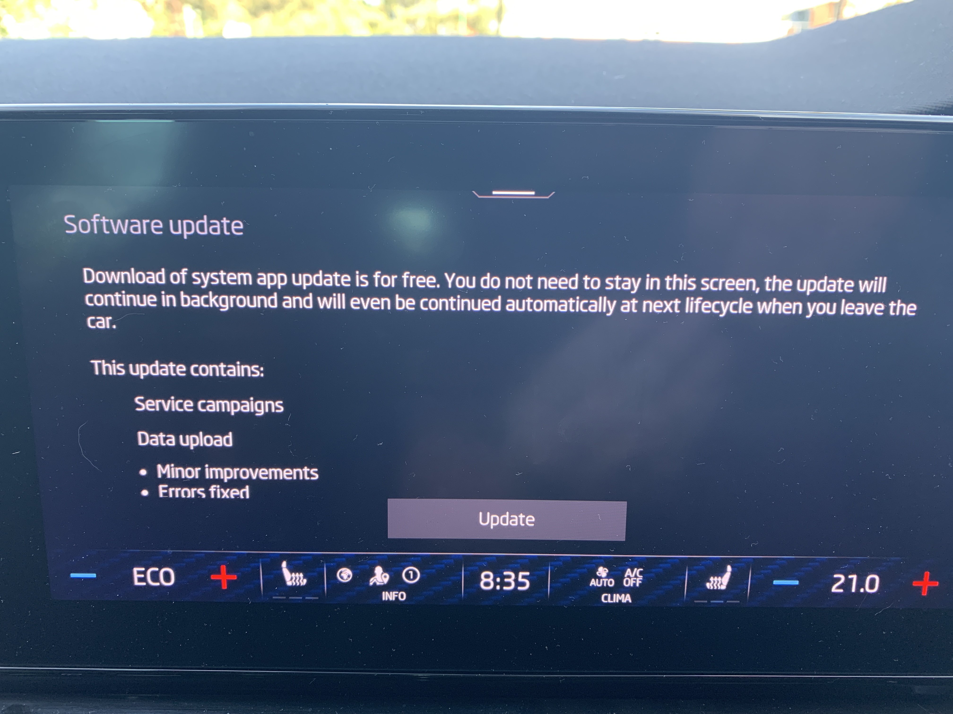

Just had another over the air update which has introduced a new icon on the menu, “Service Campaigns”. I’m assuming this is to facilitate the main update we’re all waiting for.
Edited by Gjones71
