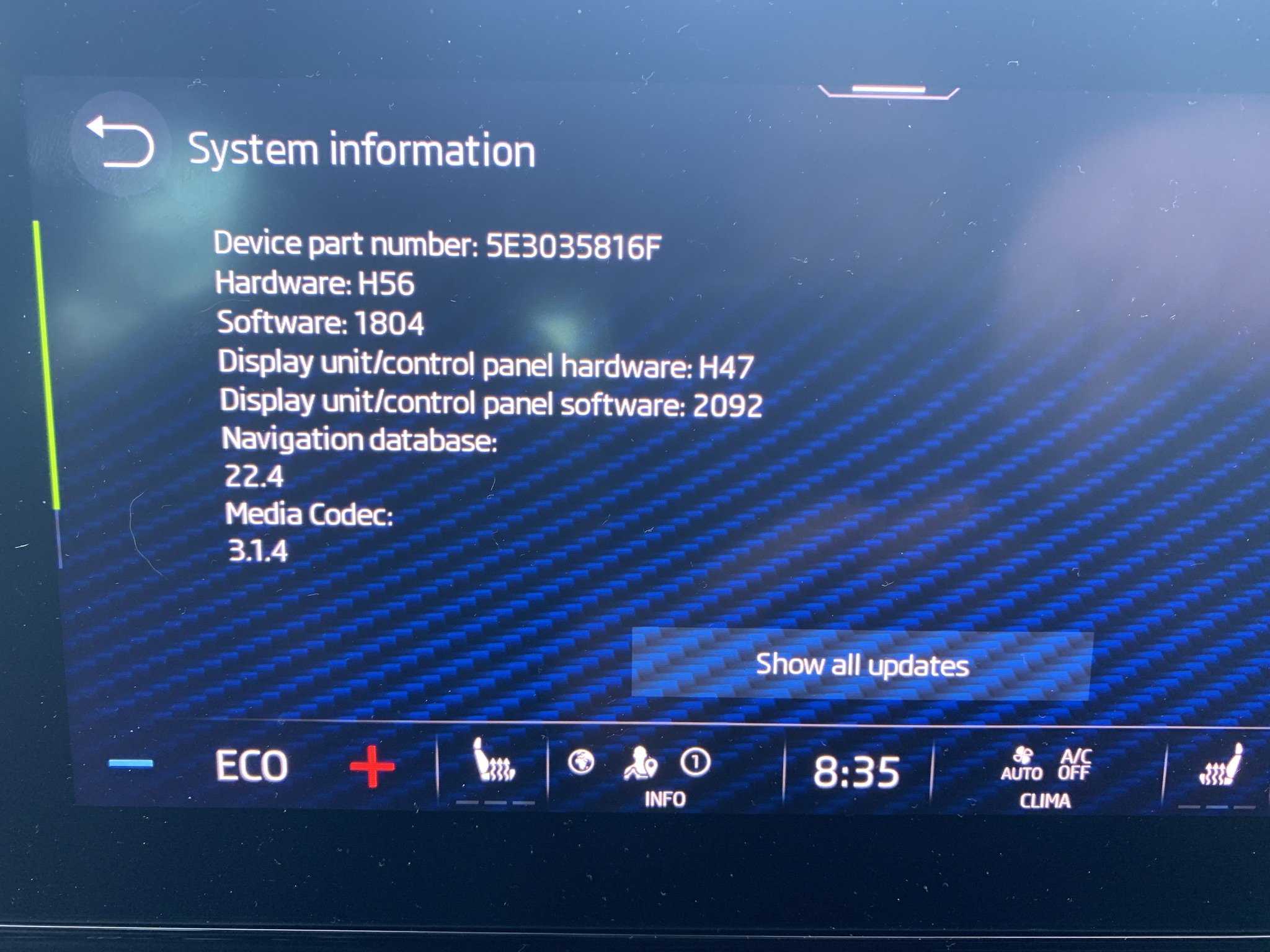

I don’t know if it’s me or if the dealership I’m using are incompetent or they are taking the  pud but I’ve just got my car back from apparently having its update done and… nothing has changed. Still on SW 1804.
 How come others on here are being notified the update is available but when I talk about it to my dealership they look at me as if I’ve just crawled out of a piece of cheese?
i feel I need to speak to the mechanics directly. Any ideas?

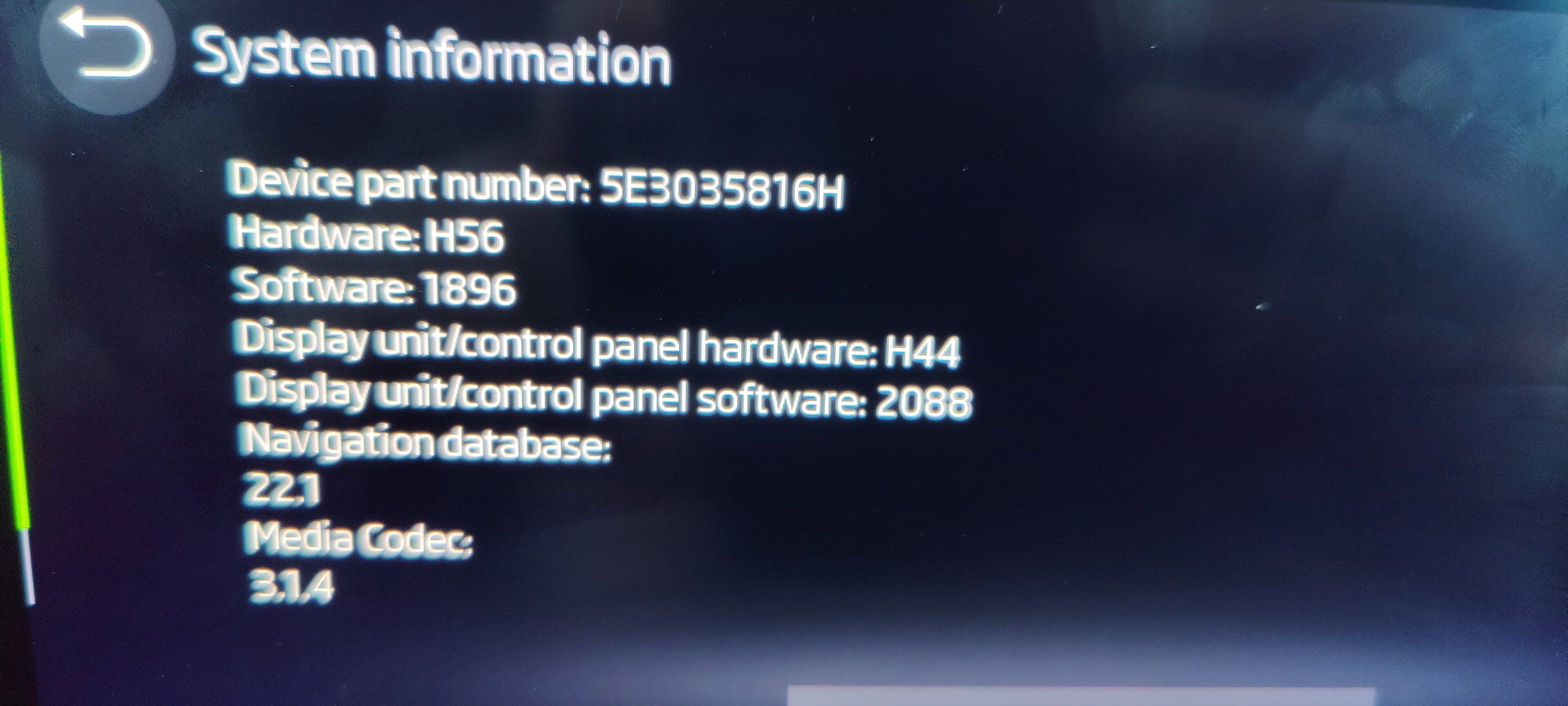

What's the rest of your versions? I've attached a pic of mine, it's on the latest firmware. I understand some of the older hardware can't take the latest firmware, ask them to confirm with Skoda, they will know what firmware is allowed on your hardware.
Here’s my versions. Interestingly some of mine are higher than yours!?

Looks like they've not released the latest display unit firmware for my hardware version yet, the new car I'm getting is hardware version between yours and mine and has the newer firmware (giving my car back because of a load of other faults with it and getting a different one) but yes your hardware version is same as mine, so I'd believe it should have the new firmware, 1896 is the latest

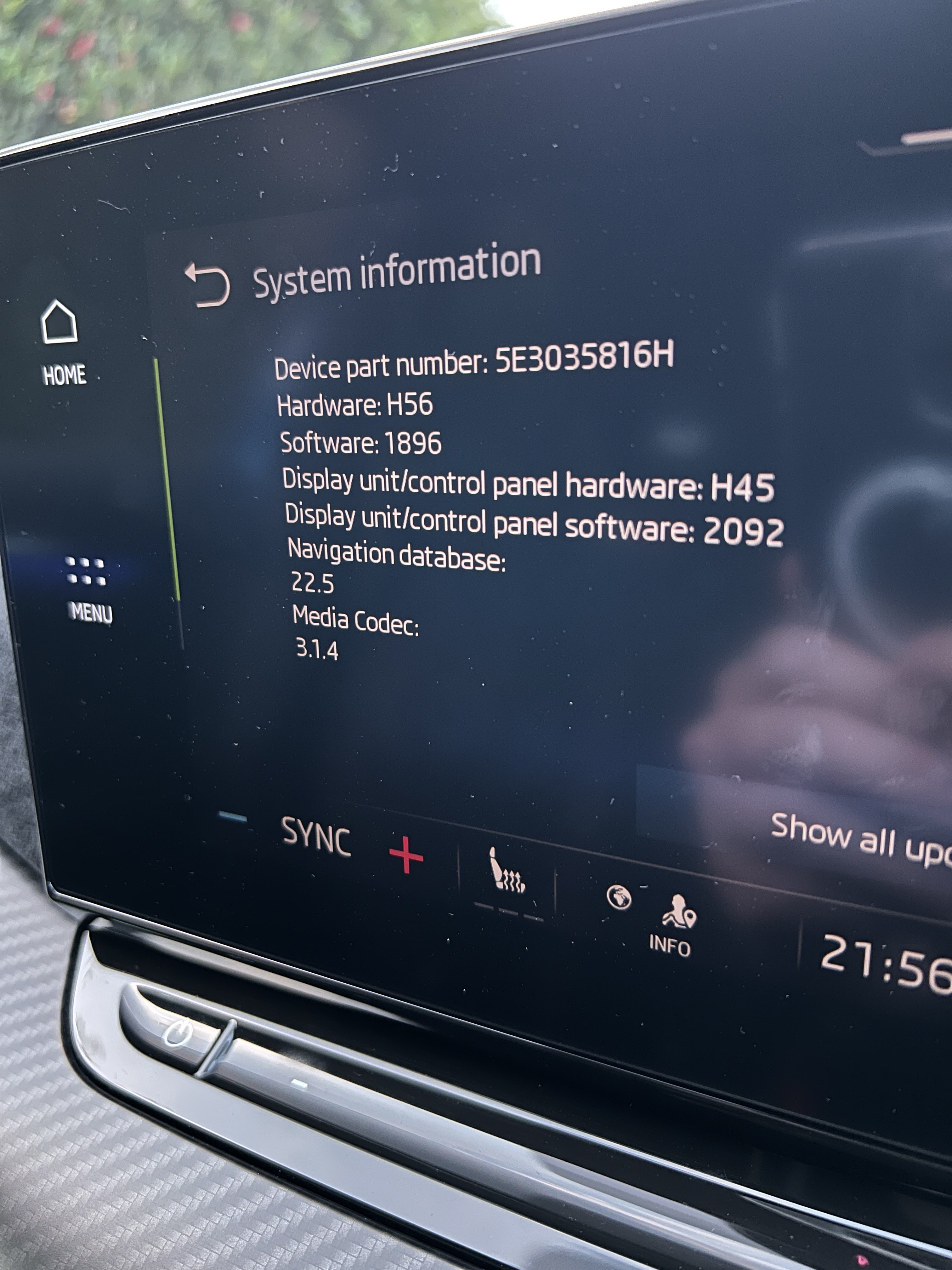

Sounds like it potentially has different issues with different hardware versions. My display unit is H44, after ignition off and on the word sync disappears, pressing the right controls changes the right only, but if I press the left controls it maintains the sync (until I press the right, then it turns off fully). My replacement car the sync stays on after ignition off and on is H45 (edited as put the wrong version) hardware.

This is what I’m on. Wonder if there is a setting the garage needs to alter.
You have the same part number as me but a different hardware revision, the hybrid I'm getting has a different part number but the same firmware, so could potentially be something else different.
