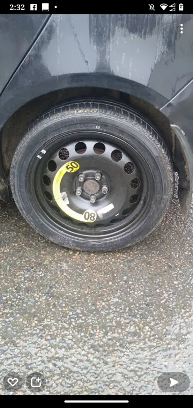

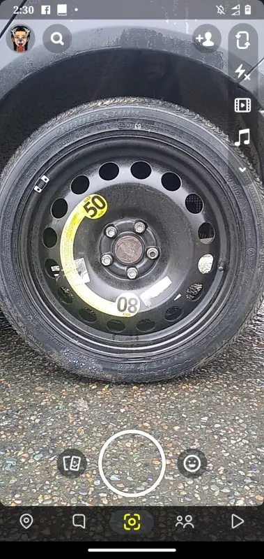

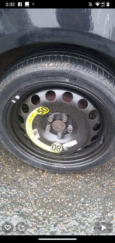

have took some pictures of the tire:
 From memory, I think you may find an inflation pressure moulded into the sidewall. Is there anything on the pressure chart in the fuel filler cover.

It's a space saver, inflation pressure is moulded into the sidewall.

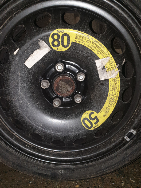

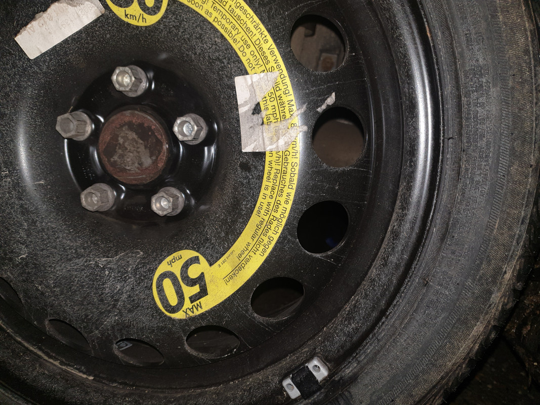

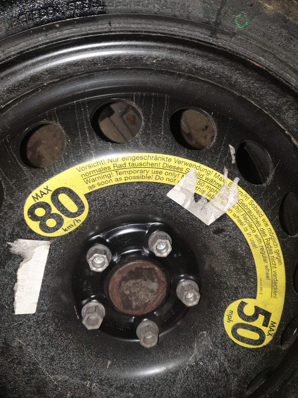

ok, took more photos:
it says 63, so im guessing 63 psi?

It's not that critical, just pump it up until it doesn't look 'soft' and squidged at the bottom.
