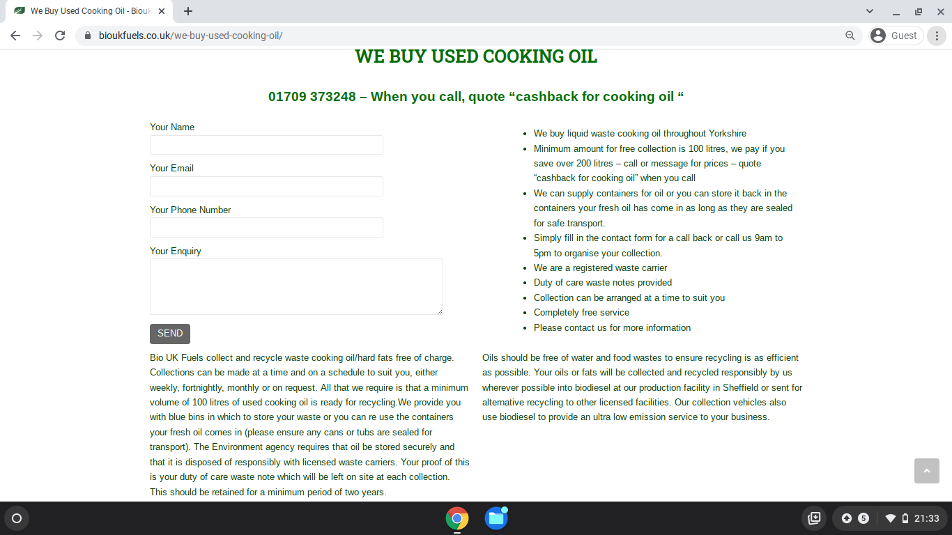

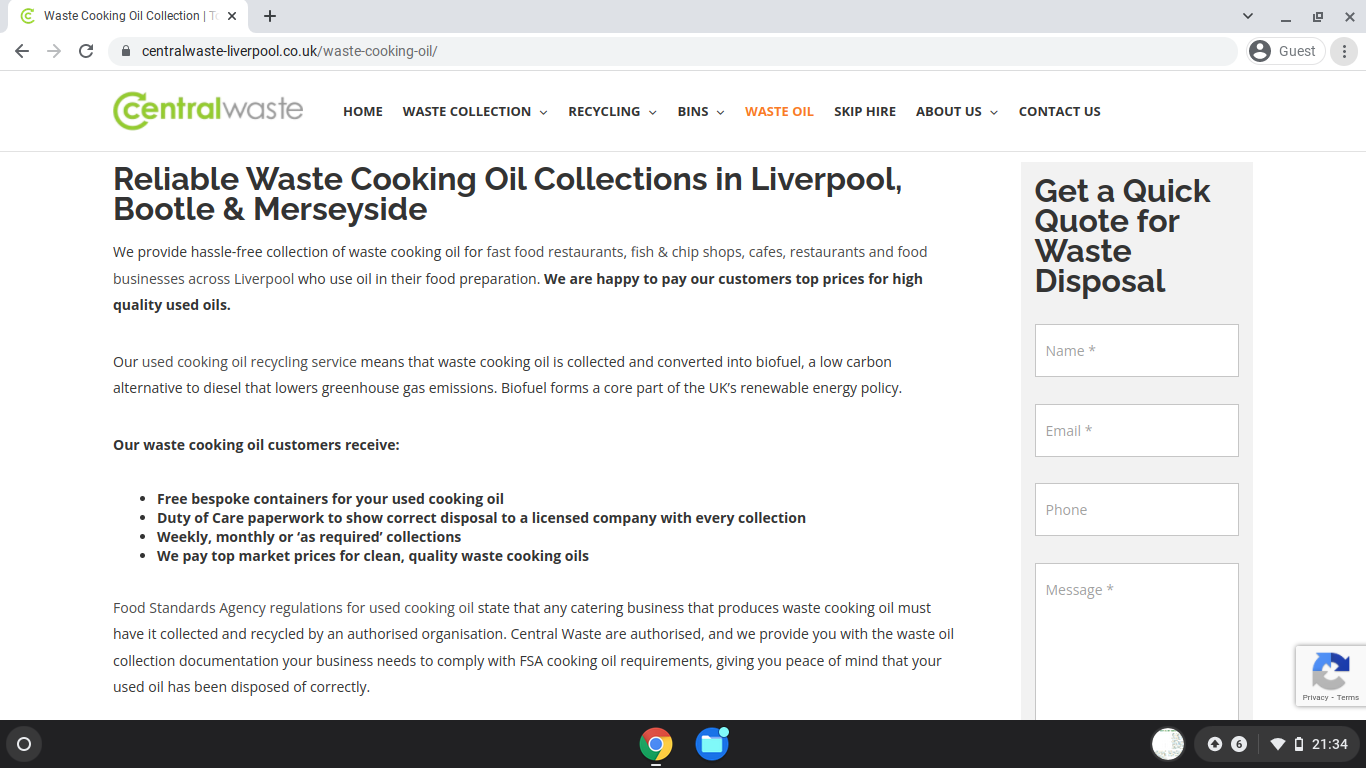

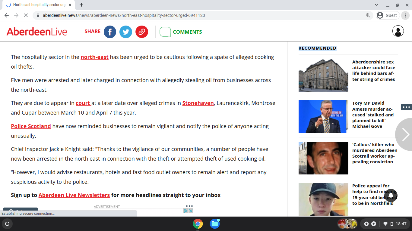

Tonight i am reading a warning on high value products in my general area.
Used Cooking Oil.
