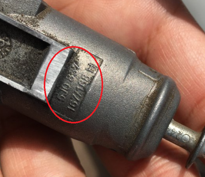

This image pinched from the thread you linked earlier Keith shows that at least one of the raw casting parts appear to be ambivalent/ambidextrous before they are assembled  (alternate left/right part numbers both on it):

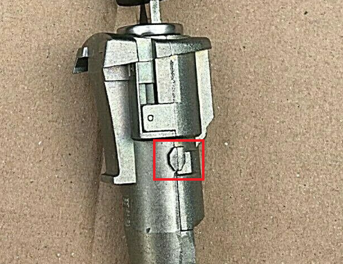

Some nice clear photos in this ebay listing of a 6Y0989168E right side one here: Skoda Replacement Door Lock + 2 Keys - 6Y0898168E **Genuine New Skoda OEM Part** | eBay
If anyone fancies staring at them for long enough to spot a difference between topside and bottomside view??  I'm not seeing one straight away, but my eyes are old.

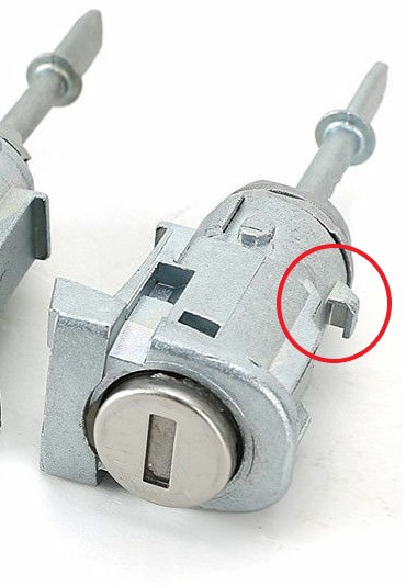

It's this bit that interacts with the locking ring within the door, if I remember right:

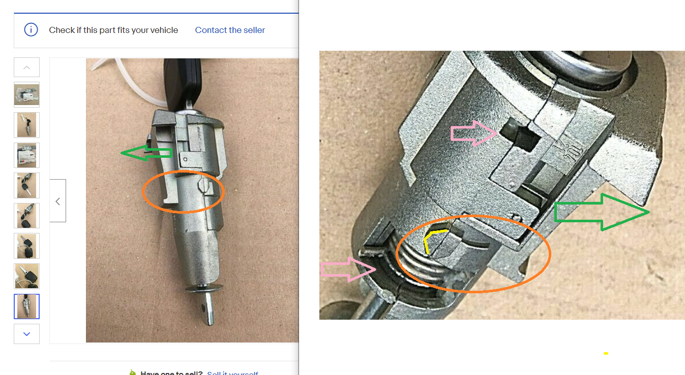

Well there are some glaringly obvious difference between top and bottom views of that (one, right side) ebay lock, arrowed in pink on one image, but it's the lock ring 'catching bit' details that are the problem I think.
If it were symmetrical, both views would have their yellow highlighted 'arrow' features pointing towards the front of the vehicle (green arrows on each view) but they don't here, forwards in left image, rearwards in right.
So I reckon that's why the locking ring is failing to release, because these features are facing the wrong way on both sides of the car, with locks swapped across.

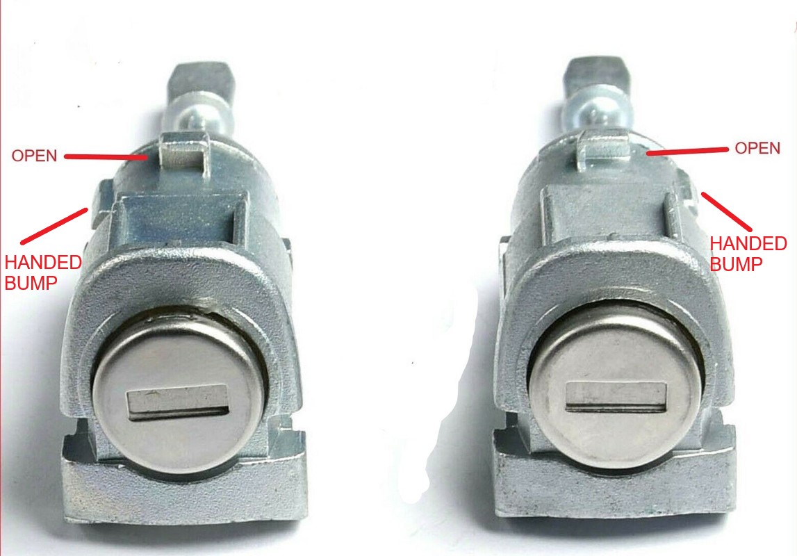

Not sure if this is the same thing that Wino is pointing out, but I was looking at (replacement) lock barrels yesterday and noticed that these 'hook' bits are handed....
Edited by TMB
Edited by TMB
  • Sponsor
Good spot Lee. Not the same as what I was showing, but definitely appear to be relevant.
