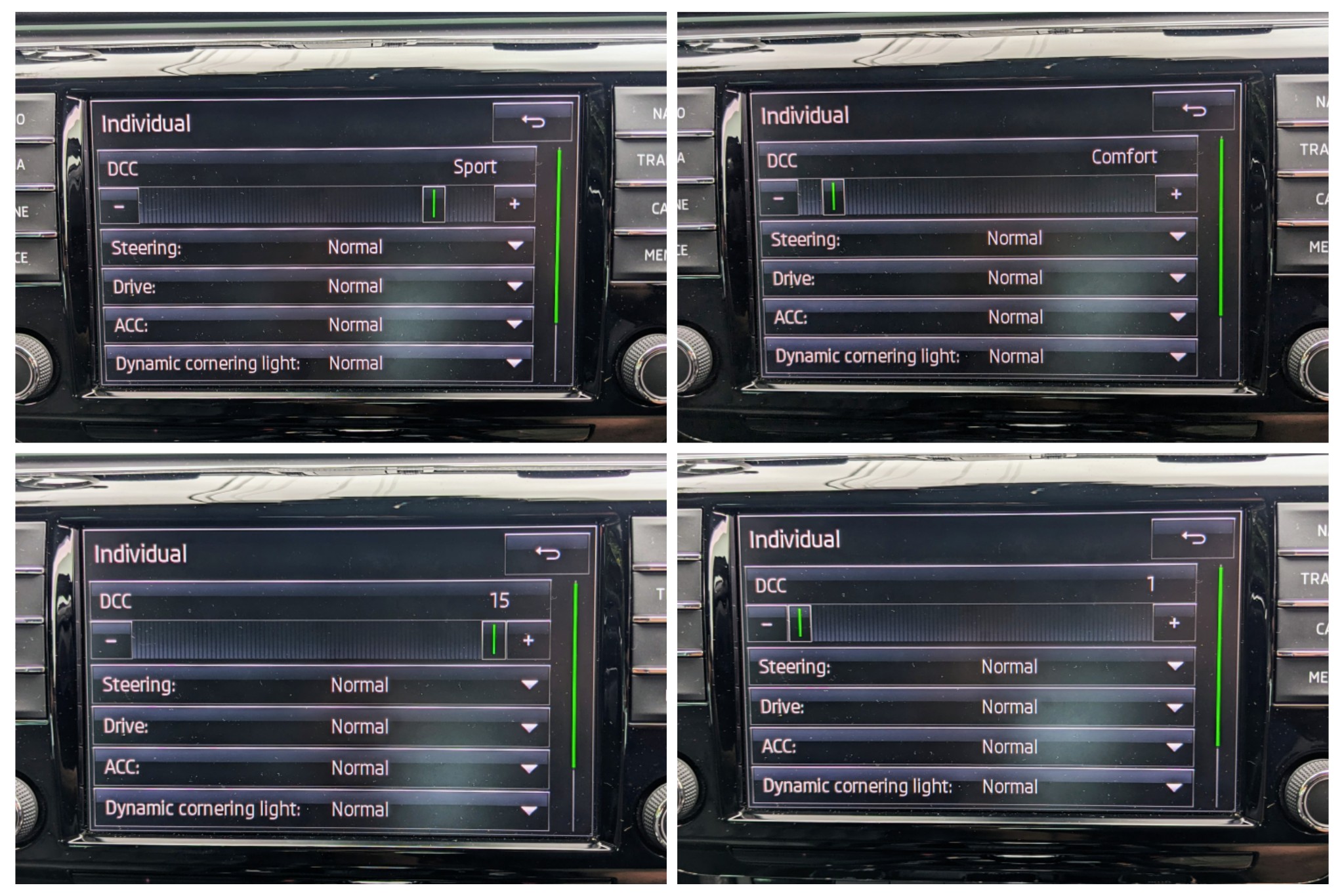

  • Well that was all surprisingly easy...   Flashed the DCC module:   Uploaded the Passat dataset (closest in size, weight and wheelbase to the Octavia):   I alr
  • Ok, with some serious help it's been done!   Here is the overall sequence of events that was encountered and followed: Original gateway was 5Q0. Most examples seem to use the 3
  • Original gateway was 5Q0. Most examples seem to use the 3Q0 gateway so I went and got one to follow the same path.
  • Swapped to 3Q0907530C gateway with software 4287.
  • Removed Component Protection and restored FEC using ODIS online.
  • Upgraded gateway software to 3Q0907530AC sw 4388 with ODIS Engineering.
  • Applied dataset 3Q0907530AC_Superb_3.xml
  • Extracted data from the XML file and modified to add 15 increment slider using the 'Full Example for DCC Index C with slider' on the GitHub page using the addresses given in the drive2 link and pulling the hex values from the GitHub example.
  • Note that the data for 'remember after reset' doesn't line up with the drive2 example (nor does the slider example, but this is more obvious from the github example as the data is just 0-15) so I copied the values from the GitHub example manually from 0x2E0-0x2EF.
  • Applied modified FPA data using ODIS Engineering.
  • Flashed DCC controller to 5Q0907376C and applied Passat dataset.
One unexpected benefit has been that Normal and Comfort setting ranges are no longer as bouncy/floaty over bumps and dips.
