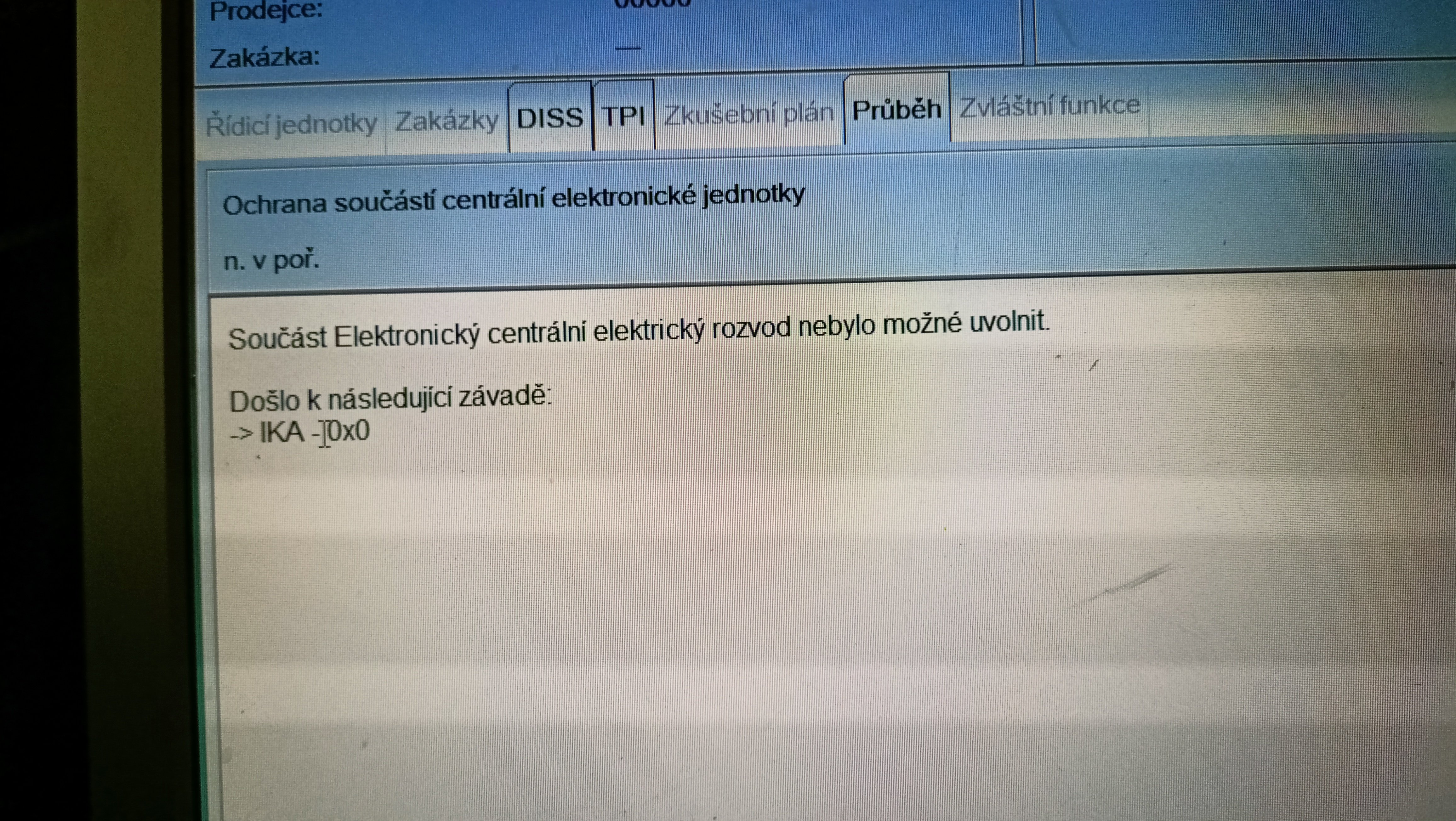

Hi, today I tried replacing the gateway from 5Q0 to 3Q0 and ODIS online gave me an error, CP cannot be unlocked. IKA error - 0x0, do you know how to do it? It was a 3Q0907530AR gateway. I don't know what the problem is, I tried the procedure on this page https://www.drive2.ru/l/677127914847740734/
and without success the data cannot be written when the CP is active.
Edited by Miliskot12

1 minute ago, zacko_O said:
Máš snímek obrazovky? A popiš postup.
Obvykle se tam vyskytují chyby FAZ***.
I replaced the gateway with a 3Q0, got Safe CP, connected ODIS S online geko, did 0019 gateway CP from the test plan and got the IKA error - 0x0, I also tried to remove each unit separately CP. I only have a photo from one unit when trying to remove CP. I can't find what the error means. I can only think of hacked MIB2 if it doesn't matter or flashed the DCC unit to version C and uploaded the arteon data set. Otherwise I don't know what the problem is. I use ODIS S 3.0.3.I tried to upload a backup via ODIS E from the 5Q0 unit to the 3Q0 unit but without success due to the active CP. I had the 3Q0 unit from the Passat 2023. So I'll try another version from 2019. I had the HW version 3Q0907530G there. It doesn't work in my car, it says this error. Now I ordered the 3Q0907530C version. Maybe this is the problem, otherwise I don't know.

I don't know if ODIS is bothered by hacked MIB2 or flashed DCC unit which is not compatible with the car, you can see from the photo which version I flashed. I will try MIB2 to play the software on the original factory Version 3342 VW G11. but I don't have the software from the original version of the DCC unit to return. Otherwise I don't know. I will try when the 530C gateway version comes. Otherwise SVM coding worked for me for the test, I chose the wrong coding for the air conditioning function Air care and ODIS SVM recoded the function back for me without any problems.so I wouldn't see a problem with the ODIS installation.

10 hours ago, Miliskot12 said:
flashed DCC unit
it's definitely not a reason of this error
