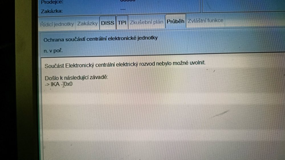

  • Ok, with some serious help it's been done!   Here is the overall sequence of events that was encountered and followed: Original gateway was 5Q0. Most examples seem to use the 3

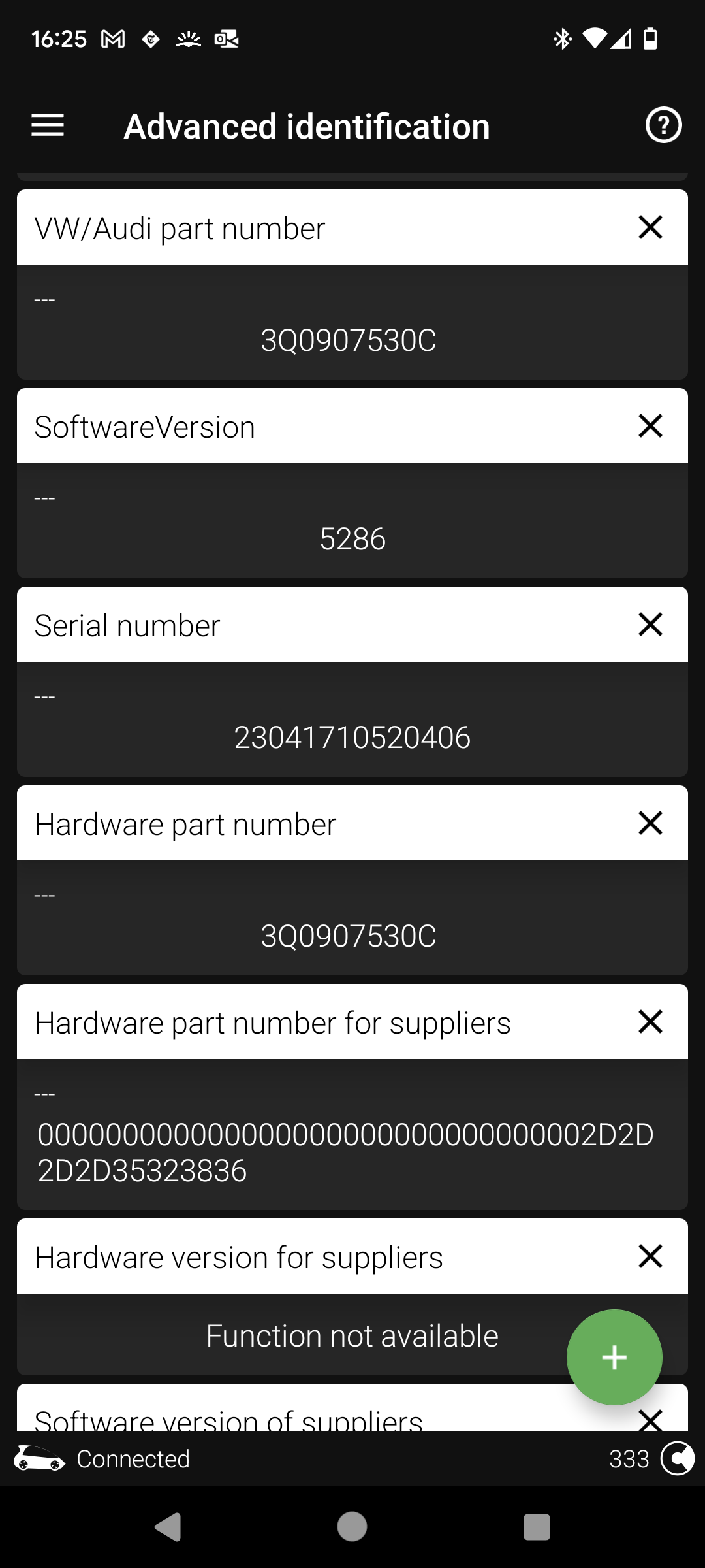

I've just started looking into this mod seriously for my 2017 280 estate. Going by your comments JR  am I right in thinking from the following I pulled off with OBD11 I wouldn't have to physically change my gateway or DCC module?
That is correct, given the current version of modules u have listed.

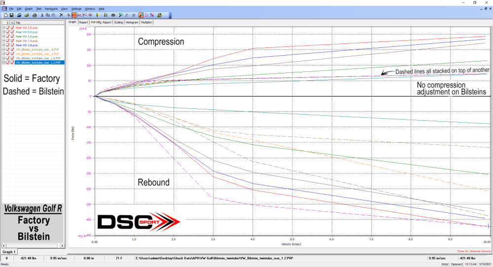

Thank you but not the part numbers. Someone done some bounce and rebound tests and recorded the results for different brands :) was trying to find them but I’ve lost them now
@ApertureS- u referring to this?
The test was done by DSC Sport in the US.
"We had some pretty interesting findings today when shock dynoing the Bilstein Damptronic B16's for a MK7 Golf R (part number 49-255874). We found the Bilsteins only are able to control the rebound, while the factory shocks are able to control both compression and rebound with their valving. This means the Bilstein Damptronics are a less capable setup when looking at compression adjustment, but still happen to have slightly greater rebound range. Basically the only benefits to the Damptronics are adjustable spring perches to change ride height and stiffer springs. But are not beneficial when looking at the "active" functionalities of the shock. This is due to the valve used in this specific shock, however in other Bilstein kits we have tested, like the Porsche Kit, the valve is different and was able to control both rebound and compression."

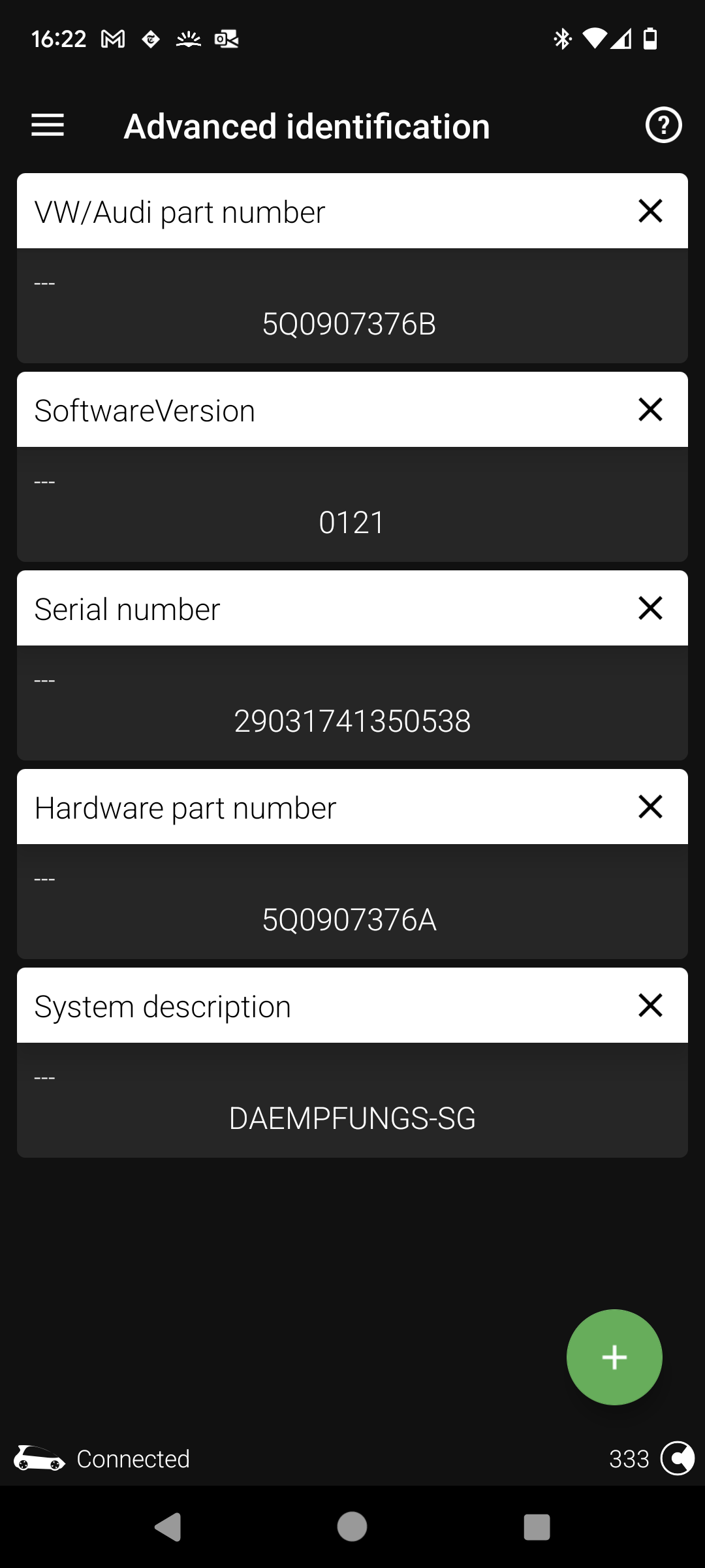

I want to improve my DCC settings - from 3 position to slider in Superb 2020.
But whatever I do I cannot change it to slider.
What have I done:
  1. Flashed DCC. From 5Q0907376B to 5Q0907376C.
  2. Updated DCC parameters to Arteon parameters.
    (I'v used original parameters from VCP library - maybe this will be cause of the issue. Maybe not all Arteons have slider?)

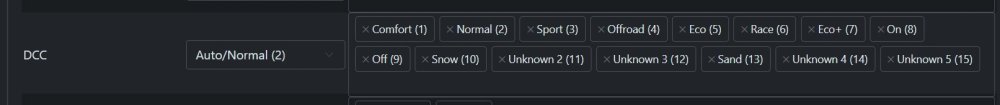

  3. Changed parameters in FPA Editor:
  4. Uploaded it to the gateway.
  5. Reset unit.
But still looks like this:
Do I need to change something more in FPA Editor? Or should I try with other dataset for DCC module?
*It looks like parameters for gateway are working - because I can change other settings - for example dynamic lights, sport diff...
@Frankenfurter @ApertureS @langers2k - maybe You  could help.

  • Removed Component Protection and restored FEC using ODIS online.

  • Extracted data from the XML file and modified to add 15 increment slider using the 'Full Example for DCC Index C with slider' on the GitHub page using the addresses given in the drive2 link and pulling the hex values from the GitHub example.
