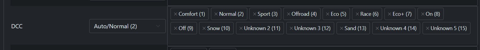

On 15/11/2023 at 08:50, Szogun said:
I want to improve my DCC settings - from 3 position to slider in Superb 2020.
But whatever I do I cannot change it to slider.
What have I done:
  1. Flashed DCC. From 5Q0907376B to 5Q0907376C.
  2. Updated DCC parameters to Arteon parameters.
    (I'v used original parameters from VCP library - maybe this will be cause of the issue. Maybe not all Arteons have slider?)
  3. Changed parameters in FPA Editor:
  4. Uploaded it to the gateway.
  5. Reset unit.
But still looks like this:
Do I need to change something more in FPA Editor? Or should I try with other dataset for DCC module?
*It looks like parameters for gateway are working - because I can change other settings - for example dynamic lights, sport diff...
@Frankenfurter @ApertureS @langers2k - maybe You  could help.
Looks like you already found solution :)
Anyway I can add details here
In addition, need to add all these values to Individual mode to show slider.
I've updated  5Q0907376A to 5Q0907376C just now
Edited by zacko_O
