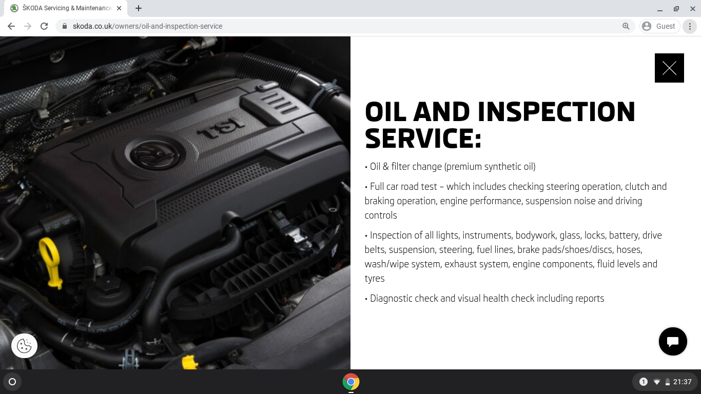

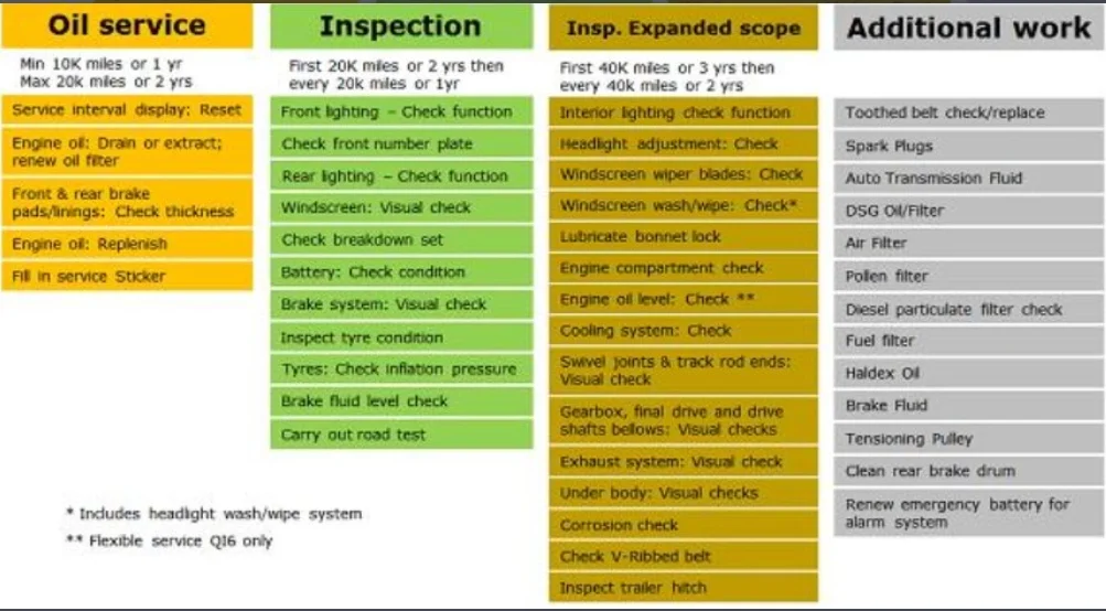

Invoices and paper records mean lots more to many buying a used car than Main Dealer Servicing that is no longer in a service book unless you get one and just invoices and receipts if you get that.
Full Main Dealer Service History can be a history of not very much being done and maybe not very often.
The impact on resale according to Dealers is huge, and when they sell you a car without a proper service history as you get even with Skoda approved used cars seemingly not an issue.
