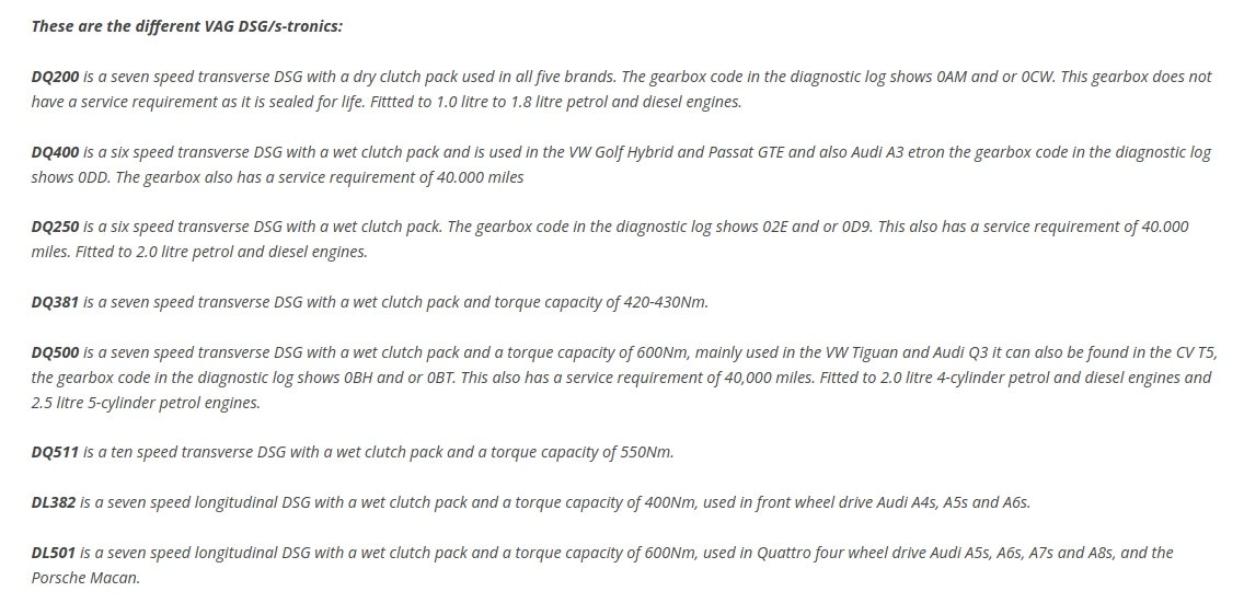

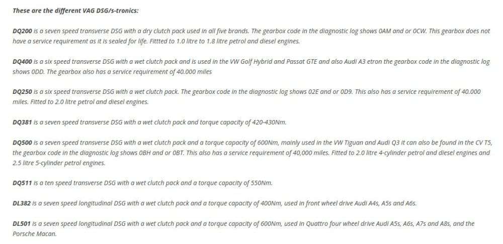

If you do go for the remap also look into a DSG remap.  As well as making the gear changes faster it also raises the torque limit in the DSG to take full advantage of the engine remap.  As standard I think the DSG is restricted to handling 400Nm.  I've also had this done on both cars with no issue.  Note: If getting this down the remapper needs a special cable to connect straight to the DSG controller.  It is not remapped through the ODBII port like the engine is.
No problem with the DSG handling the extra torque as VW use the same DSG in more powerful cars.
